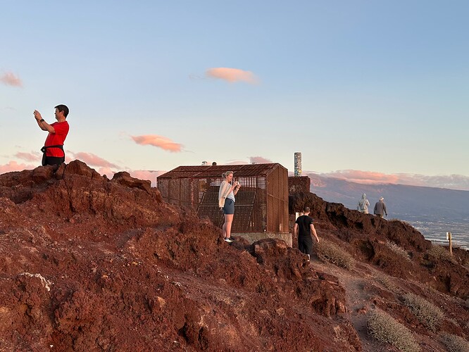

Not much to say on this one, basically posting in order to aid subsequent activators:
  1. TF-019 gets busy early,
  2. Not much room
I didn’t fancy my chances of slinging up a pole with so many people milling about, and had neglected to bring my JPC-12 vertical - not that you’d have gotten a spike into the ground anyway. Calling CQ on 2m with the ID-52 was fruitless, probably due to the early start.
Maybe with a bit of planning you could get some S2S contacts on VHF with TF-014, TF-010, or TF-016. Ascent is half an hour with very convenient parking close by, and, if all else fails the sunrise can be spectacular.
You missed a massive opportunity to show off, and to recruit some new people into amateur radio, especially SOTA. :grin:
Hehe, I like the optimism there Fraser. But I’m not a good ambassador for the hobby, not unless I really really try. And it was too early in the day for that, hehe.
Not to be a smartass, but the rocks act like insulators.
Simply extend the wire to the ground and call. Christian (hi Chris) F4WBN and Don (hi Don) G0RQL would certainly have answered you.
Hey Mark,
I hope you arrived back home safe and sound. I’m just waiting for check-in and want to give you my experience with this summit I just activated moments ago.
Your vertical antenna would have been the best solution. I used my compromised vertical (see Short loaded vertical antenna for restricted summits - #8 by HB9EAJ) and made 34 contacts, mostly on 10m and several S2S.
I put up my antenna at the same spot where the guy in the red shirt in your picture is taking a picture.
Some QRM on 15m and below, due to the solar panels in the cage, but 10m was fine.
73 Stephan

It’s a good point Christoph @DL1CR, I didn’t think of that. There were some steeps drop-off which should have been safe in terms of trip hazard, so I’ll consider it next time. I guess my only reservation would be that those volcanic rocks are super sharp and instantly abrade anything they touch - like my expensive camera backpack. Grrr…

Smart-ass mode on again:
Until now, I always found a solution with an earth spike, even on a rocky summit like this one, as one can see from my picture.
You just have to collect some loose stones and fit them around the spike. Quick 'n easy! If there are no loose stones, use your backpack (mine has already a lot of holes, hi).
73 Stephan
