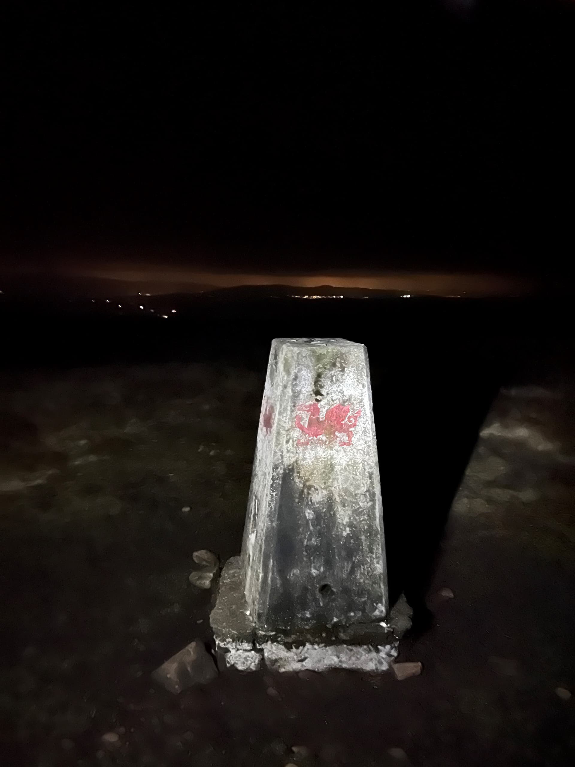

There is always plenty to talk about for me and Kev, so after a few different topics discussed and looking across at Pen y Fan watching a queue of head torches descending the summit in the distance, we were soon amongst the mist close to summiting Fan Fawr. Once we reached the top, our mission was to set up our office beside the actual trig stone which is in the AZ, to help anyone who wanted to work the trig as well as the summit:
Man, it’s one long walk to the trig stone from the actual mid point of the summit - it felt like ages until the stone was in view. We quickly had a summit selfie and then started work:

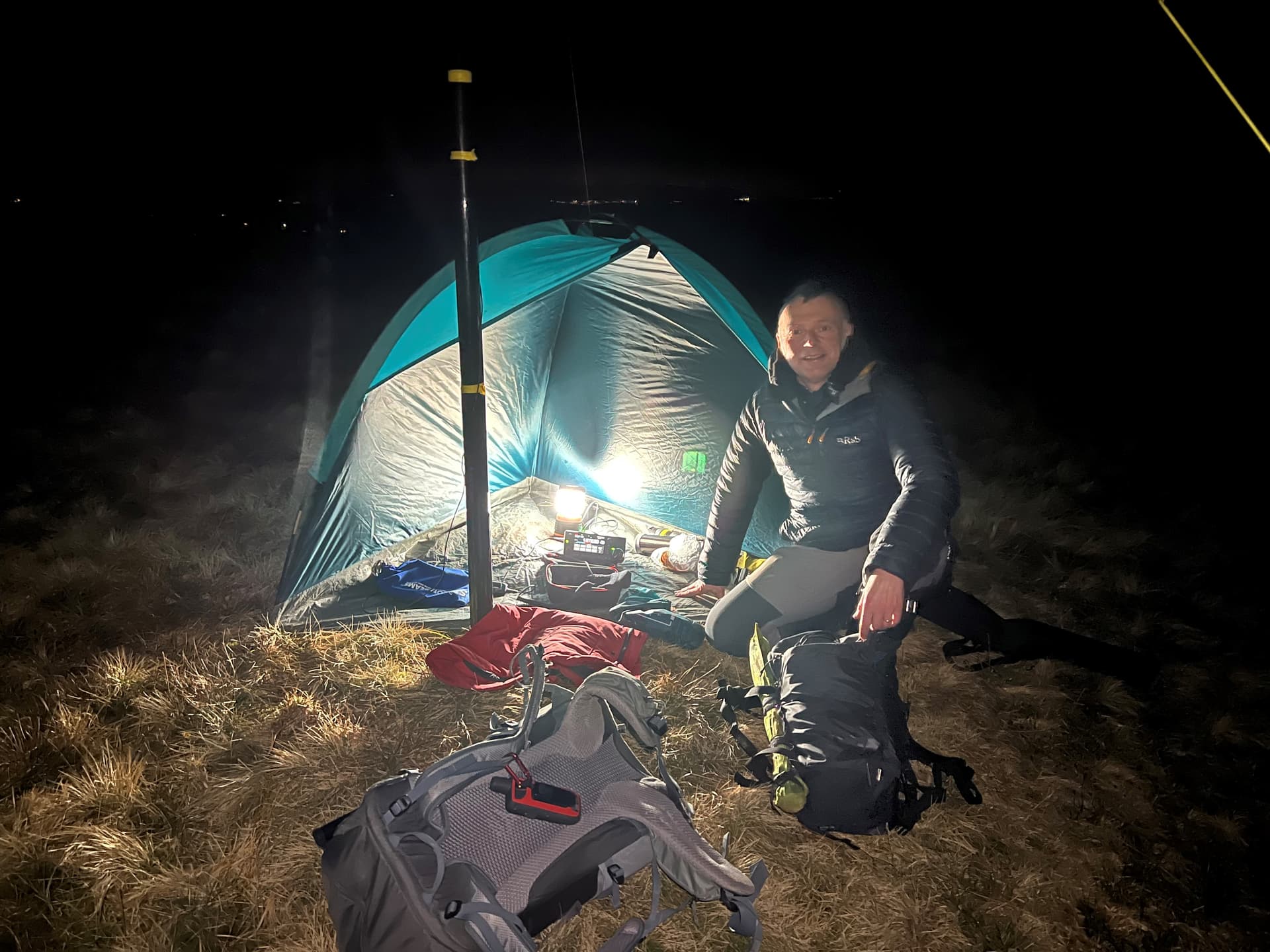

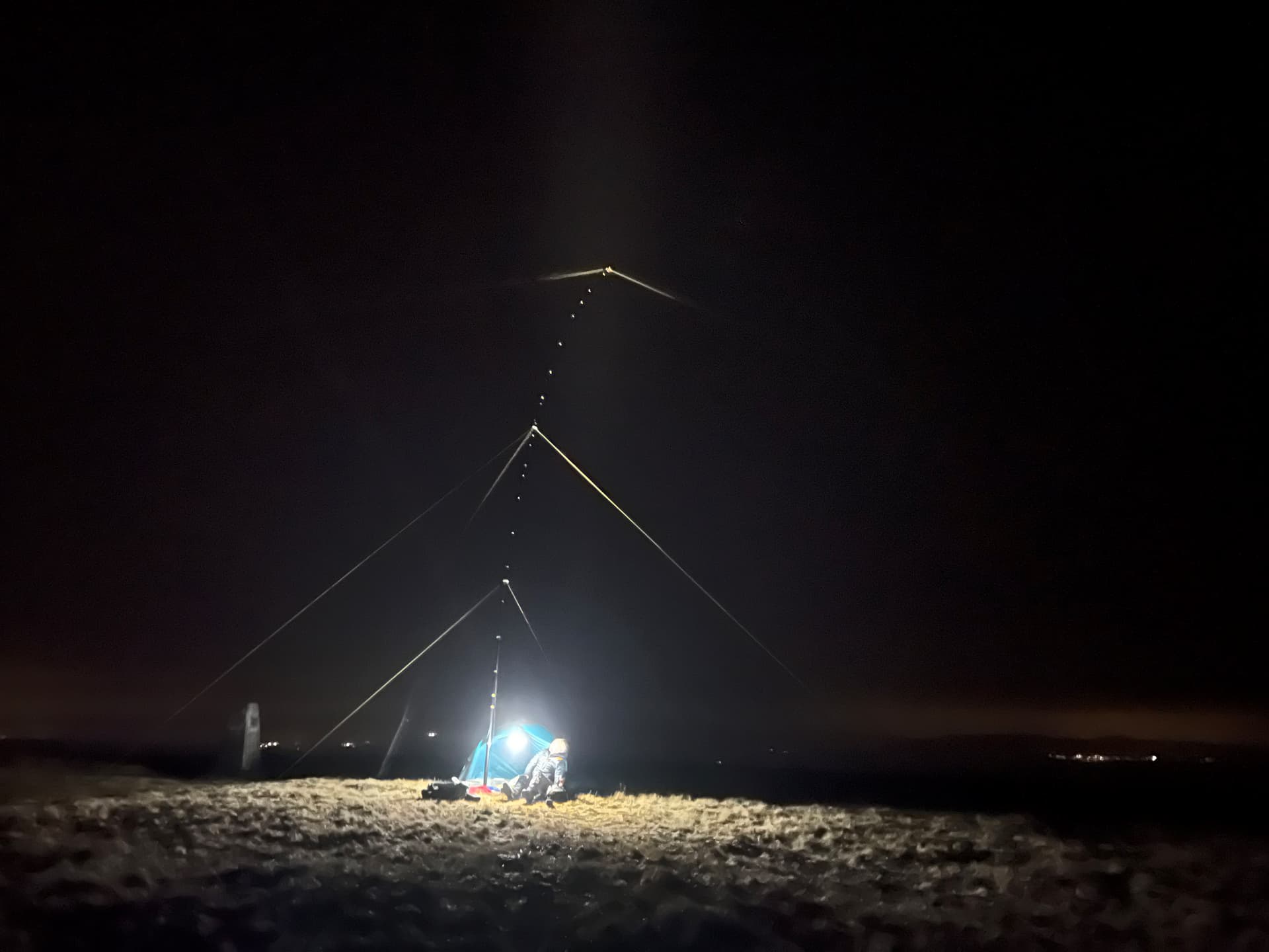

Kevin began by erecting his 10m spider beam beast of a pole while I gathered all the guys ready to tie it down. Once we had everything in order (it took longer than we thought) the 160m home-made dipole was released from its bag and the centre piece was mounted to the top of the 10m spider beam pole. We both hoisted the pole up in the air and guyed it down. It was another 40m walk for both of us to guy both dipole ends down using our walking poles:
Right, we were all set up and ready to try our new idea out :slight_smile: we used yellow wire for the antenna @GW4VPX Allan so the UFO’s could see it when flying past :rofl: (a home joke we have). The equipment used consisted of:

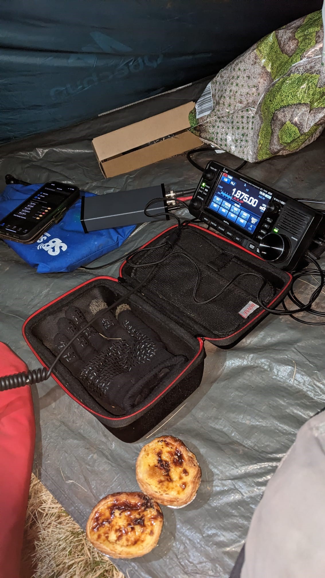

  • Icom IC-705 transceiver
  • MAT-705 external tuner
  • 13.8v battery enabling the 705 to push 10w
  • 10m Spider beam telescopic pole
  • Full sized 160m dipole (80m in total length)

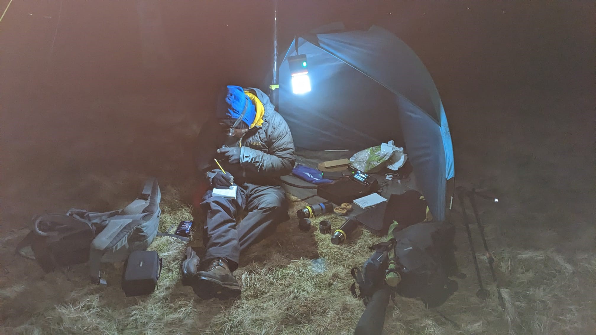

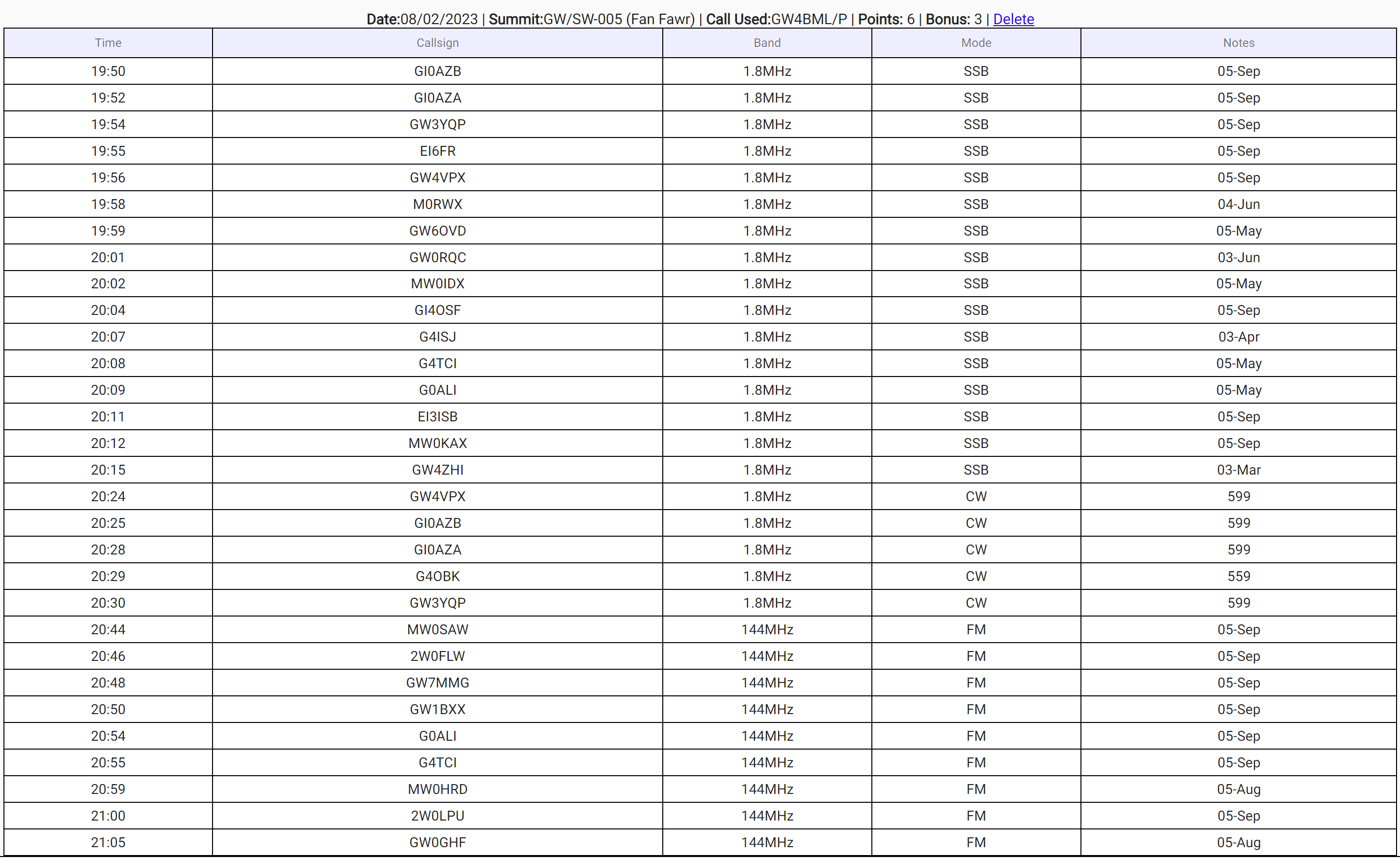

A spot was placed on the SOTAwatch website for the frequency we chose and a ‘CQ CQ CQ SOTA’ was called out… WOW, the antenna really worked with us having a nice pile-up on 160m entering 16 stations into our log. That wasn’t the response we were expecting, so thank you all very much for your support who called in :+1: we didn’t receive any S2S contacts which I thought was odd??? hahaaa. As you’ll see from the antenna images, we really had gone out in style on a mission to qualify this summit on 160m:

Kevin then joined me on 145-FM where we shared the microphone and worked a further 9 stations to end our fantastic evening!

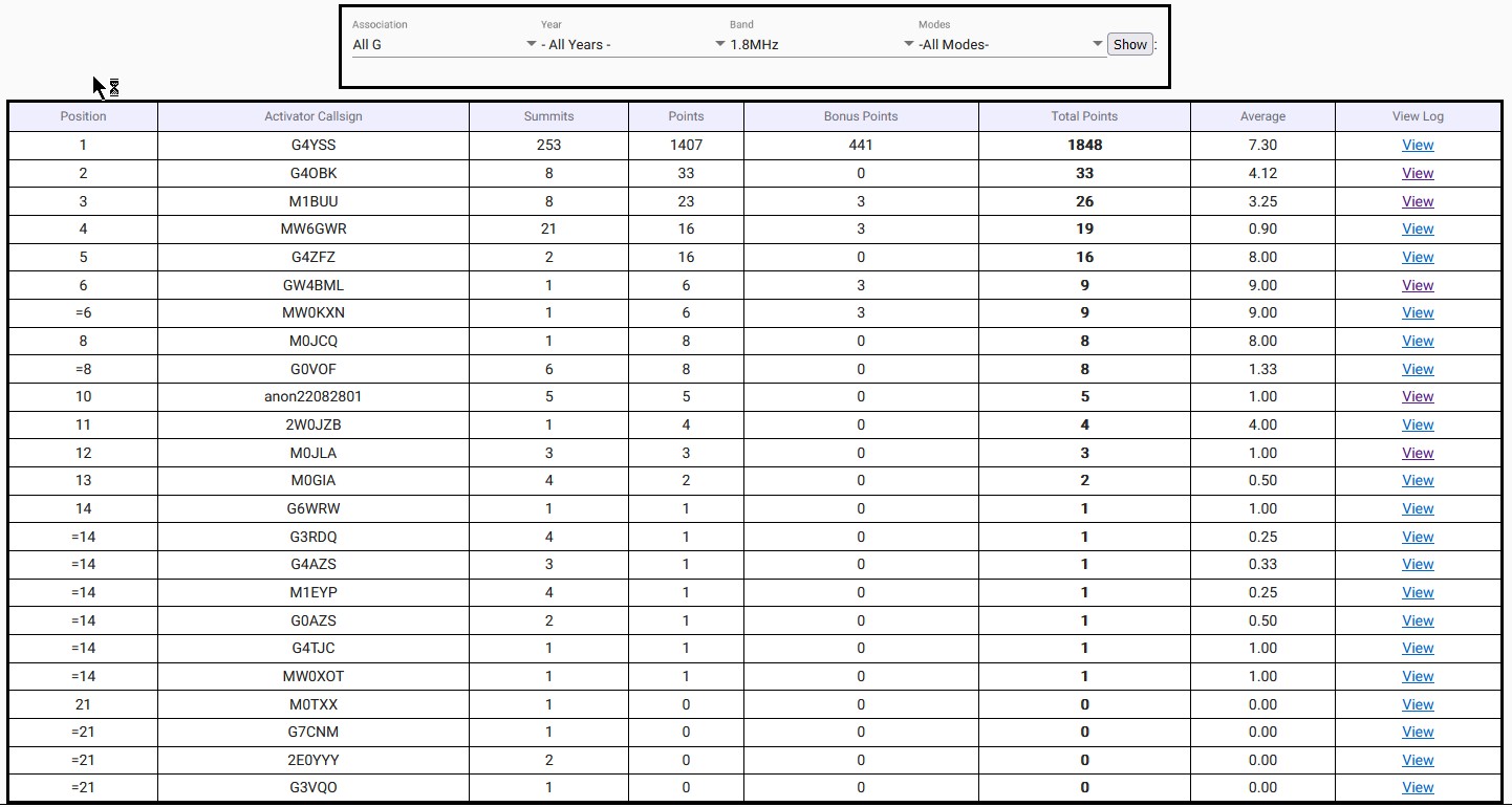

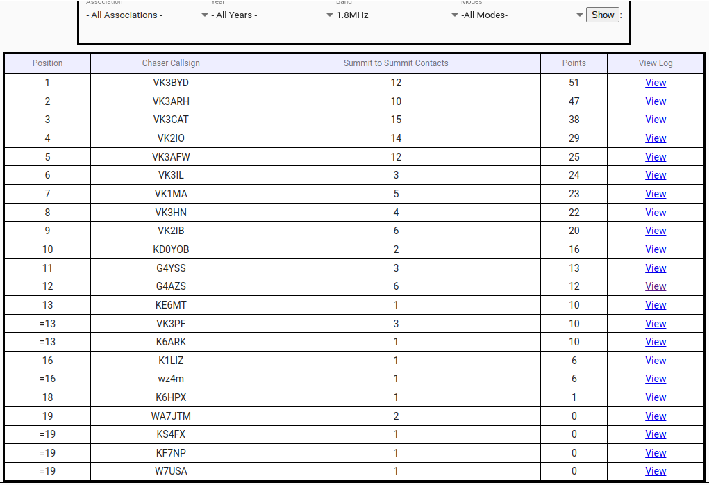

Yes, S2S quite rare on 160m - easier if pre-arranged skeds can be arranged. Any offers to list a few more? Adrian @g4azs is in the list, and of course John @g4yss.
Only 24 UK stations have activated a summit on 160m. Some are no longer doing SOTA:
73 Phil G4OBK
