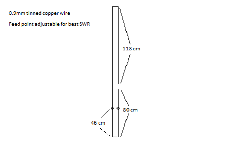

Next, looking if things can be improved further I’ve untaped the dipole and quickly taped in a traditional Slim Jim variant made of 0.9mm tinned copper wire. Due to indoor settings and some metal around and inside of the window frame traditional Slim Jim size had to be slightly reduced again. I’ve got SWR 1.5 and the repeater started to come solid S9 though!
While fine tuning the SWR I’ve messed up with wire size and had to take the Slim Jim down just to redo it again.
For experiment sake I’ve purposedly put my next version with much more length, planning to find where the best SWR resides within 100-150MHz range while cutting away and getting closer to a traditional Slim Jim sizing.

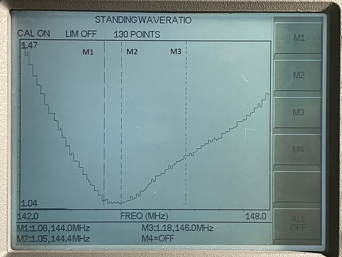

To my surprize, the best SWR for my indoor Slim Jim version has come to 1.0 at the below measurements. Well, I know a dummy load would show the same result, so next comes the testing.

Taping to a plastic window frame can change the velocity factor of both the radiator and the matching stub (but by different amounts). You will likely find that it varies with the spacing away from the plastic. Such issues have often been reported when J-poles (including Slim-JIM) are installed inside plastic water pipe for support.
At least, that’s what I would expect is the issue at first glance. If moving it 5cm away from the plastic changes the SWR curve significantly, that likely is what is happening.

Thanks Dale, I never thought about that. That adds on top of other surroundings: E-glass, some metal in the window perimeter, plastic … Well, all that makes any calculations fairly approximate in my case. I kind of expected that but when way off its formal size Slim Jim started to perform reasonably well I was at least surprised :slight_smile:

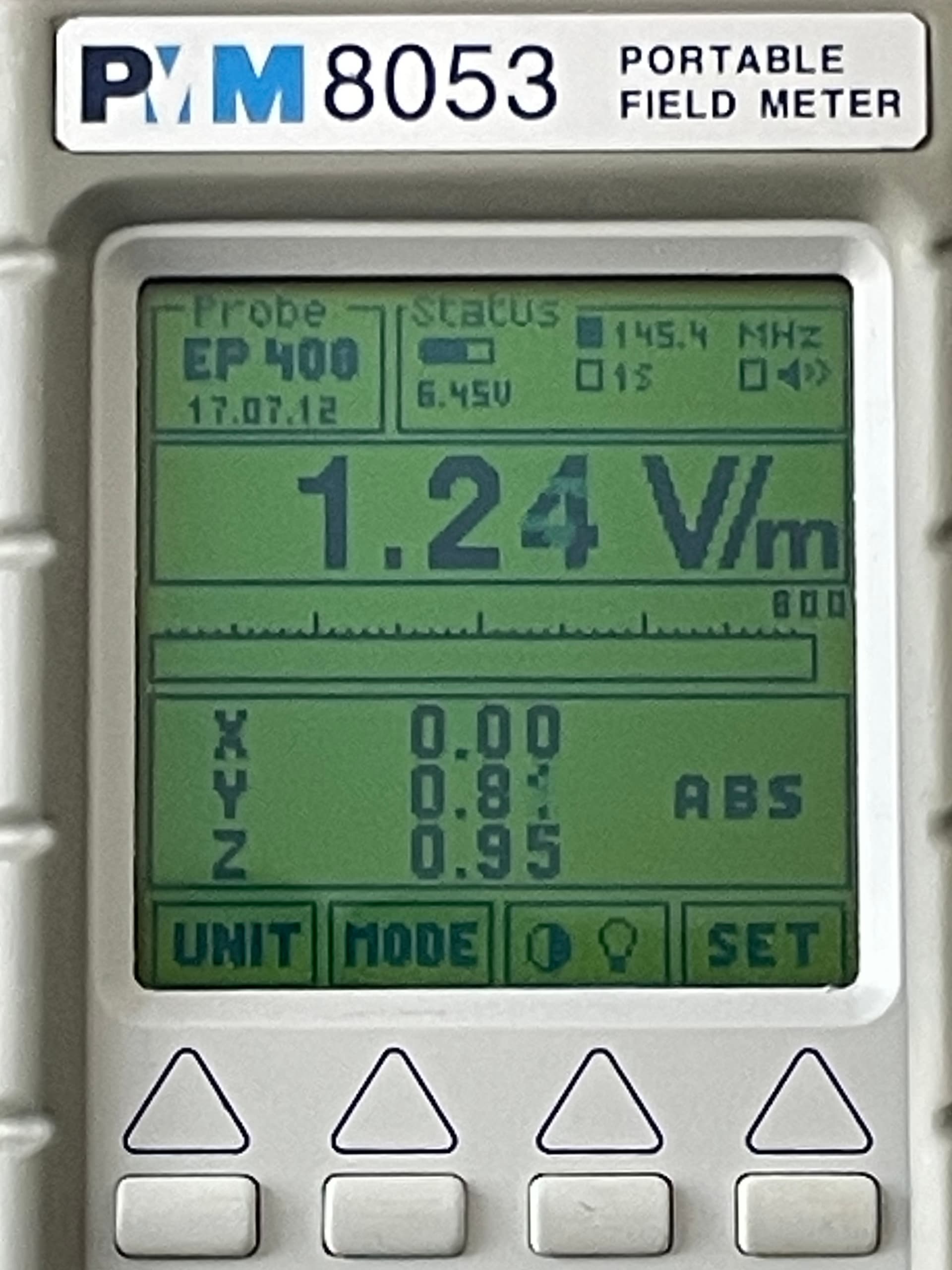

Besides, to control how well pixies work to help my TX, I’ve set the radio to 5W and a field strength meter 2.5m away. At 145.400 I’ve got 1.2 V/m, similar results I am getting with 5W HT and 1/4 telescopic at the same location. The results are in no doubt inconclusive, however give a general idea that my ‘Slim Jim’ can transmit too :slight_smile:
