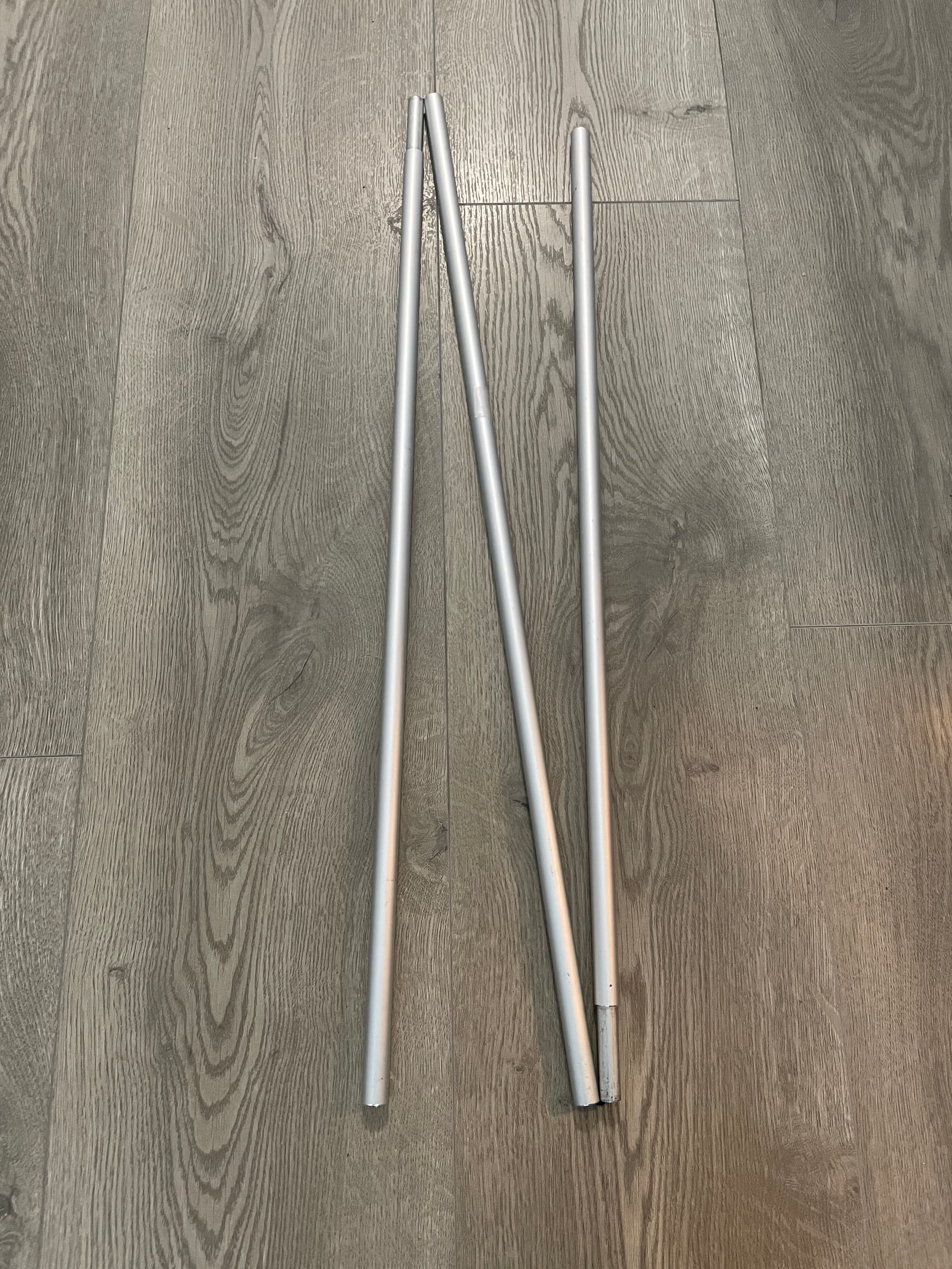

Over my several years of SOTA, where I routinely run a simple 3-el Yagi, I always wanted to try ‘a bigger boat’. A technical difficulty was to work around boom lenghts bigger than 1m, that must be easily collapsible and quickly assembled in a field, in any weather, preferably with no tools.
As no easily workable DIY options were coming to mind, I’ve abandoned the idea for a time. However, just recently I’ve came across an unused aluminium support for a portable banner stand. Having lenght of just over 2m and being 16mm in diameter it looked to be sturdy enough to hold some 4-5 elements no problem in a portable setup. The main advantage is that it is fully collapsible down to 0.8m and not falling apart.

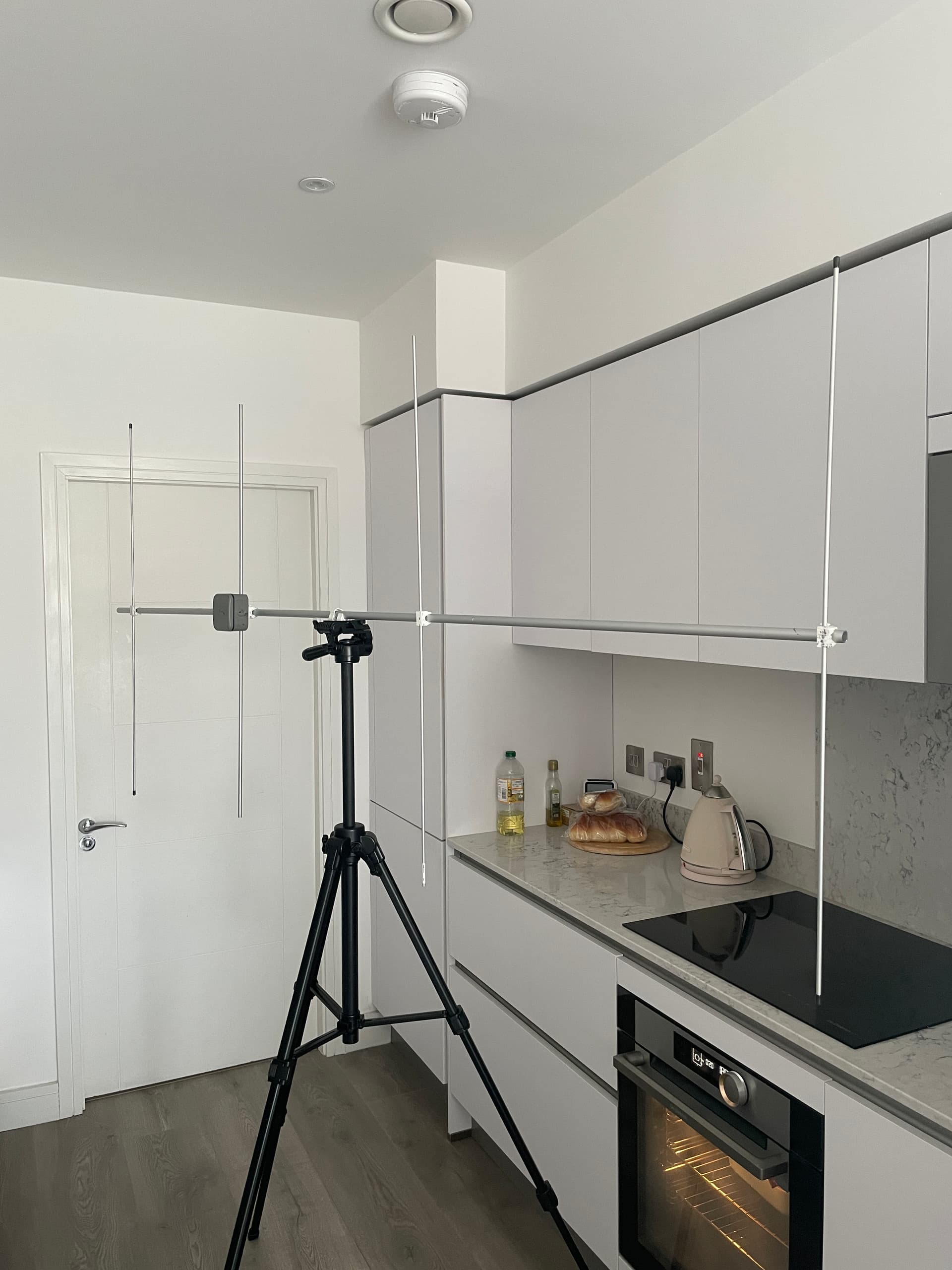

I’ve tried the ‘boom to be’ candidate at home, randomly fitting with 4x 1 meter elements and it looks to be holding well.
Not sure if those 4-5 elements makes noticeable difference from a 3-el beam though (1-3db perhaps?). I guess I’ll try it out anyway ![]()

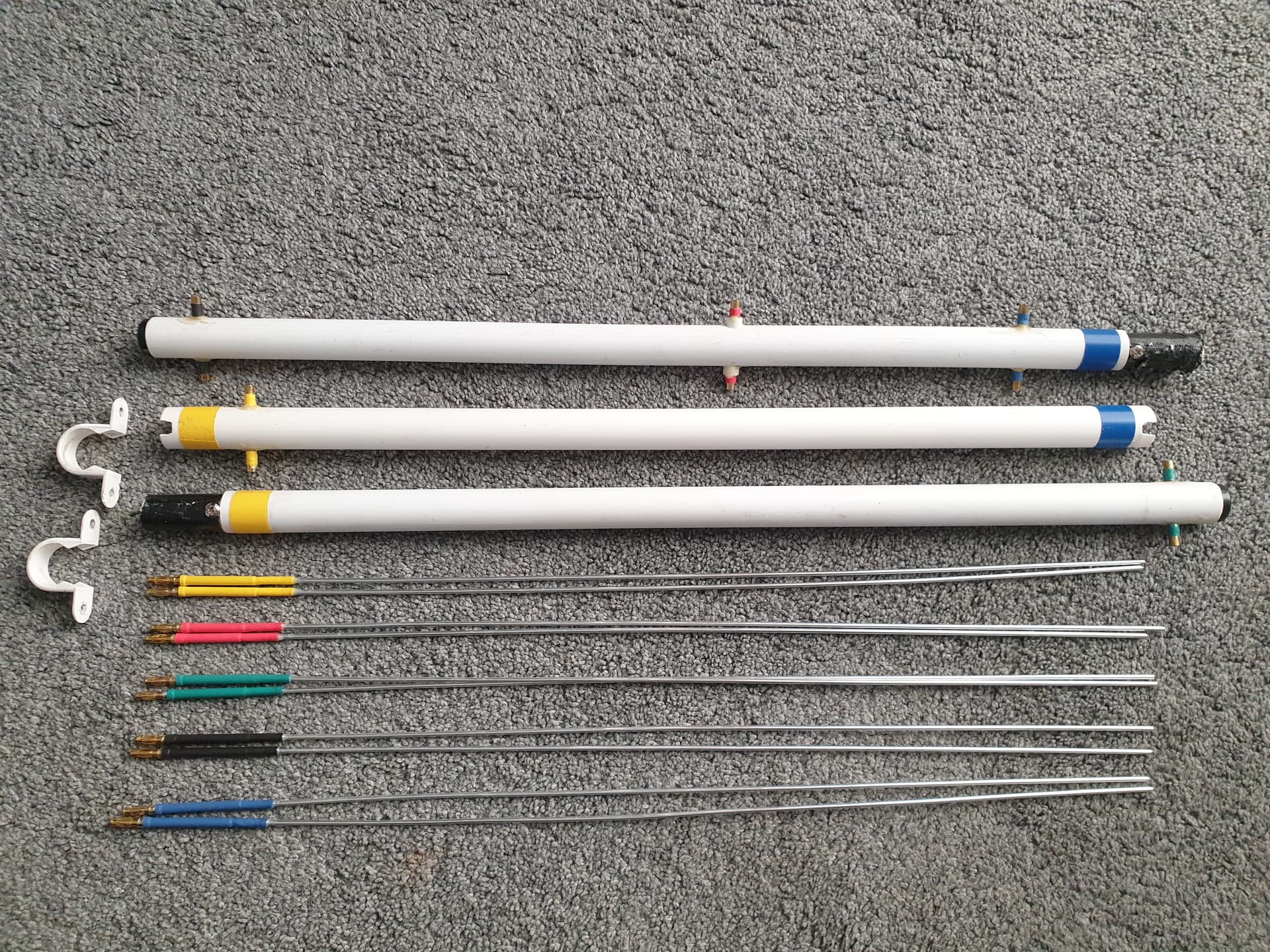

Since 2007 I’ve used a SOTAbeams SB5 antenna which has a plastic boom. I did consider using plumbing couplers to split the boom into sections, but the elements are conveniently stored and transported in the boom. I have designed a beam which has the elements split into two and the boom into three, but I’ve yet to complete the project.
That is an interesting solution, Gerald. Thanks for sharing. In case my ‘boom’ won’t work as I expect, I might start thinking about something similar. Although I tend not to split elements (my carrying bag allows 1m no probs)

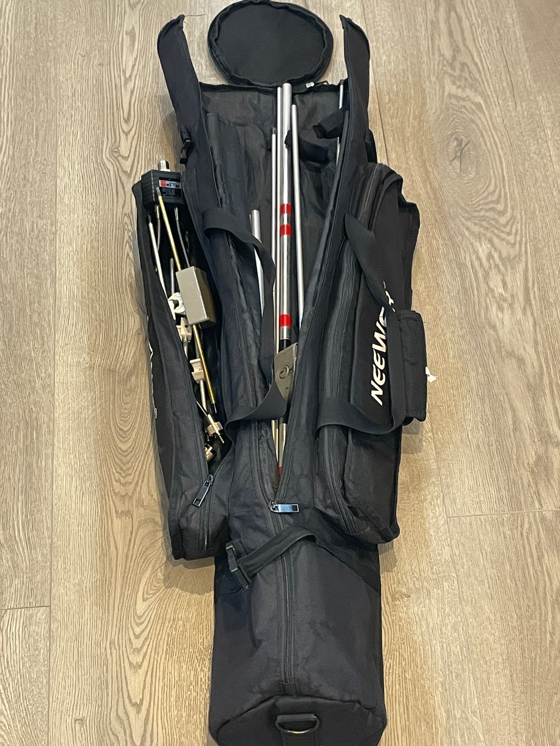

Could you could further develop this so the whole thing fits in to a quivver? That would be fantastic for trail running or hiking portable 2m/70cm operations. Just carry the lot on your running vest or on your hiking pack!
That is what I have. Inside are my old and ‘candidate’ booms, 3x VHF and 5x UHF elements, 6m of coax and a 2m/70cm diplexer for LEO satellite work (although not doing sats for a good while as terrestrial QSOs works out fairly well on the East Coast)

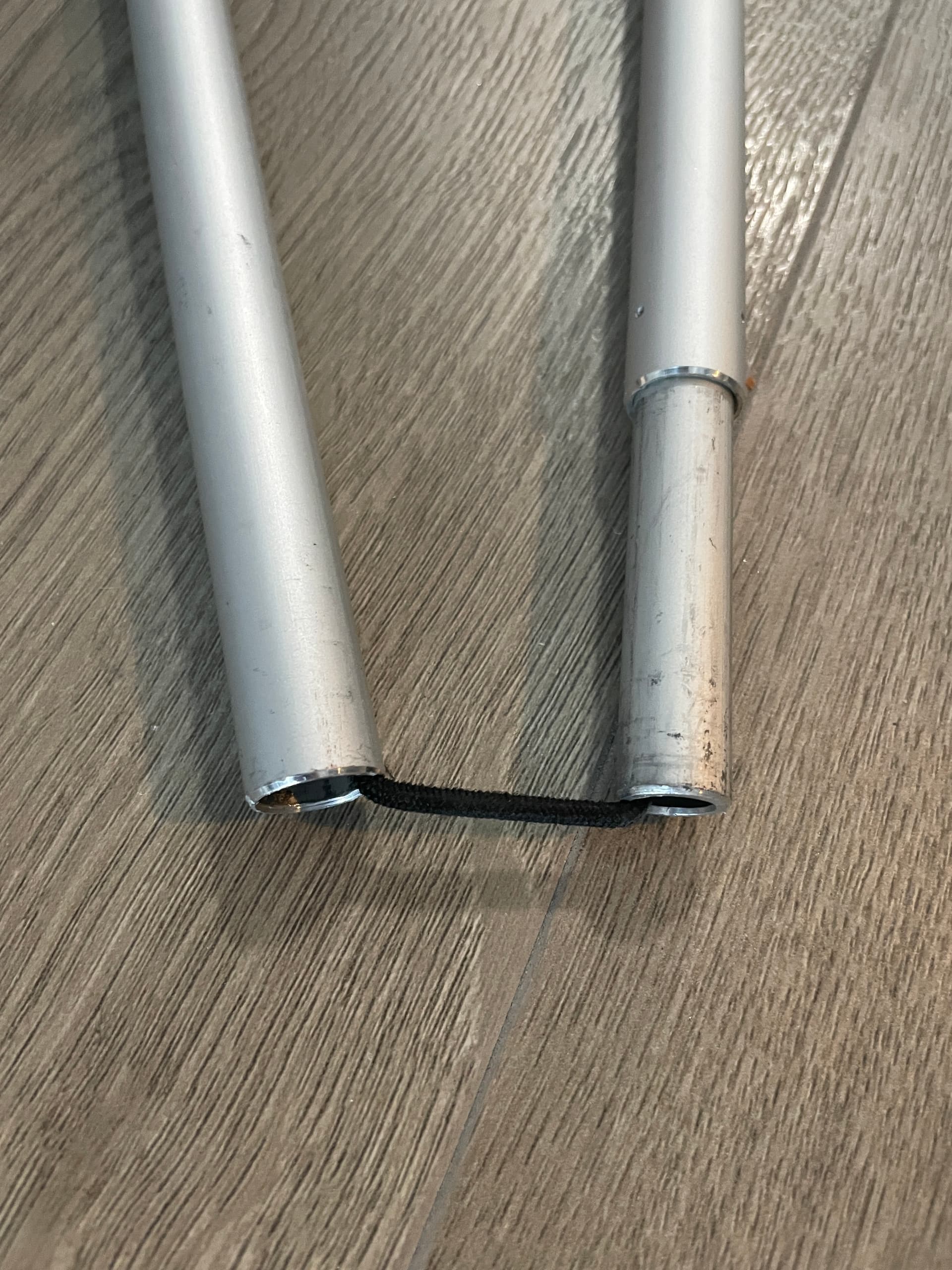

I actually started the antenna project for rocky summits (specifically to tackle GM/SS-010 after activating GM/SS-008) where having things hanging off the backpack can be a pain (experience on GM/SS-003). I must get it sorted before the weather goes down the pan. The boom joints are a bit rough because the smaller tube sections are not quite a snug fit with the inside of the larger tubes. They sit nice and tight with a bit of tape wrapped over, but as you can see if you zoom in to the photo, the tape wears and will need regularly maintaining.
I store the elements for my 70cm beam inside the boom (PVC conduit).

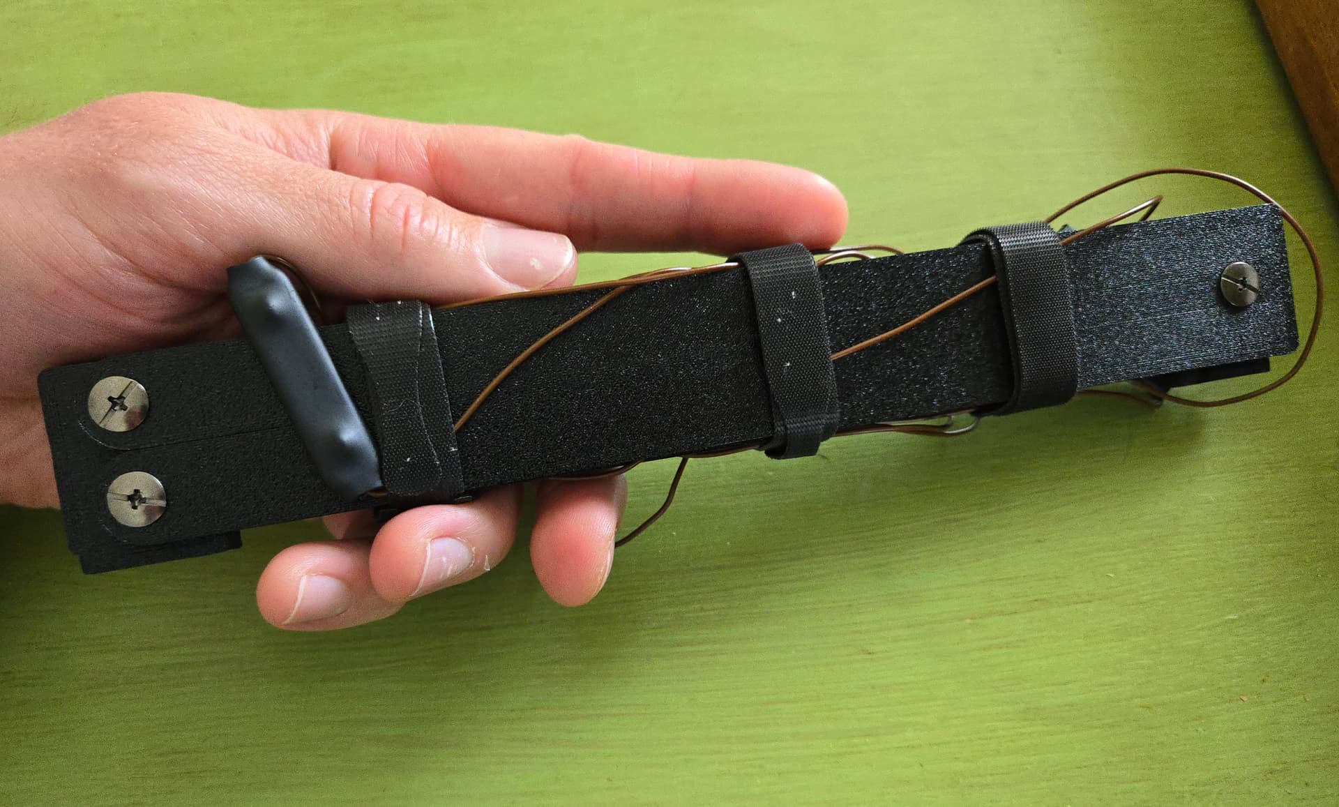

Not a yagi, but a folding 2m moxon. It has worked great for me. I like it because it is light and packs small when I go on multi day backpacking trips. Sure beats a stock antenna on an HT. There have been several cases where this antenna saved my butt by being able to get an APRS spot out.
Can be used vertical or horizontal as well.
