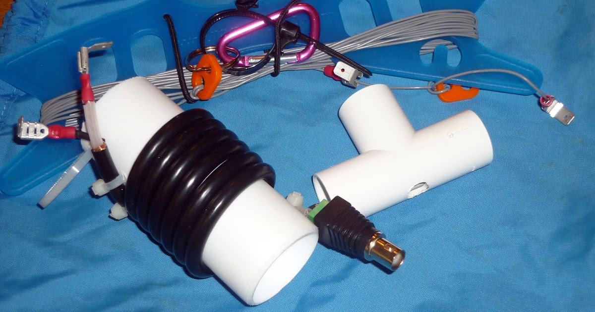

I started with a “flowerpot” antenna for 6 and then distilled the design down to this:
Glenn
VK3YY.
Another homebrew 6m coaxial vertical ‘flowerpot’ antenna for SOTA. Very easy to construct from a single length of RG58AU Mil Spec coax. Even better no mechanical joints to fail on a summit.
Using this antenna I worked ZL at 5 watts on SSB. See link to post
Cheers
Andrew VK1AD
