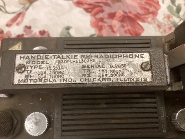

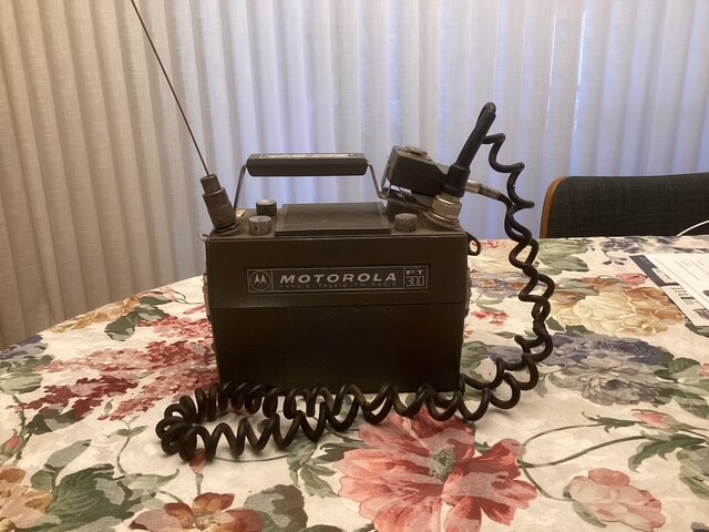

I have one in my vintage radio arsenal! Can confirm I bring it with me on a forklift when out portable.
Bulk aside, it is an outstanding HT in my personal experience. 1 entire Watt to play with, you won’t know yourself after that first QSO!
Works like an absolute stallion and sips quietly on a cocktail of AA batteries for aeons.
:face_blowing_a_kiss: :ok_hand:
And sometimes you know it is a Handie-Talkie because it says so right on the tin.
Weighs only 2.5 kg (without the 11 D-sized batteries that would power it for weeks).

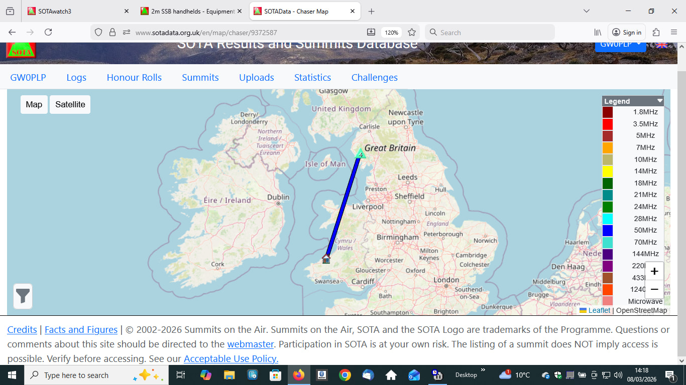

Yesterday morning I worked Matthew M0MZB/P on 144mhz CW who was on G/LD-029. Reports exchange, He sent 599 and I received 559. Distance was 167.9 miles or 270km. He was using a modified Quansheng H/Held with a board fitted he built himself. The signal & tone was loud and clear. We spoke later on 2mtr FM where he confirmed what radio he was using. I thought this was worth a mention on this subject, Well done Matthew.
2026-03-07 07:42 GW0PLP M0MZB/P G/LD-029 Illgill Head 144MHz CW 270
That is mega. So fun to see all this 2m CW activity! :smiling_face_with_three_hearts:
When I first moved to G/LD land about 8 years ago I couldn’t believe the first 2m S2S contact I had with GW/MW. 5/8 reports both ways with both of us using 5W FM and RH770 ½-wave whips. He sounded like he was local. VHF radio was made for mountain to mountain dx contacts especially with some of the RF path over the sea.
Thanks. Gives me some hope, but I’m guessing there must have been some ducting or aircraft enhancement going on. Looking at the path to my QTH (which is about 25 miles further, so would likely have been more difficult) it seems there’s an obstacle of about 2kms of rock in the way (once surface curvature is taken into account).
Right. For G/LD I’d get very little of that from my QTH.
You probably need to be west of Caeliber Isaf GW/MW-031 and preferably up a hill. Looking at my 2020 QSO with GW4TQE/P the direct RF path to there from Loughrigg Fell G/LD-047 manages to spend almost half its length over the Irish Sea just west of Blackpool Tower.

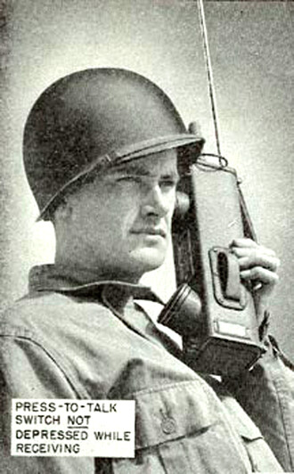

This is a handheld: SCR-536 - Wikipedia
And this is a handheld: AN/PRC-6 - Wikipedia
These are the earliest. Note the similarity to today’s handheld radios and the massive dis-similarity to an 817/818. In fact my KX2 is a handheld… it has in internal battery, internal mic, internal speaker and with its AX2 antenna can be held in one hand and used as such. Ideal for 10m repeater working :wink:

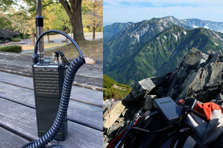

Hallow 2m sideband freaks in UK. I’m not interest in the Challenges, but 2m outdoor QRP has been one of my favorites and IC-202/FT-290mkII are my collections. However, they are too large to be called HTs. Mizuho MX-2 series are only HT equips mentioned so far. Here, you can see another solution in Japanese market.
The left photo is my LS-202 by Belcom which covers 144-146 MHz SSB/FM with PLL and VXO using a thumbwheel switch. Output power is 1-3W depending on DCV and your talk power. The weight is 0.5kg with UM-3 x6 butteries. Now this is far rare even in Japan.
The only 2m SSB HT on the market shelf is NTS-220 by Nishi Musen in Kobe Japan.
The right photo is same shaped my NTS-620 for 6mSSB in Japanese Alps.
The weight is less than 300g including UM-3 x4 butteries and 1W output.
http://www.nishimusen.co.jp/nts220/nts220.htm
NTS-220 covers full JA 2mBand(144-146MHz) with PLL circuit controlled by buttons.
The former models NTS-200 and NTS-210 are controlled by a thumbwheel switch like LS-202.
Since career suppression and sideband suppression are important factors for SSB transmission, DSB or transmission by Quansheng is not the solution of the SSB-QSO.
73, JI1TLL, Jun
