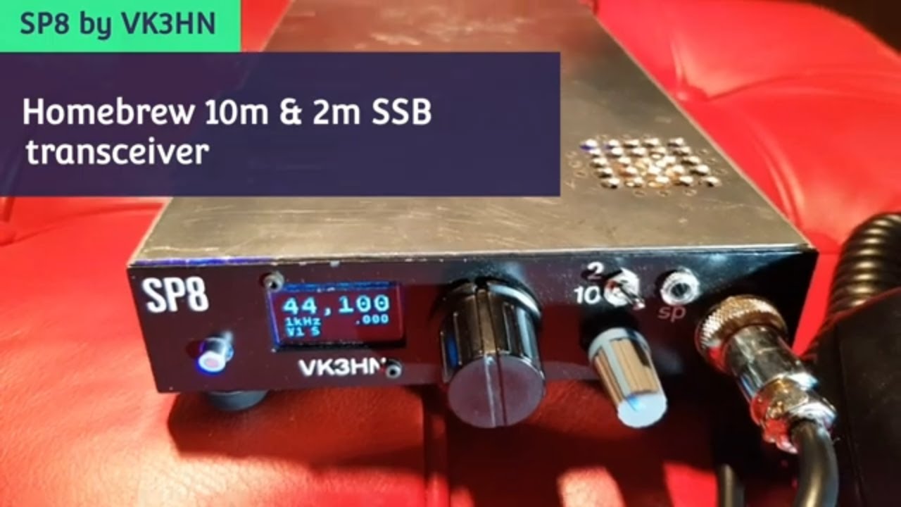

A lot of SOTA operators are using homemade hf equipment. Is there any 2m or 2m/70cm homebrew station?
Its not hand held. But its a homebrew 28MHz SSB transceiver with Ukrainian transverter in the box. So it does both bands 10m and 2m. Had some good 2m SSB contacts and activations during the infamous Covid lockdown period late 2020.
Works fine. I like the compressed audio sound as the AGC reigns in all the receiver gain. 2m SSB is a brilliant portable band. Ive never tried 2m CW but I reckon I would struggle to get 4 chasers.
