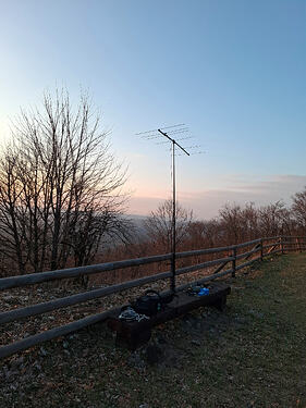

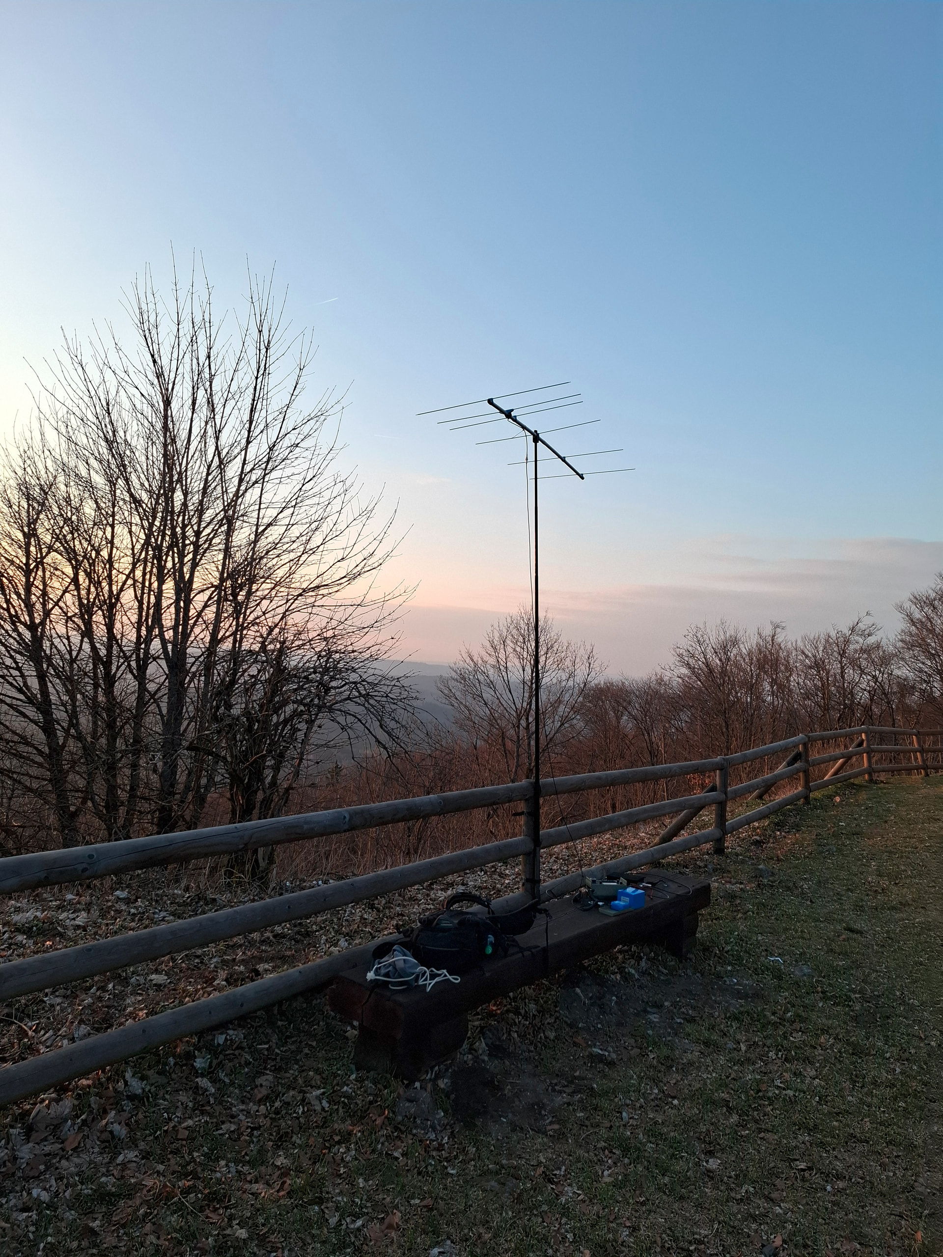

I checked the propagation again in the parking lot and, because of the high K and A values, decided to take 2m equipment only. I packed the 6-element DK7ZB Yagi that I built, using parts kindly printed for me by Michael @OE5HKT, which he had designed. Finally, I decided to carry the PA that I had recently bought as well. I arrived on OK/PL-022 at around 16z, later than I would usually activate on a Sunday.
The activation started off well with two S2S QSOs, one with Richard @OE5FFE and one with Reinhard @OE5EDR. Then I called on 2m SSB and had an amazing 2m S2S with Mathias @DH1WM over 372 km! Some time passed, and since I wasn’t in a hurry, I stayed on 2m SSB longer than I usually would, running the CQ loop on the IC-705 and enjoying the view.

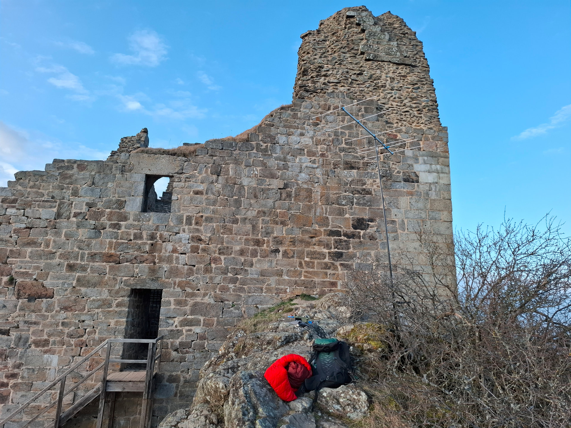

But then, suddenly, Mathias texted me: “Aurora on 2m!” I instantly switched to CW and noticed a few signals in the spectrum - but no aurora sounds. These were local stations, all calling “CQ A”. The problem became clear: There’s a castle on the summit. I had set up in a spot with great takeoff to the west, south, and east, but the castle blocked the northern direction.

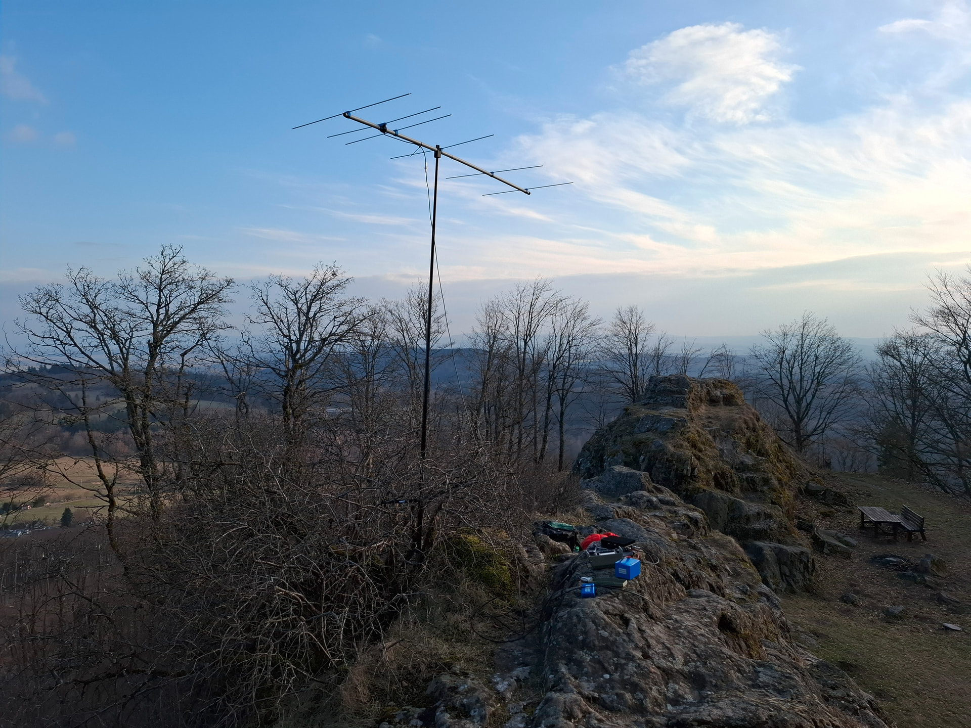

I changed my position as quickly as possible. I was now blocked toward the east but had a clear path to the north, and in fact, heard the first aurora signals. I found Ken OZ1HDF on the bands. He had been my first aurora QSO back in January from the university club station DK0PT, and I got him in the log quickly. This was already an amazing success: A 2m Aurora QSO from a SOTA summit!

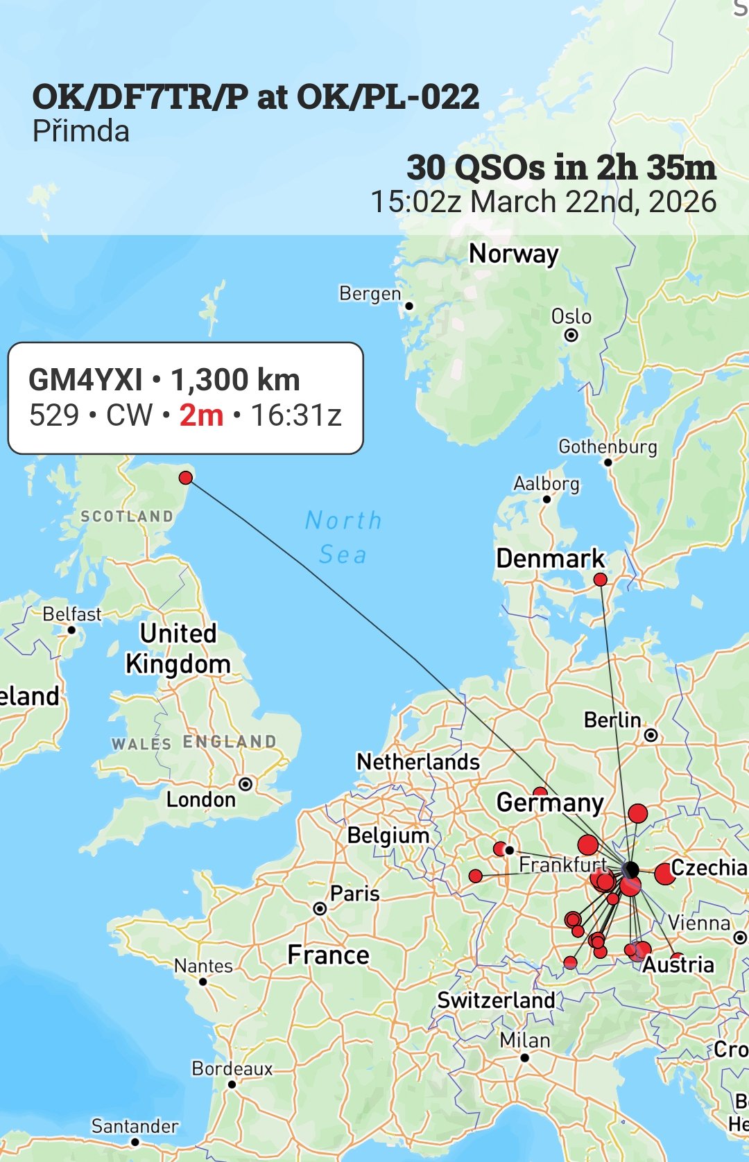

I was then scanning the band for another signal and heard Keith GM4YXI! I had nothing to lose, so I called—even though I wasn’t expecting a response. OK/DF7TR/P isn’t the easiest callsign for such QSOs anyway. But to my surprise, he replied with “OK/?/P”. Two very exciting minutes followed. I had to repeat my callsign several times, but he finally got it right! The report was 52A both ways. Check out the SoundCloud link to enjoy the aurora sounds I received during the final part of the QSO! ![]()
Just two minutes after this QSO, the signals vanished. I heard very faint aurora signals from SM and OH, but no further QSOs were possible. I was extremely lucky to be on the summit during that short time window, equipped with the Yagi and amplifier. I am also very thankful to Mathias for letting me know about the aurora, which allowed me to change my location quickly and get a clear takeoff toward the north. I think I owe Mathias a drink if we will meet in person some day ![]()
