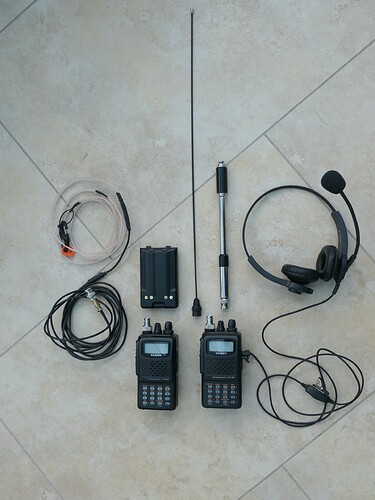

I use a Yaesu FT60 with a roll up Slim Jim on a sotabeams 6m mast, light & easy to pack, its not failed me yet, although on wendover woods & Win Green it came close, but they are not very high & surrounded by a lot of flat countryside.
If your going to go to the trouble of carrying the extra weight of the FT817 you may as well take an end fed or a dipole for HF in case 2m is quiet.
Have fun.
