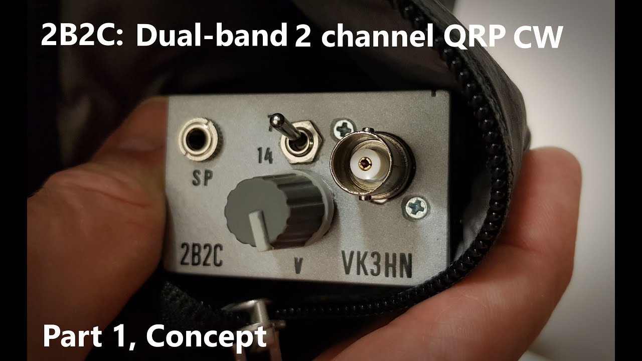

2B2C design
The next day I received his long explanatory letter.
Paul is keen on building homebrew rigs.
He activated this Sota using a rig he baptized as 2B2C, why?
Because it’s a analogue CW transceiver, direct conversion receiver, crystal locked (both rx and tx), running on 7023 and 14060. Therefore 2-bands & 2-channels.
His antenna was 20m EFHW (matching unit at the base) mounted vertically (helical) on a guyed 6.3m collapsible flag pole.
He confirmed it was a 4 - 5w rig, so we did a 2 x QRP qso.
By looking at a picture of his tiny rig I was even more astonished we did our QSO:
Paul has build a number of rigs, you can watch info in QRZ.com
The 2B2C rig is interesting, Paul compared many rigs and selected the modules from several of them building his own combination. We could see it as an improved 2 bands Pixie, with improved receiver and more output power.
I encourage you to see a deeper description on his blog, here:
You can also see details on his YT channel. I am impressed with the clear explanation he provides, and the quality of his editing, not a boring video at all. Really a great contribution.

Two other comments. My homebrew rig uses a fixed xtal oscillator on 14060, which explains why it was not spot-on a kHz marker. It has no VXO so it is wherever it comes up. Second, I use it with either 3S or 4S LiPo packs – on a 4S pack (15V) it delivers close to 5 watts on 20m, but on this occasion I used a tiny 1.8AH 3S pack, so on 11V the rig would have been delivering only 3 to 3.5 watts.

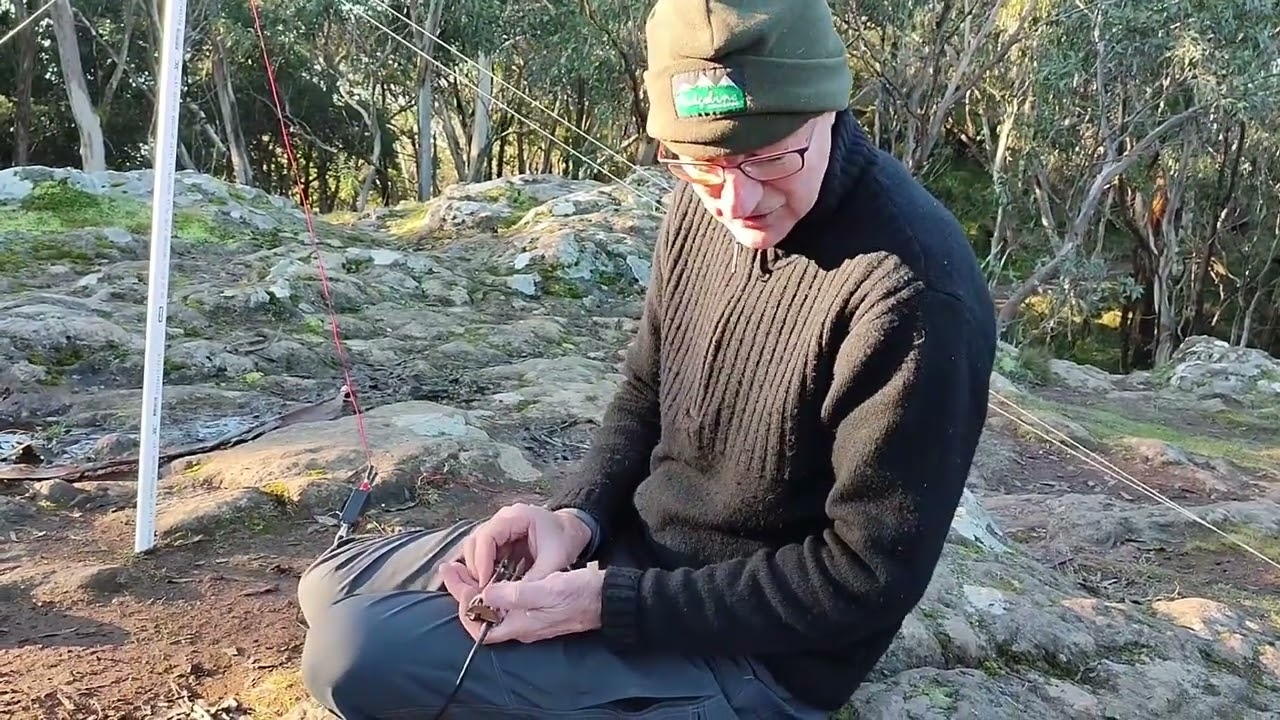

I’ve edited a short video of the EA2BD and EA4R QSOs from VK3/ VC-040, with video from both ends. Ignatio EA2BD is almost impossible to hear on my radios tiny speaker but i assure you, he’s there.
73 Paul VK3HN.
Ignacio, Paul,
I was with Paul on Camels Hump and am the one taking the video. We had a great activation on the close to ideal summit - enough trees to support antennas and a clear centre to spread out our gear. I used my mcHF on 40m but we had to alternate as we interfered with each other.
Paul’s homebrew 2B2C is most impressive - it really is small! Yet it proved itself capable of very good performance. It’s all analog so doesn’t even have a keyer, Paul was hand sending using one contact of his Iambic paddle. It was a pity the phone microphone didn’t pick up the Dx signals well from my position.
Photo shows a wider view of the setup. Options for guying the antenna were limited on the rocky mountaintop, but it worked!
73 David VK3KR
