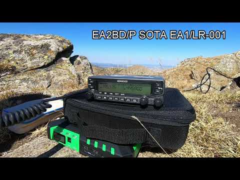

P.s. results from last year here, as well as a video report:

That made the activation a joy. I worked 60 stations that morning from EA1/LR-001 and logged about 17 S2S, incredible for being VHF!
