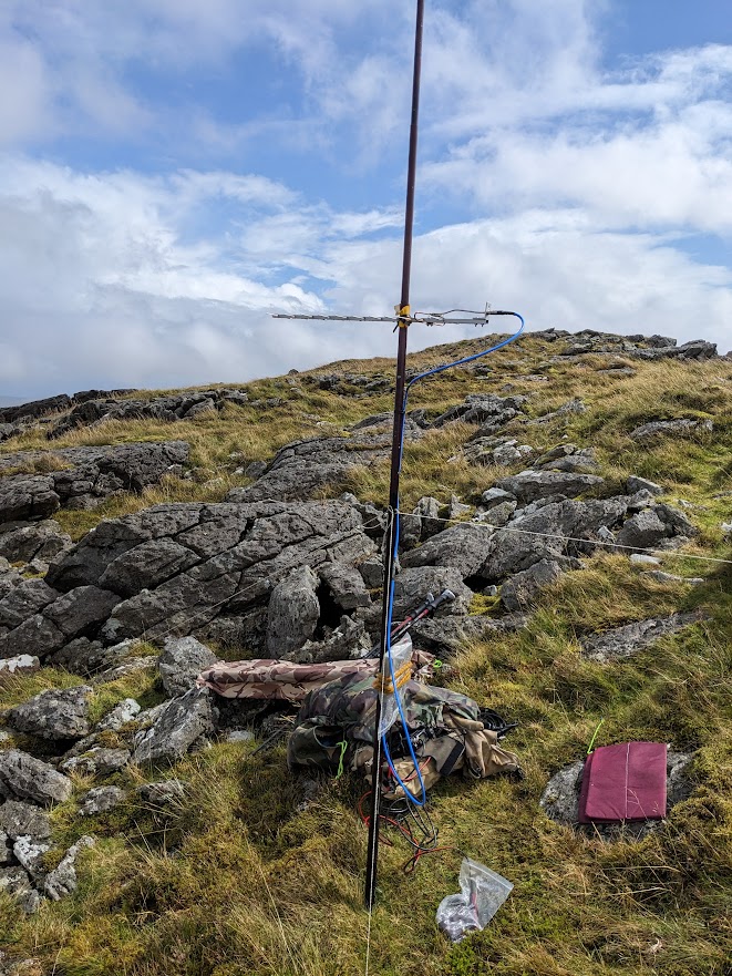

I activated GW/MW-027 during the last event and managed 14 contacts with a modest setup.

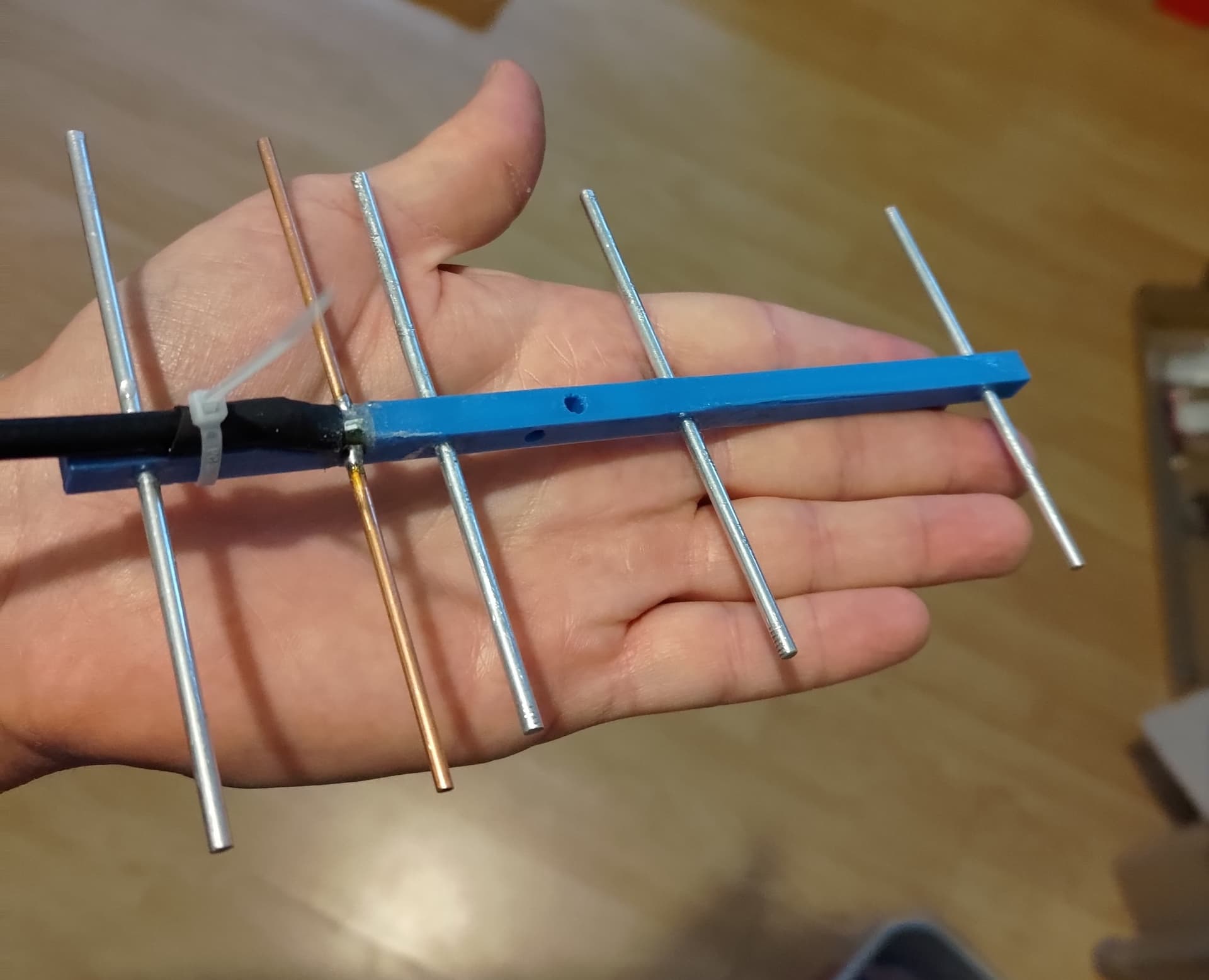

The 5 element beam antenna that I use: DG7YBN - YBN 23-5m and the 3D printed boom: DG7YBN 5el Yagi antenna for 23cm (1296 MHz) by swf - Thingiverse

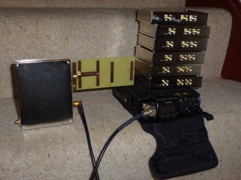

If the transverter is still supplied with a small PC board antenna, that is surprisingly effective. I’ve had lots of contacts with it mounted directly on the transverter, just sitting on a trig point - so it can be quick to deploy once it arrives :crossed_fingers:
I got mine a few months ago and it came with the PCB antenna.
I used it last weekend with the transverter plugged into my FT3D like a giant HT for a quick S2S with @G1JKS.
Yes indeed, during recent tests, we found that it was slightly better than the WA5VJB 3-ele PCB yagi (which claims a gain of “6-7dBi”).
I can also vouch for it’s effectiveness. As an experiment, I rigged the SG transceiver barefoot and the PC board Yagi on my 10metre mast during the 23cm Ukac. Furthest contact was Pete G4CLA 168km, that’s with my QTH at 34metres ASL. I’m sure that Pete has a super station, but still not bad. Simon G7WKX/P 44km away on G/TW-004, was 59 both ways.

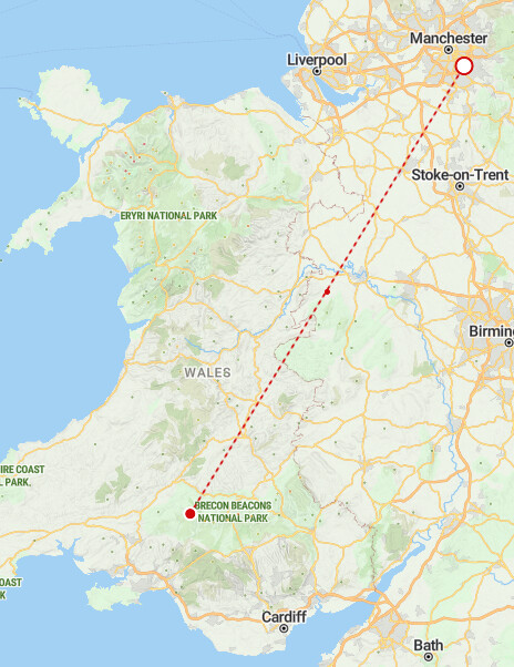

I nearly broke the 200km mark on the band from the Brecon Beacons a couple of weekends ago, so all sorts are possible with even a modest setup:

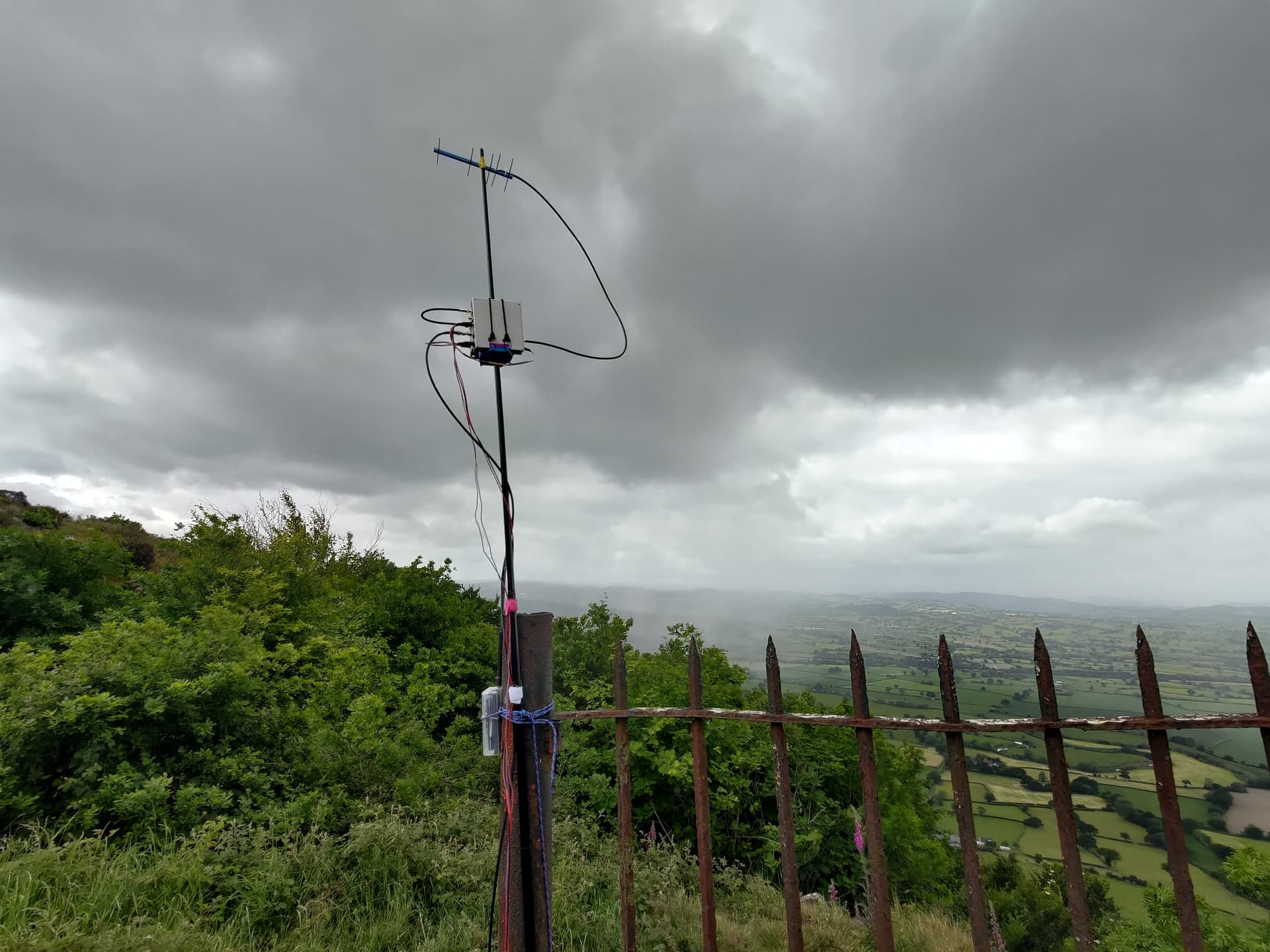

They can be a bit like buses. You wait for one and seven come along at once. These are the 13cm version.
