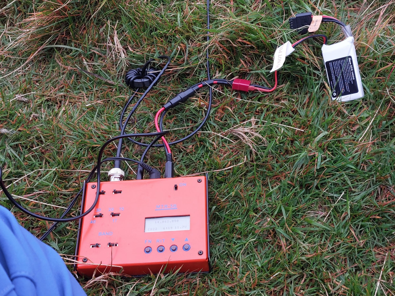

It wasn’t a serious activation on my part, I’d taken along my 7MHz EFHW and home soldered MTR-5B (about 4 watts out). Without much of a plan beyond ‘there might be some DX to be had’, I started on 20m. It was thrilling to catch the " 'K1DA" coming back to my CQ call and my mind was already adding the unheard ‘V’.
Once I’d locked in, it was a genuine solid copy, probably one of the most stable signals I’ve ever experienced from VK.
73, and thanks for the call!
Colin
