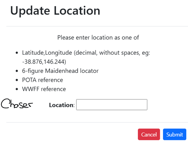

You need the location of the chaser. This should be logged as part of the QSO exchange

The location in this screen shot is not me but the chaser - thanks.

but in any case, I’ve updated the dialog to make it explicit.

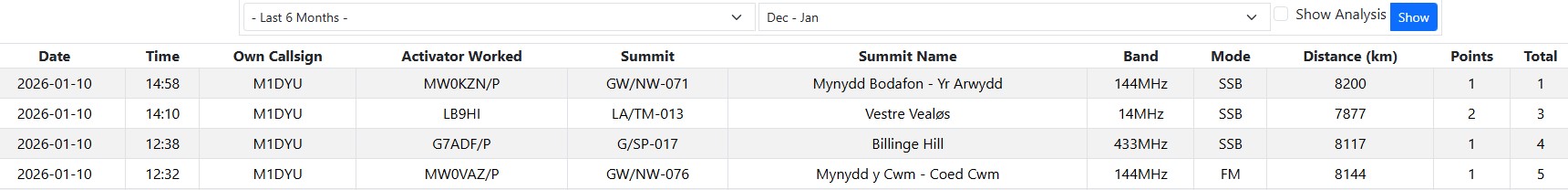

My first outing of the year to the extremely challenging G/SP-017. The idea was to try out my new 23cm transverter but some idiot left the coax on the kitchen table and whilst I could have cobbled something together with the 5m of RG58 and some adapters, it didnt seem worth the effort with all the losses. And its not like I won’t be up there again.
FT-817 for all contacts except for 23cm which used the Alinco handie and pcb antenna.
So that left me more time to play on 2m and 70cm ssb. For 2m 5W into a 3element beam at around 10 ft horizontal polarised. Good start with an immediate response to spot and call at around 80km (feels further when its a different big grid square (IO83 to IO82)) but then ghost town. So I had a play on 23cm FM (Alinco) for a short while with 3 qso before going back to 2m SSB.
A good 240km qso followed into Hertfordshire followed by a steady stream of relatively local. Most of these were vertically polarised , but I’m coming to the conclusion that for less than 50 or 60 km it doesnt make that much difference with mostly 59 reports. 4 Qsos in this batch.
For 70cm SSB used an odd slim jim style antenna picked up at a rally for £5 which is so light it can be selotaped onto the fishing pole. On a recent windy 433 alive session it was the star of the day when the beam couldnt be put up. Worked well on 70SSB (Vertical) too. No major dx, but with 3 70cm ssb qso’s in the bag and it being easy to setup and take down, its going in the bag everytime from now on. Good to hear 70cm SSB signals and didnt think it was worth the qsy from 432.200
In the middle of the 70cm ssb qso, I quickly switched to 2m for a STS with MW0VAZ on GW/NW-076, and whilst the 817 complained a little and backed off the power, a good qso was made.
A late flurry on 70cm FM and 4 more in the log rounded off an excelent couple of hours on the cold but sunny Billinge Hill. I’ve had worse weather days in the middle of summer.

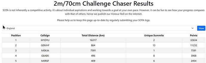

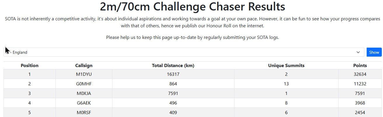

Something not quite right here:
Lat/Long translated in their user profile. I’ve gone through and updated the relevant entries.
Here’s another one:
Thanks for the QSO. So with our weak signals yesterday SSB won!
This challenge sure seems to be shaking a few of those out of the woodwork. :wink:
Just checked mine, and updated it slightly, because values to 2 decimal places didn’t really look quite good enough…
At UK latitudes, 2 decimal places is 1.11km N/S and about 650m E/W. 3 places is thus 111m N/S and 65m E/W which is good enough for 2 and 70. Maybe not for 76GHz and up.
