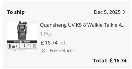

And if you don’t have a capable rig, you don’t need to spend a bunch of money on a discontinued FT817/857, IC7000, 706 Mk2, or transverter. The lowly $25 Quansheng UV-K5 can do it, and it’s good enough to have some fun and score points.
Adam
K6ARK
Adam,
I’ve just taken delivery
