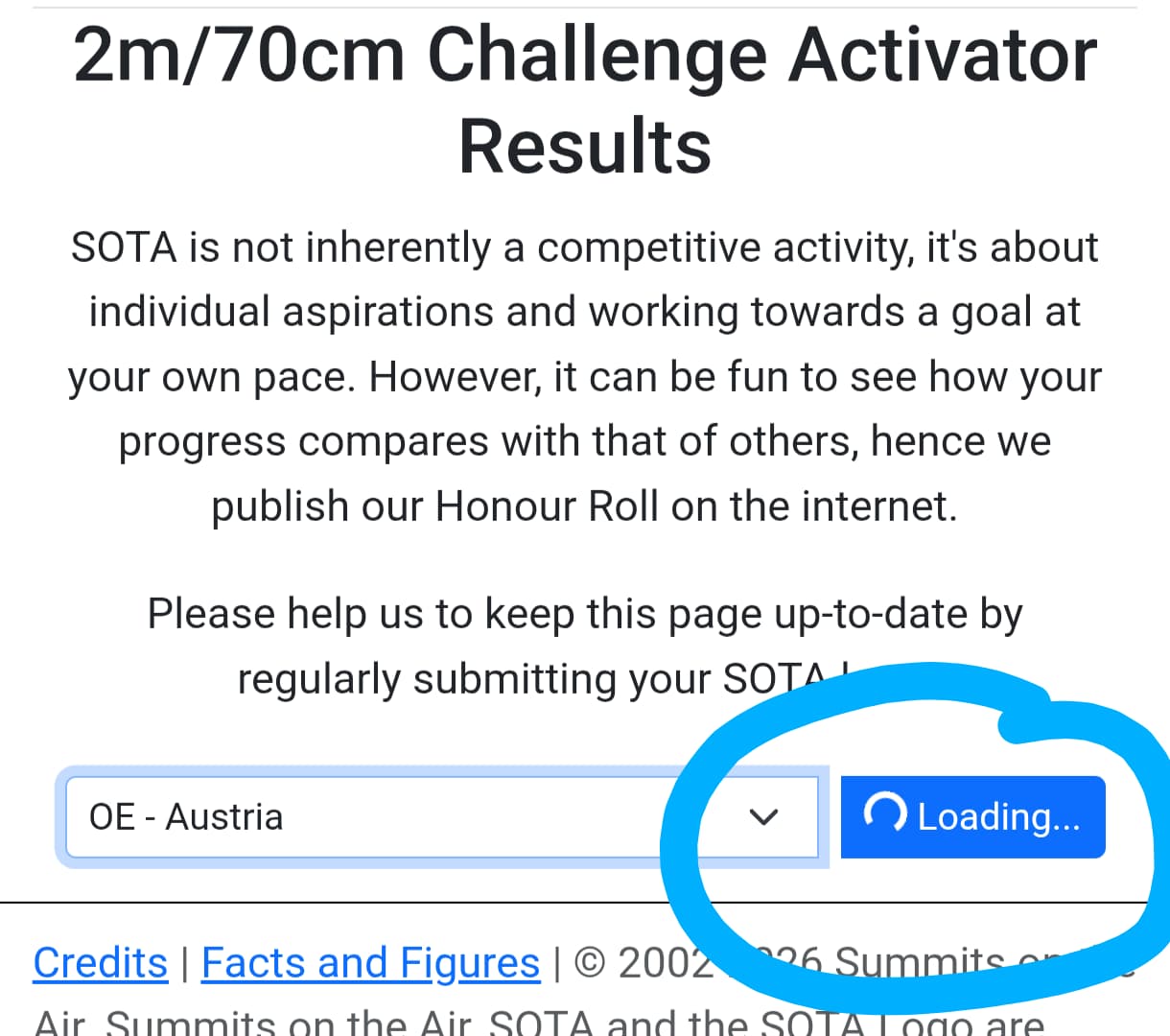

The view of the Activator Challenge page is loading forever…
Database on the egde of failure?
Taking <1sec to render the page for me.

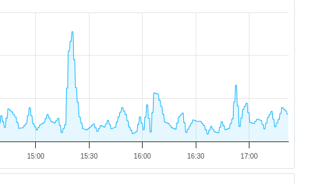

DB CPU load looks OK, the big peak is when we write out an approx 10GB backup file.

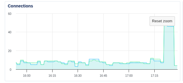

There was a burst of many simultaneous connections. The load was sitting around 8 connections per node and shot up to around 50 connections/node for 5 mins. That’s indicative of something bashing the system a little which may have explained why you got no results.
I am getting the same, just shows loading.
Tried earlier this afternoon and just checked now, still the same.
I am using Safari
Edit: chaser results working ok.
Yes, bad clicking and I looked at the chaser page. Now everyone will be checking to see if it’s working for them making whatever is unhappy a lot more unhappy.

There’s nothing locked on the DB engine, it’s working away and doesn’t seem abnormally loaded. The API servers are spinning away serving requests and other DB pages are loading.

Someone entered some dodgy maidenhead data that should have been better scrubbed - but it got converted to some far out of range longitudes that the DB function that calculates distance correctly said, “Uh uh, no thank you”.
I’ve corrected the relevant entries (there were three), and I’ve added some code to fix that and will upload once I’ve written all my tests and they all pass.
