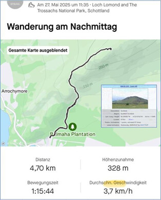

Photo-01-Non-AR-GM7STP-GMSS239.jpg : Map by start of walk to Conic Hill.
Strava-01-Non-AR-GM7STP-GMSS239.jpg : Strava Route taken from car park to summit and back.
Total distance walked was 4.70km with total ascent of 328m and actual walking time of about 1hr 15mins. Our overall duration including stops and SOTAing on the summit was about 3 hrs.

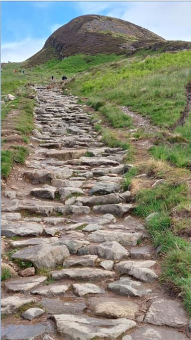

Photo-02-Non-AR-GM7STP-GMSS239.jpg : Well constructed tourist route to summit !

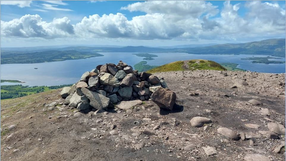

Photo-03-Non-AR-GM7STP-GMSS239.jpg : GM/SS-239 Conic Hill : Summit cairn & view across Loch Lomond.
Don’t be fooled ! There were lots of tourists behind me in this photo sheltering from the stiff wind.

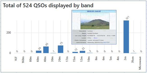

I was very surprised to read that you had not qualified Conic as it is located in prime 2m FM country. There are quite a number of chasers in the Glasgow area and I have worked a good number from much further afield. I assume that you have checked your equipment since the attempted activation to rule that out as a possible reason for non-qualification.
Hopefully you’ll have much better results the next time you are out.

A quick look at the summit page on sotl.as shows that 2m is the winning band on Conic Hill.
