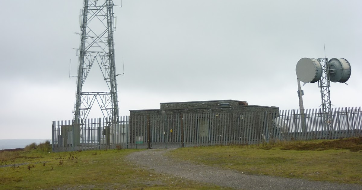

I changed the target summit. Yagi and transverter held up well in rather damp conditions on Cyrn-y-Brain GW/NW-043.
12 logged on 23cm. France heard but not worked.
RSGB contest map
Meanwhile on 70cm, despite more gain (19-element Tonna) and power (5W vs. 2W) I managed only half the number of QSOs.
