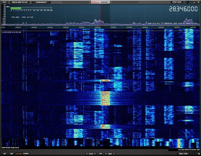

Here’s a spectrogram showing one of the activations which I’ve recently worked with difficulty. The faint signal at the cursor, 28.346 MHz, is him; the strong signal is me.
Notice that the activator is overlapped by a stronger signal out of Europe at 28.344. Even if the interfering station were to have zero spurious emissions (“splatter”), the overlap from his intentional emissions, nominally 3 kHz wide, makes the target signal difficult to copy, even with a modern receiver with brick-wall DSP filtering at the IF stage.
Predictably, he had few callers before moving on to another band.
It’s simply a matter of probability. In QRM Alley (roughly 28.350-28.550 MHz on a typical weekday), the odds that a frequency which sounds clear to you is actually clear are quite bad. Outside that range, the odds are much better – and continue to improve the farther you go.
