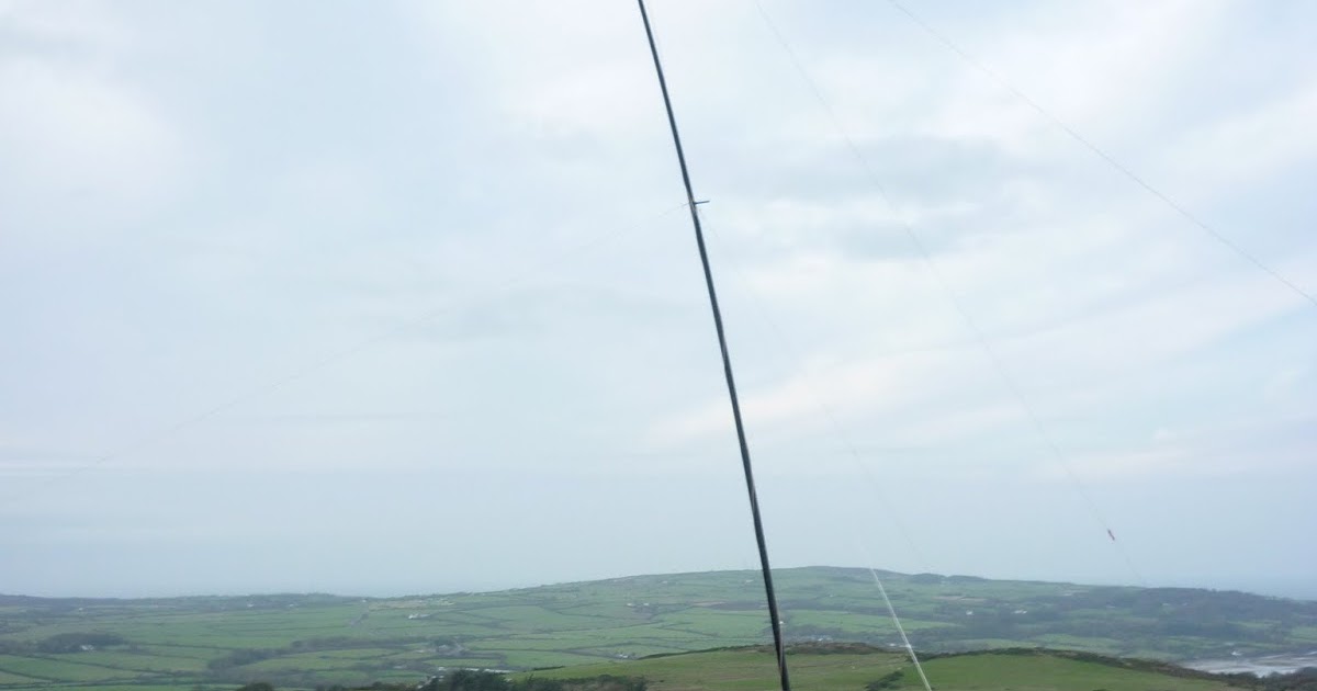

I finally got things working better and had two successful activations from GW/NW using FT8.
