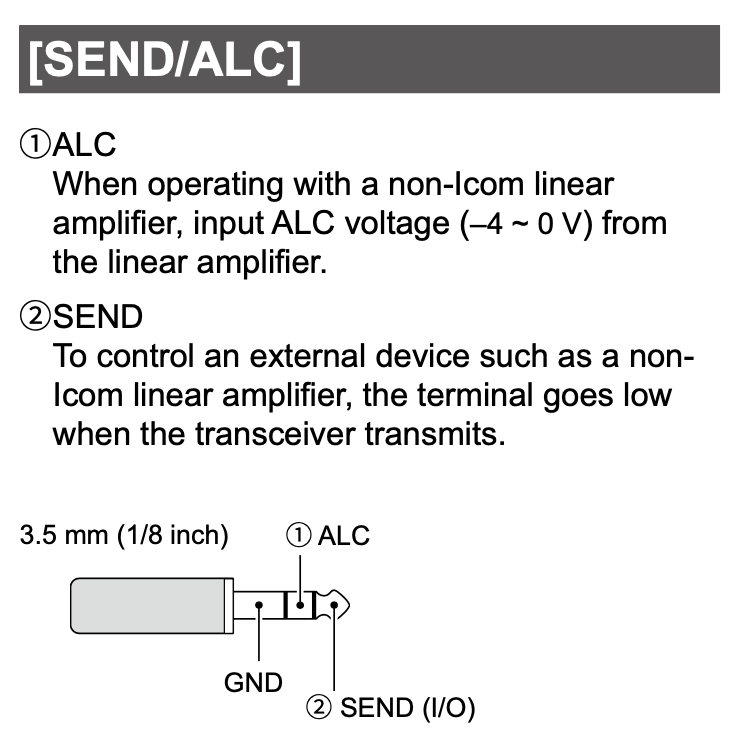

P13-2 of the user manual:
The SEND pin is both an input and output - can be used to either key the IC-705 or to switch an external amp or transverter.
Oh wow, my copy of the manual specifically says that it is an input, no mention of an output (aside from the I/o label ) and it is on p 13-3 on mine.
Thank goodness the 705 has it! Looking at it now it should have been obvious!

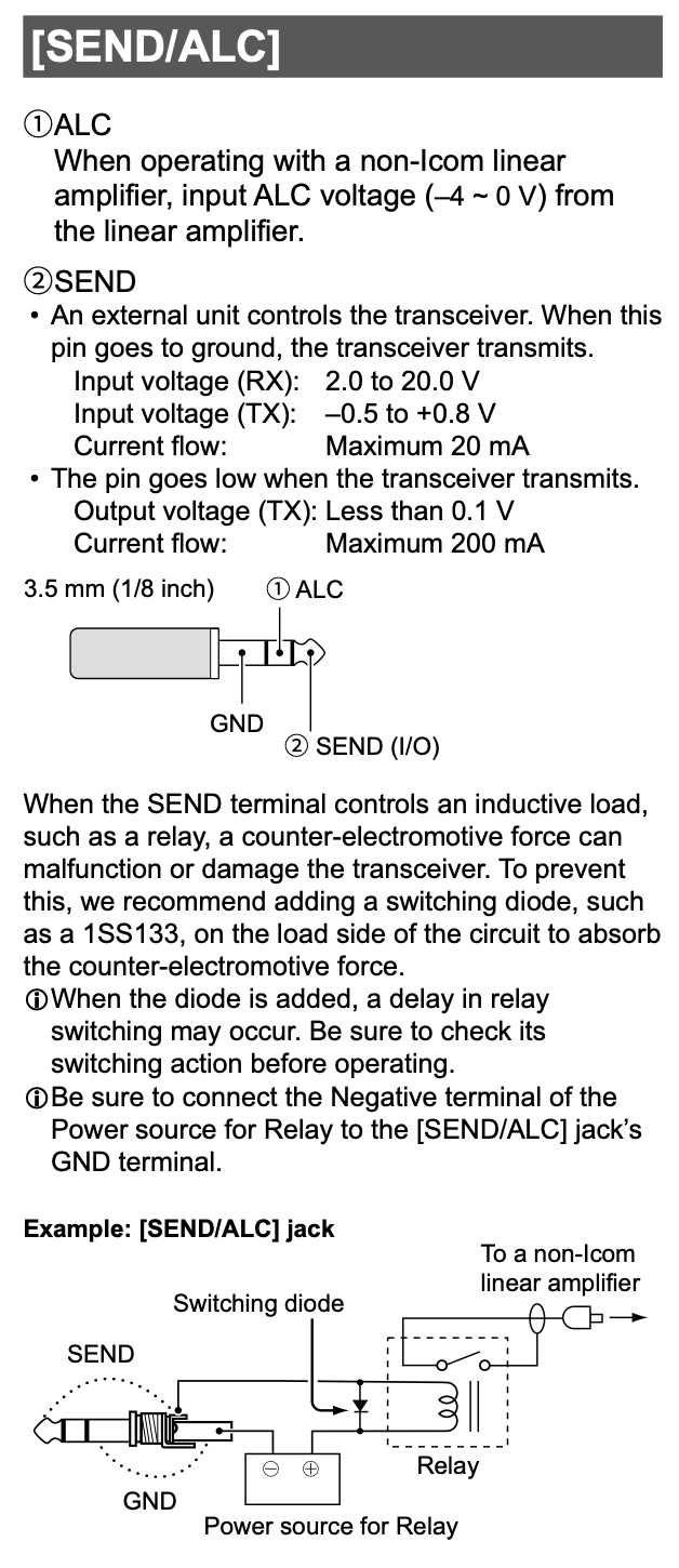

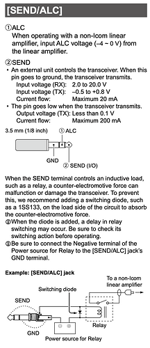

Hi Tom,
Yes the manual seems to have gone through several iterations - the only versioning I can see is a date on the last page. Indeed the Japanese ICOM website has a newer version than mine, the SEND/ALC jack has moved to P13-3 and now includes an example circuit of a relay buffer for keying amplifiers (and they have now added electrical params for the pin):
Sorry I realise this has gone off topic, but hope it is useful,
73, Jonathan
