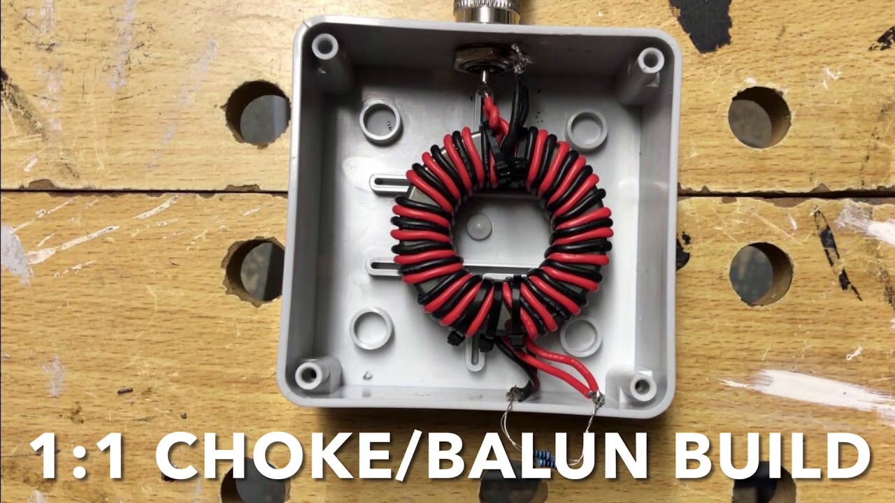

Hope the following makes sense. For portable operation I would like to use the 88ft doublet with a 300ohm ladderline feeder. On the radio end of the ladderline I was planning on putting a 1:1 current balun which is 2x12 turns of 18awg wire on a type 43 ferrite as per this link…
This takes me from the balanced feeder to the coax to the radio.
What I am confused about is, is this enough or do I need something else on the coaxial side of the balun towards the x6100.
