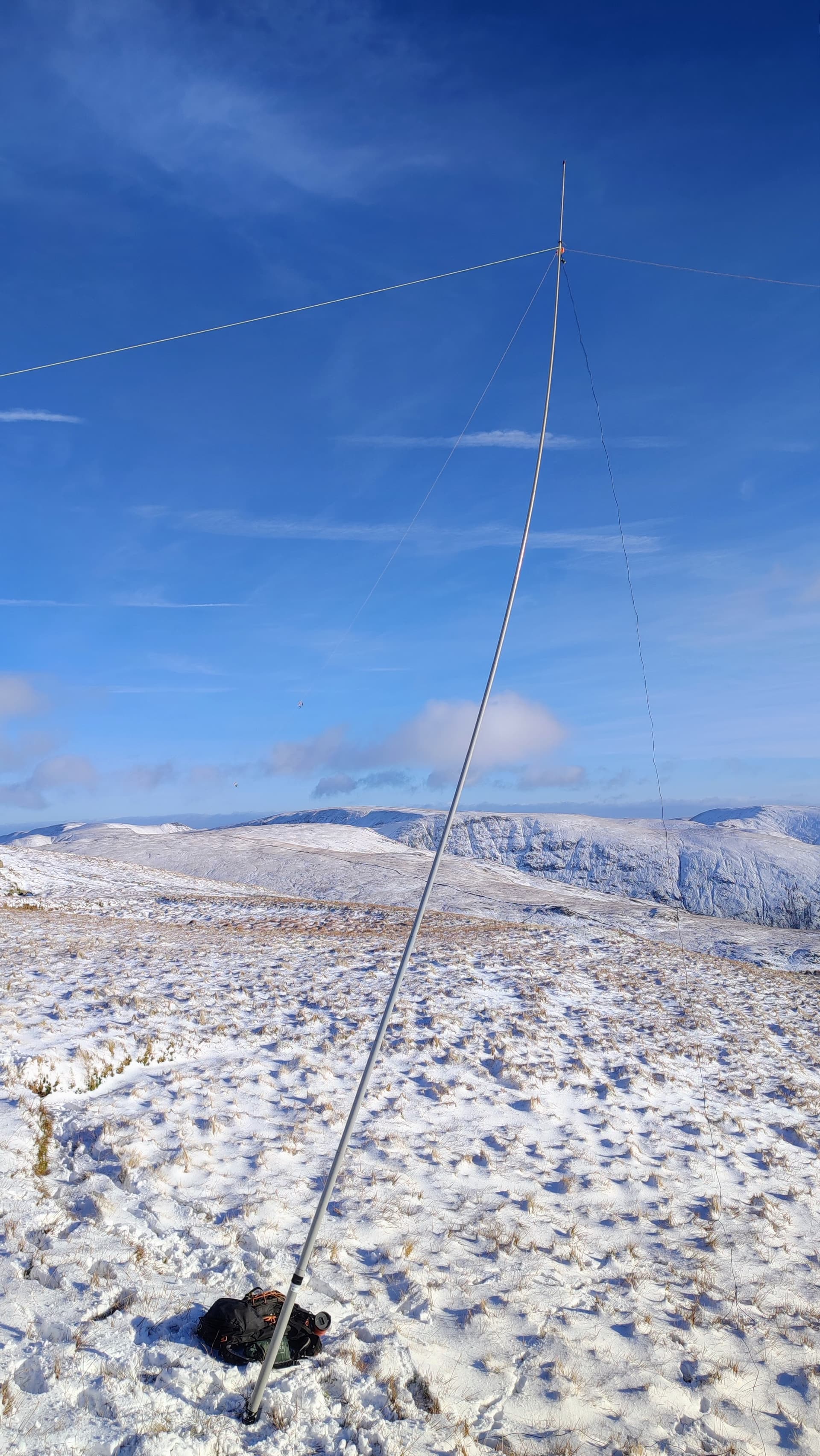

Sotabeams Band Hopper IV and 10m compact travel mast deployed
The wind was biting at the top and I thought I’d have to jerry-rig the DD Tarp, but I found natural shelter on the leeward side. In the sun this was very nice, and at one point I had to take my hat off.

I’d taken two dipoles, the Sotabeams Band Hopper IV is cut for 20/30/40/60/80. I also have a home-made dipole that covers 17/15/12/10 but I never put that up the pole. 10m is fun, but I find it very hit and miss for SOTA.
