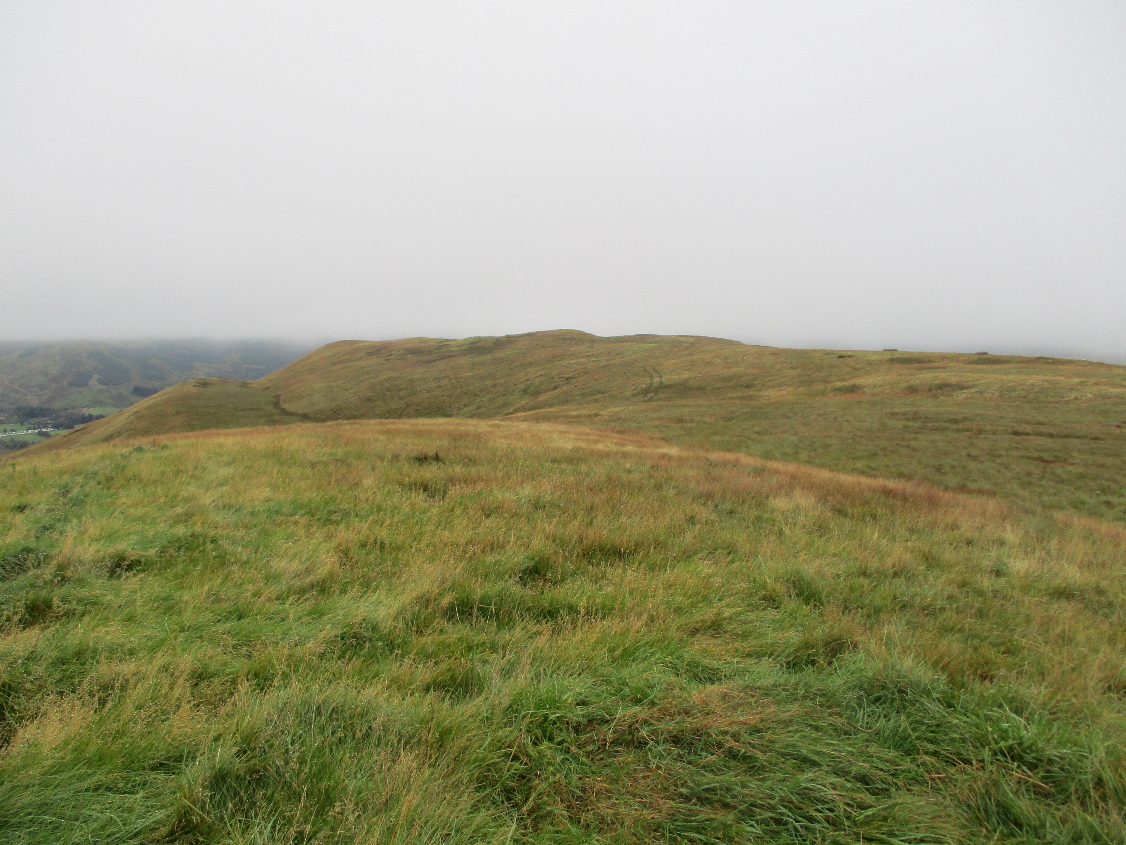

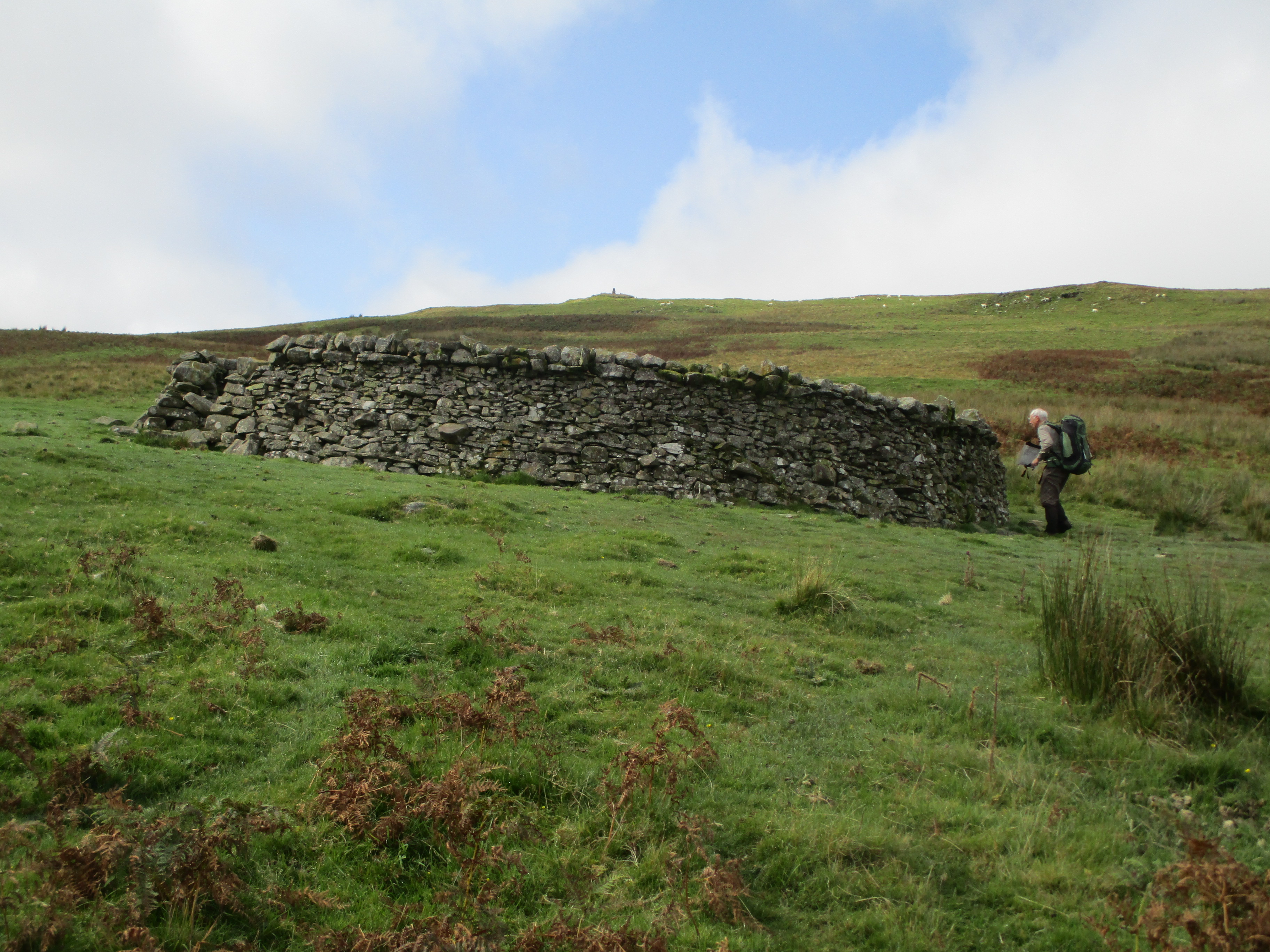

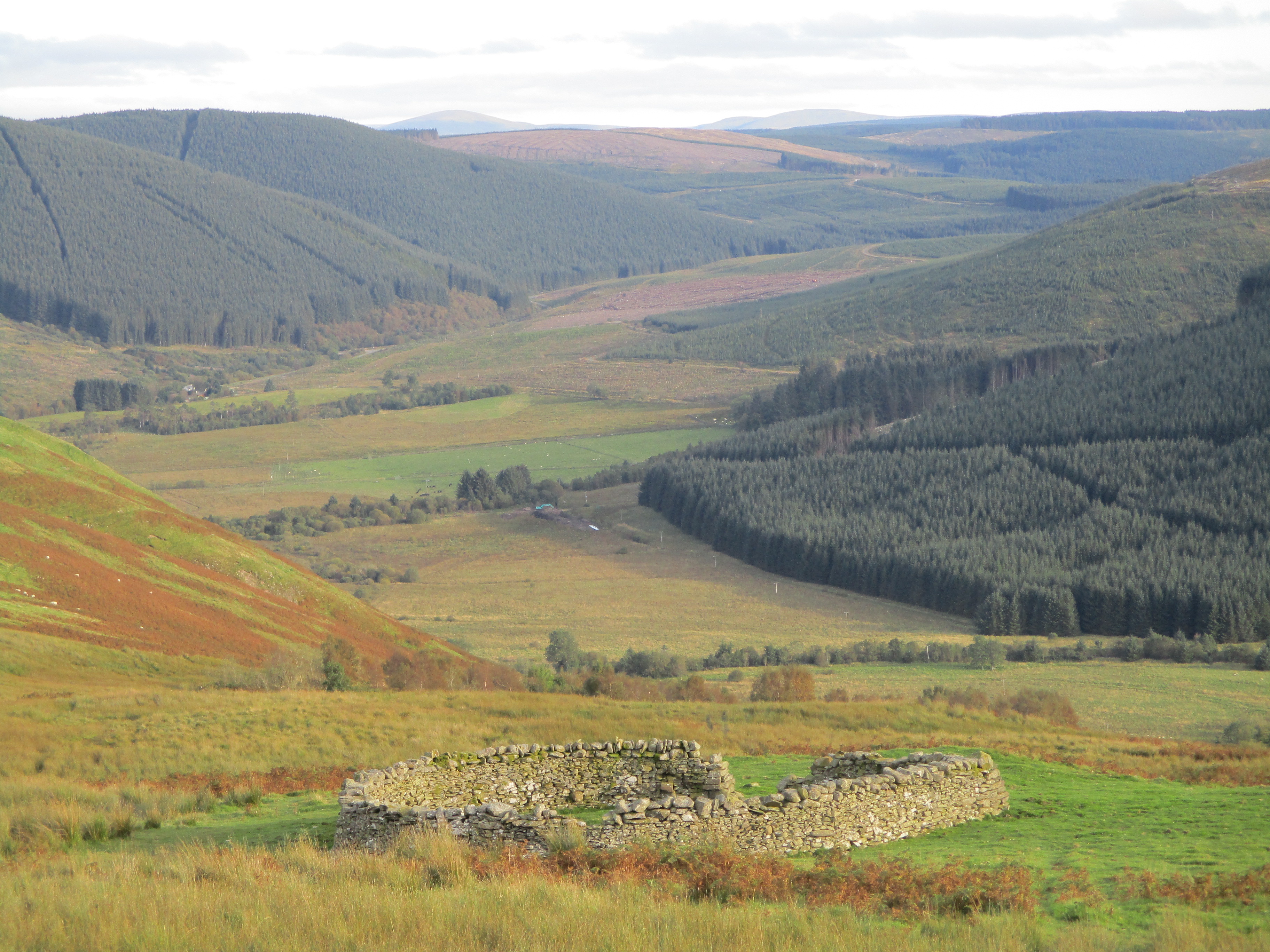

Rather dazed by our success (talking to Cromer in Norfolk on 5w each way with signal reports 51/54??) we plodded back down the track to the car. It was now too late to attempt Andrewhinney Hill but, as several summits had cleared, we decided on Ward Law GM/SS-119, at 594m a slightly lower substitute, but approached from the same valley. We parked at the corrugated iron village hall and I surveyed some of the suggested routes which seemed to involve fences, stone walls or gardens none of which appealed (but I did enjoy watch a nuthatch attacking a nut!) but my attention was caught by a farmer on a quad who was travelling behind the houses – and eventually reached our road! Hence we set off 100 yards back along the road, through the gate and followed the track just above the houses (and fences, walls and gardens…) to the open hillside and the steep grassy ascent between the wooded Deep Syke and Roaring Syke. Then it was a lesser gradient avoiding the bracken and aiming for the higher sheepfold and up to a cairn on the ridge which looked interesting (it wasn’t!)
I then tried to hurry to the summit (still another 180m up) as I heard James M0JCQ on his next summit Grisedale Pike G/LD-015. Luckily he was inundated with callers (and fortunately couldn’t hear my puffing and gasping) until I got close enough to the impressive Jubilee cairn on Ward Law to call him

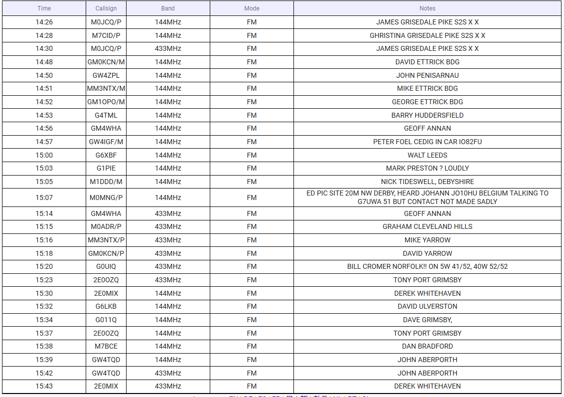

The log indicates that my chasers were in various clusters and I need to find a tracking programme to see if there was any consistent pattern (help please#) but it seems my 5w signal from a dipole about 2m above the ground on GM/SS-119 in the Scottish Borders was travelling west of the Lake District (Whitehaven and Ulverston) to reach NW Wales (Bangor and Bala) and Aberporth GW4TQD (near Cardigan c360km on both 2m and 70cm 54/53!) To the east of the Lake District I contacted Yorkshire (Bradford, Leeds, Huddersfield), Peak District/Derbyshire (300km) and Grimsby on the east coast south of Hull (c290km). Once again G0UIQ, Bill from Cromer, Norfolk (c410km) was coming in strongly (especially on 145.500) and our 70cm contact was 52/52 on 40w and a very clear 41/52 on 5w both sides. A new record for me and not even from a s2s but he does have a 60ft tower!

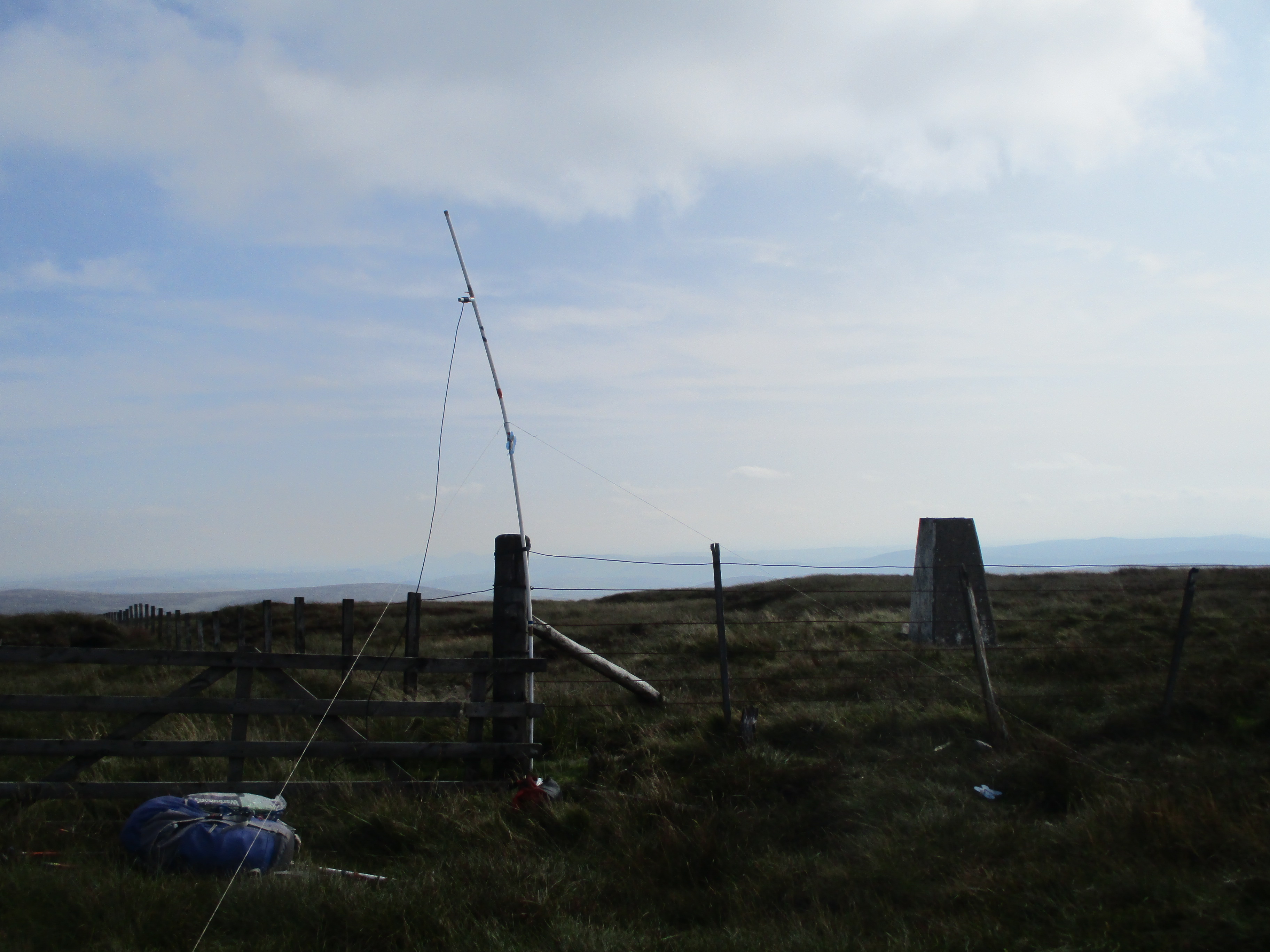

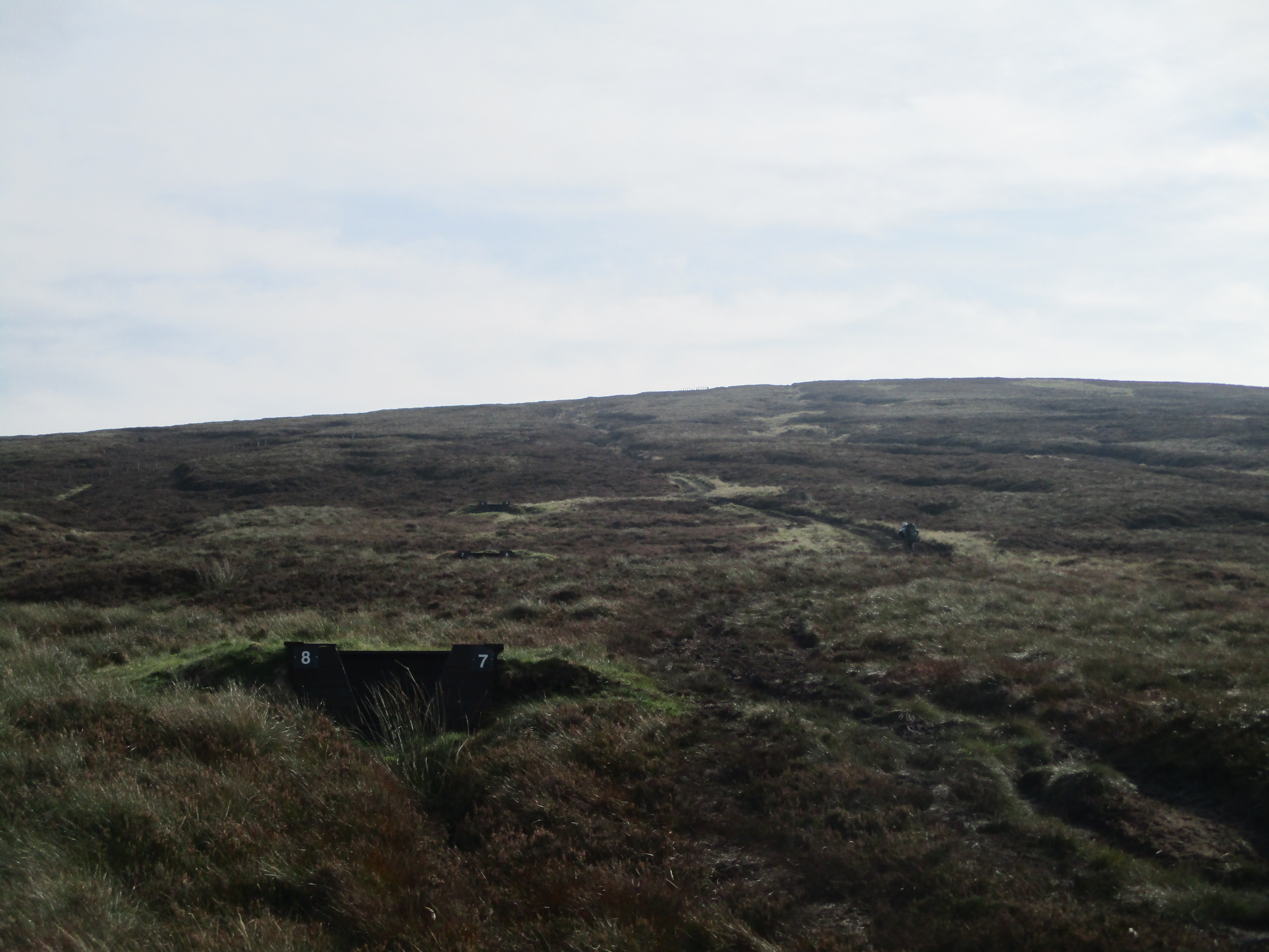

The next day the effects of the lift could still be felt on Windelstraw Law GM/SS-087 eventhough this was a rounded boggy summit with only a trig point and meeting of fences to indicate the top – not good for take-off. The route started off well but gradually narrowed (except in the very boggy bits!) and went on for a long way past numerous grouse butts (he’s some way ahead by now)
before disappearing shortly before a new microwave repeater. I hadn’t had the radio on as I walked up so I was unprepared for the large number of s2s that were immediately available:

Hi Viki,
Thanks for the write ups and the contacts.
For tracking, do you mean something like this?
(from the mapping site under Mapping |Activations)
Alan
Thank you for this - we hadn’t found this tool. There are a number of problems, however, as it has one contact, GW4TDQ in the wrong place (have checked on QRZ) as Aberporth is just N of Cardigan and not near Cardiff, also G6XBF is Walt in Leeds and not London while M0MNG/P who probably lives in Brighton was slightly lost somewhere in Derbyshire - where does it get its information? Can anyone suggest another app which might be more reliable, please - or can I edit this one? I feel that one of my problems is that few of my contacts are registered with SOTA and thus no location can be found for them. Perhaps I am going to have to start asking for the Maidenhead locator…?

Re the wrong locations/no locations - double clicking on a particular QSO (without a valid locator) pops up a window which seems to offer the ability to enter/alter a locator for example M0JLA to G4ZRP on 21st from SS-087 - the locator is listed as JJ00aa (unknown basically) and offers a Save feature - obviously I won’t/can’t alter your QSOs but that may be able to fill the gaps if not too many - QRZ lookups to the rescue? - wouldn’t want to be doing that for many myself…
