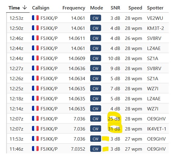

I start on 60m and I hear Gérald @F6HBI/P in F/AM-440 very loud 599+, he gives me a report of 559 … :roll_eyes: No VHF or DMR TG973 but fortunately 5G coverage.
I hear a lot of stations calling me but they don’t receive me…?

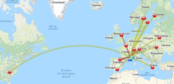

Time to go on 40m but the same problem, I RX quite well but difficult to work anyone :anguished: QSY to 20m and yesss the thing started :+1: Worked 5 chasers in 5 minutes including @K4DY Leslie in NC.
I use an EFHW antenna 10m to 40m with a coil for the 40m and a link for the 60m!
I think I must have a bad contact on the coil as shown by the reports on RBN !

PS: I called Roger @F5LKW because I couldn’t remember using the power menu on the FT-817nd! I was at reduced power from the start … :flushed:
Better to check all my gear and my brain before to go out again !
