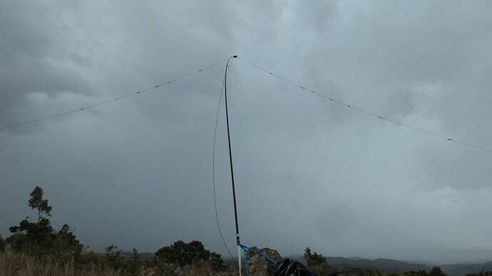

About 4 years ago I took a trip into the bush and changed my 12/20/40/80m link dipole (inverted vee) into a 6/10/12/15/17/20/30/40/80m link dipole.
It took all day and lots of lowering and raising the antenna over a tree limb, but I think the effort was worth it.
I have used it for SOTA QSOs on all these bands.
In more recent times I have added 2m as well.

I have my linked dipole as two legs from the top of the 6m pole and a third guy line as the back stay with my flowerpot for 2m hanging from that. The dipole feeds into the rear connector and the flowerpot into the front BNC on my FT818. I’ve not been active for long but it seems to be working for me so far.
