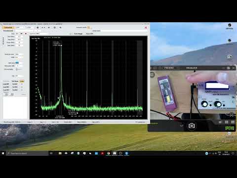

I checked the output with a TinySA:
In my experience, buck converters are much better than most people expect. They are adjustable too, unlike diodes.
   73 Matt
