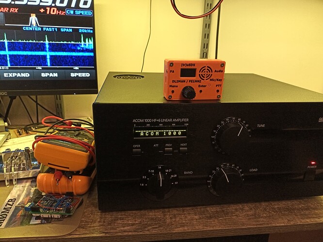

Owen Duffy has posted some additional comments on the poor performance of the (tr)uSDX. His comments don’t surprise me at all. (tr)uSDX IMD performance – owenduffy.net
The worrying aspect to me is that people are using these radios with amplifiers.
What a great idea
One of the difficulties with the USDX series of radio is that they do not all behave the same way. I’ve heard a wide variety of voice quality from them and equally have heard a wide variety of reports on the same signal. Including one that sounded like it had 20% distortion on frequency, looked wide on the spectrum of my home station, yet another operator said he disagreed and the signal sounded good to him. Allowing for variations in ears and perceptions, I think a marginal signal quality can be mistaken for an acceptable one, but when the distortion is making the signal almost unreadable on frequency (at a signal strength of around s5, so no chance of any receiver problem) and is shown in wide sidebands spreading out +/- 5khz, I think I’m justified in reporting that the signal is substandard. Indeed it would be an obligation to report what I observe.
By way of comparison, one of my occasional contacts on 40m is is a vk3 running a high end Flex SDR, and on my IC7610 spectrum display his signal shows as a rectangle of power with nothing in the adjacent channels. Switching to the USB on his LSB signal, there is no signal apparent, but his signal was s9+ on LSB. I asked him to look at my signal from the 7610 and he reported a similarly good quality signal. From that I take it that the receiver is quite capable of assessing the bandwidth of incoming signals at least up to s9. So when I hear and report a signal as distorted, that report is a credible one.
Owen’s article is worth reading and digesting.
73 Andrew VK1DA/VK2DA
What I like about Owen Duffy is that he applies sound, state-of-the art methods for answering amateur radio issues. After all, science is the foundation of our hobby, and counting QSOs and anecdotal impressions are much less informative than measurements and reasoning.

E.g. two strong stations with levels e.g. S7 and S9 produce inter-modulation harmonics with levels like S5-S7. In some cases you might start responding to non-existing CQ or you can hear number of birdies.
Friend of mine sold this RIG (tr)uSDX due to reason above - cannot use this rig in CW.
Your friend had not sold his rig if Guido would have had the original NorCal 2030 front end implemented with bandpass filtering (QCX-CW followed that path, has a solid -129dBm, reviewed by ARRL).
