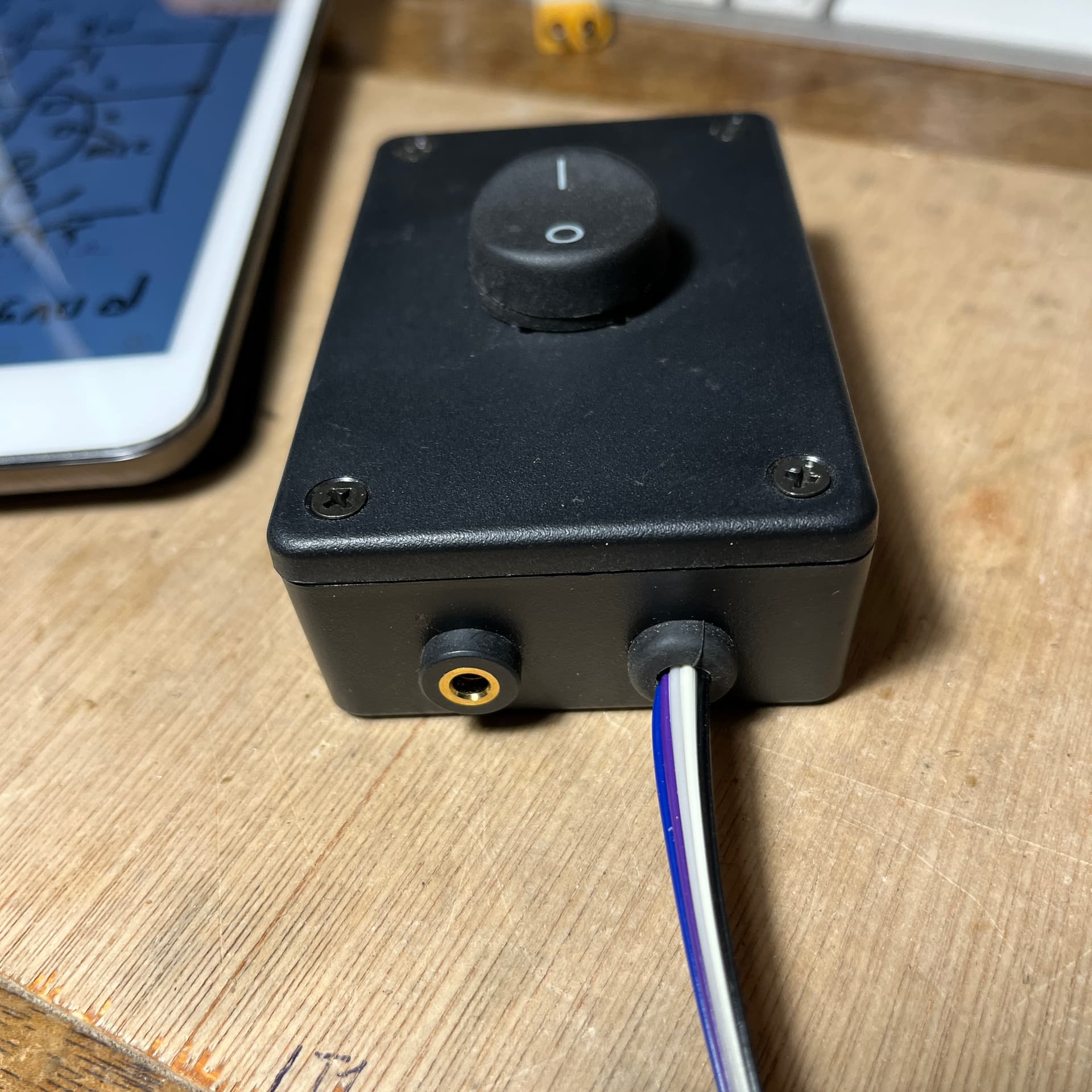

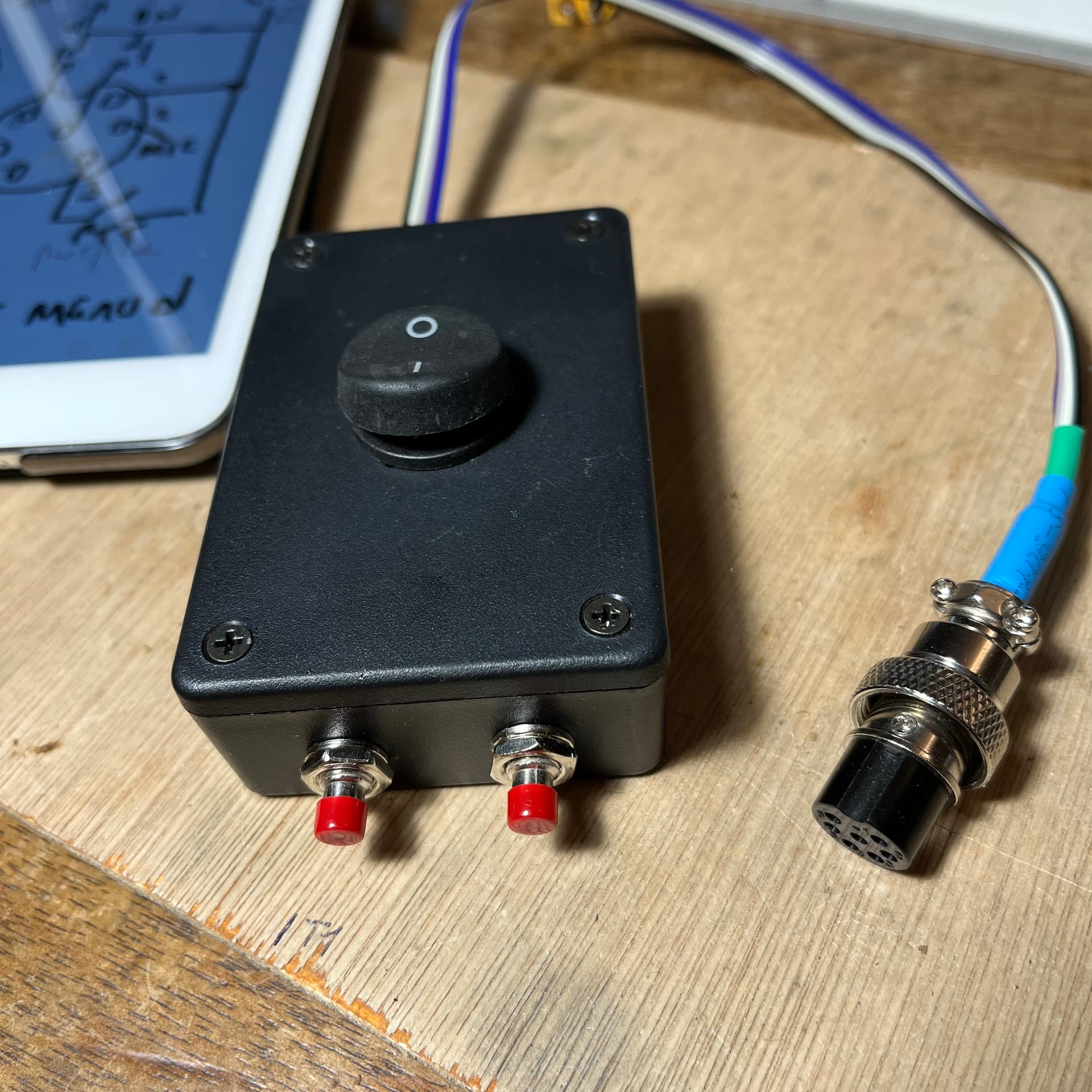

Right, I’m ready with my latest masterpiece… plugs into the FT290R / FT790R mic socket and allows me to switch PTT (when using CW), take audio out to headphones / audio recorder, and step up / down the frequency.

Oh well never mind! So I’m guessing you have your Adiemod wired so the rocker switch is just on or off, same as the original version, but where did you wire to on the mic pin out to control that like the Stand By input? The PTT?
I assume for the up/down buttons you just have those wired to each pin for up and down? I’m flummoxed (great word, I need to use it more often) by how you got the audio out and the key in though. Also, what seals are those at the inputs, little rubber grommets glued on?
I’m about to order the parts for my Deluxe Edition. I’m not brave enough yet to make the Executive Edition Ghia as I don’t know how you wired it up, or what AWG type wire used for the mic connector etc.

Have the parts ordered for the Executive Edition. I need to find out what that 7 pin connector is and get some other bits too for the up down buttons. Did you use 7 strands of wire or buy a 7 strand cable and hack it up?
Had an idea too. How about packing in a keyer with key in/out jacks so the Adiemod becomes an all in one unit and can also save adding a Picokeyer etc in the chain if you want to use a paddle or bug?
I also ordered some parts for the Executive Edition Ghia, but not everything. Exciting times! Completely over the top and unnecessary but still fun!
Let me get this straight after 9 or so posts on a PTT switch. You have replaced the three buttons already in the microphone with switches in a box. So that’s extra weight to be carried up the hill in addition to the microphone already being carried. And, when you want to switch between modes you disconnect the mic and plug in the switches which mimic what you already had with you.
Ah but the add on switch is latching so the rig stays in transmit. Or you use modify lock switch already fitted in the standard 290 YM-47 mic to provide latching PTT. That mod requires a track cut i and 2cm of wire added in the mic. I do get the feeling the river is being lowered rather than raising the bridge.

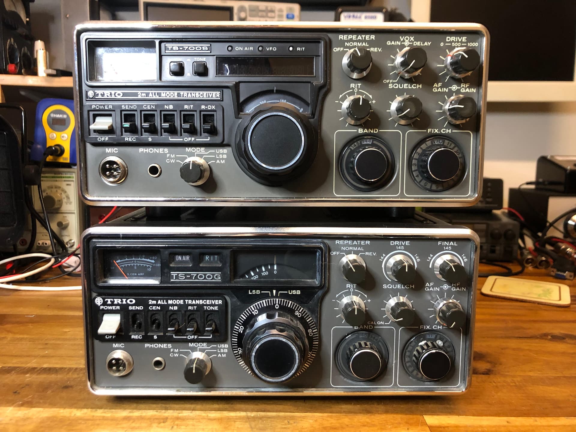

Apart from my Icom IC12, all I can muster up is one of these. The 700G is sans transformer, so therefore SOTA ready at 9 Kg, but needs a little TLC especially on FM. Neither would be a problem on Rombalds Moor, but G4TGJ might shoo me away.
