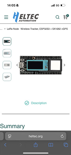

There are many places you can buy the Heltec board from, but here is one of them, website link below:

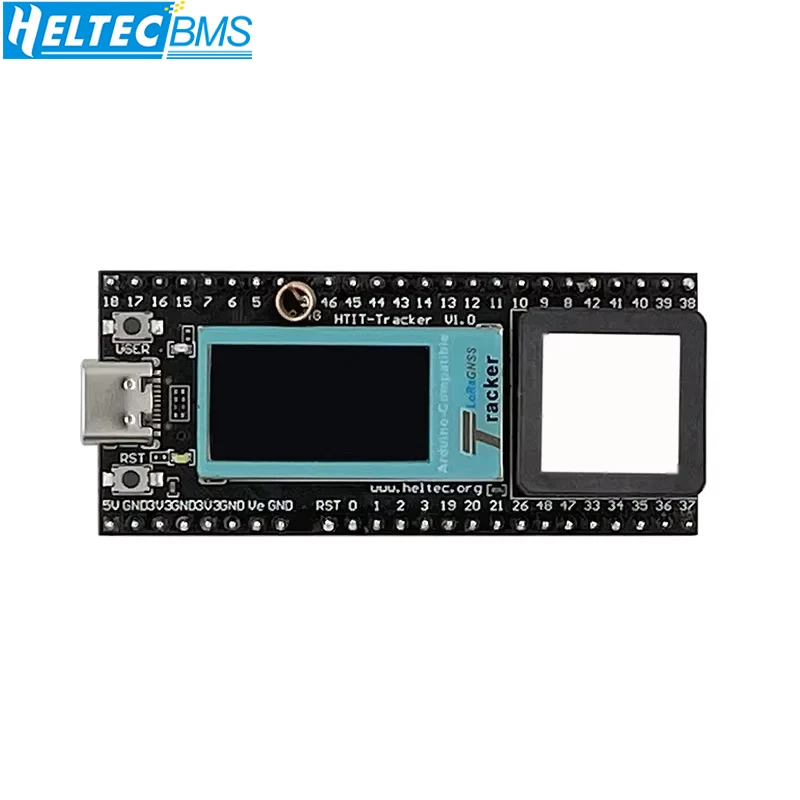

This is an image of the Heltec tracker, to make sure you have the correct item:

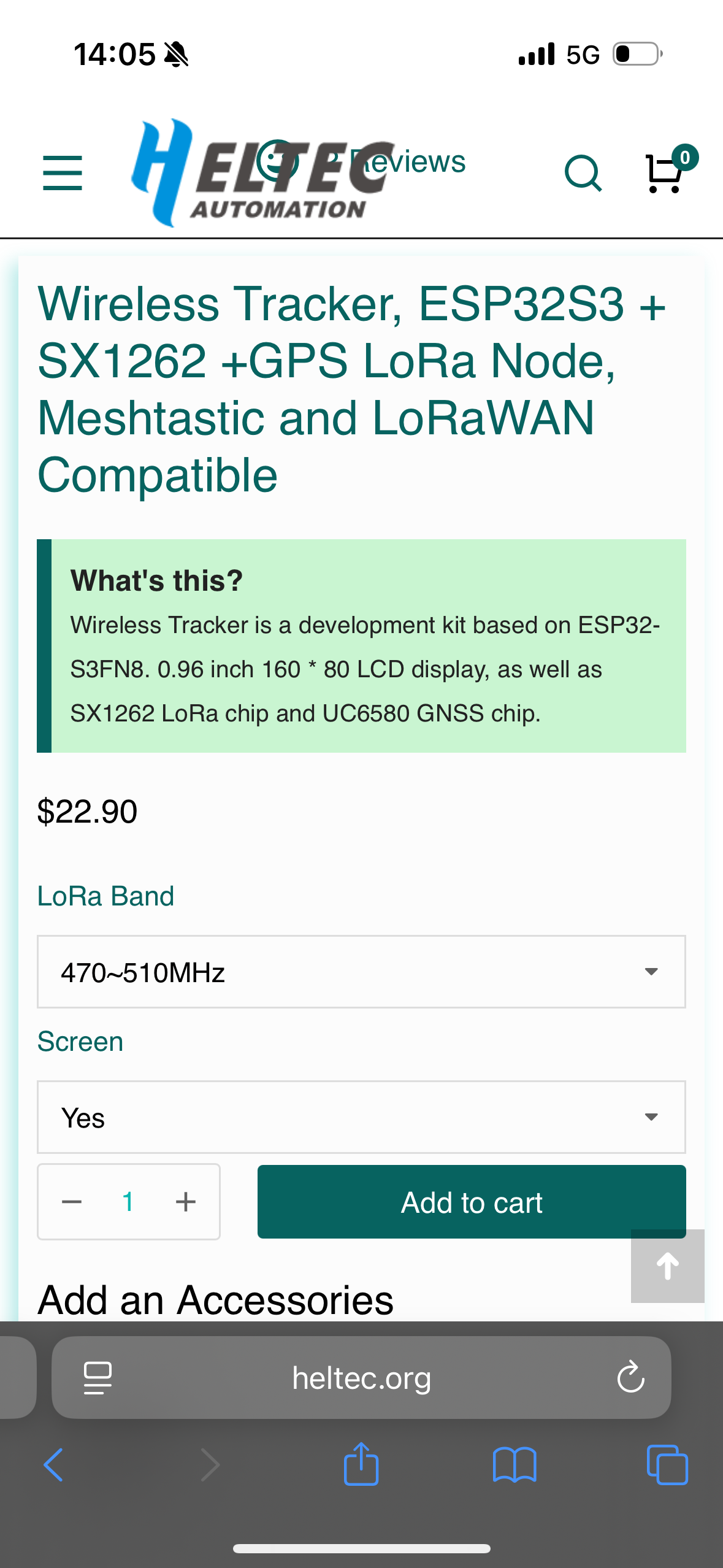

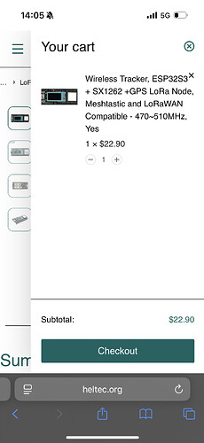

Scroll down the page, to where you get to choose what you want to purchase, and fill in both boxes as below:
LoRa Band needs to be set to ‘470~510MHz’, and the screen set to ‘Yes’.

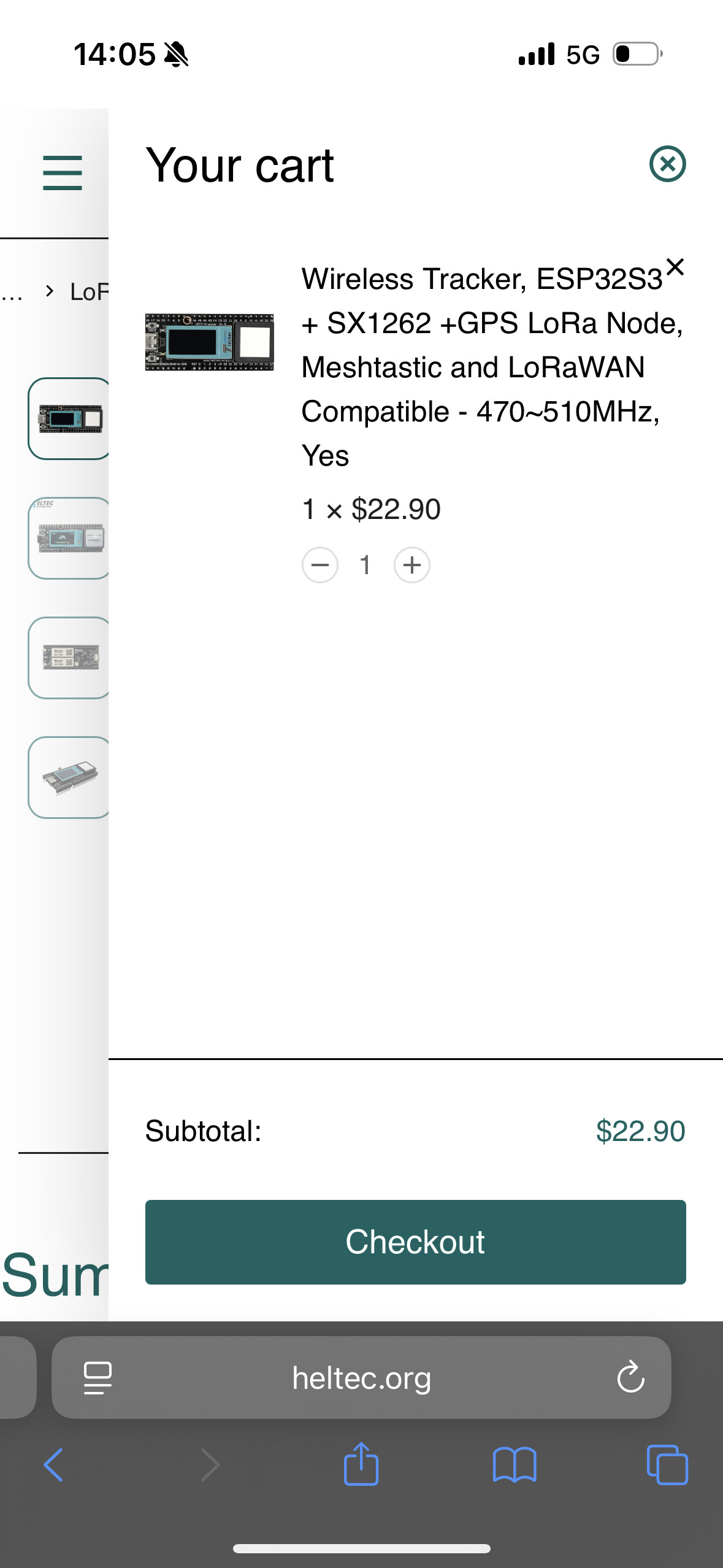

Click ‘add to cart’.
Your cart should look like the below:
Now checkout, and add your delivery details.

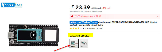

The one thing to watch out is that you choose the correct frequency - you need the “433MHz” variety. AliExpress can be sneaky on this - you need to select the correct “color” option:
EDIT: or see Ben’s post above! :smile:
