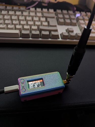

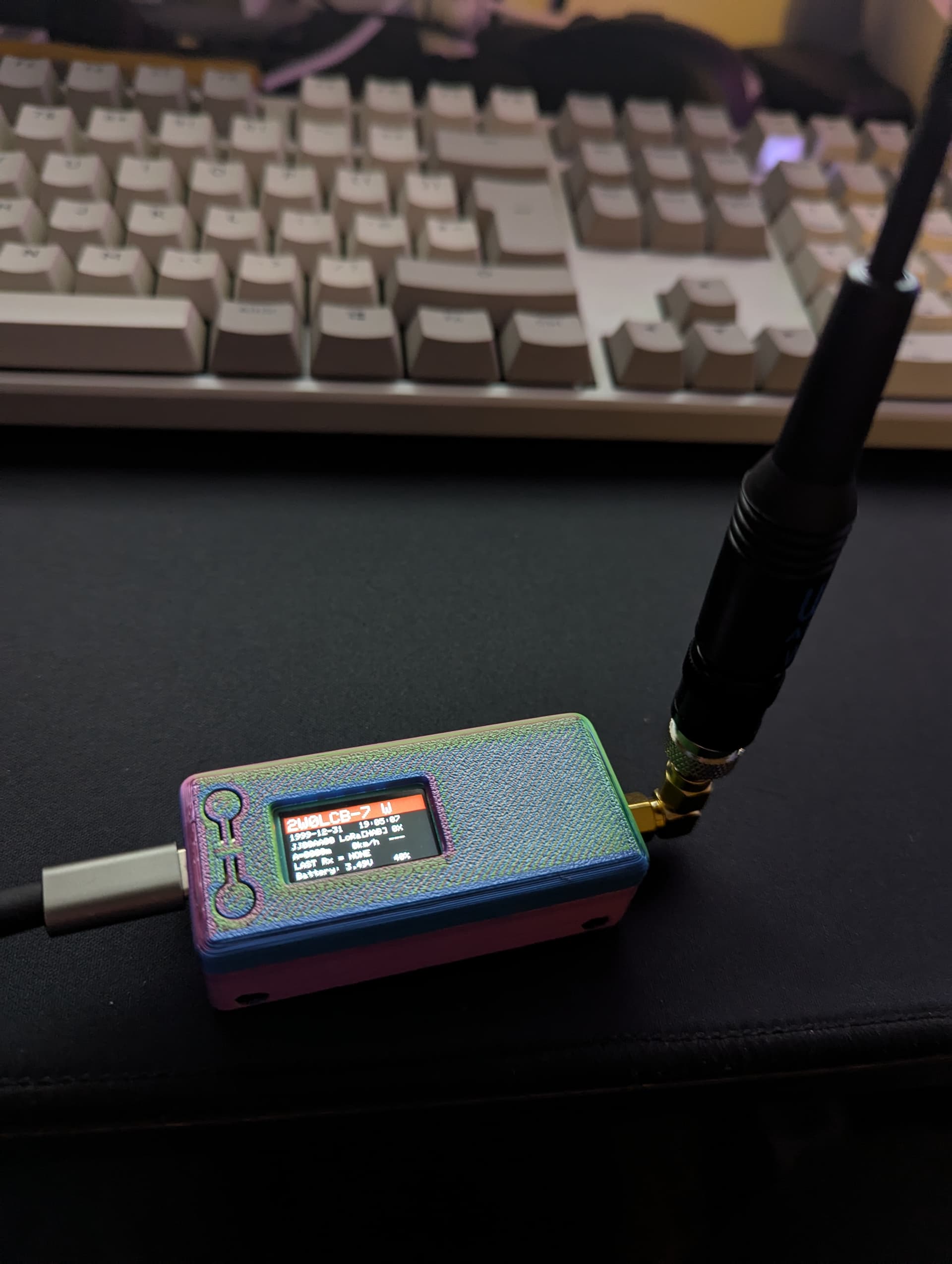

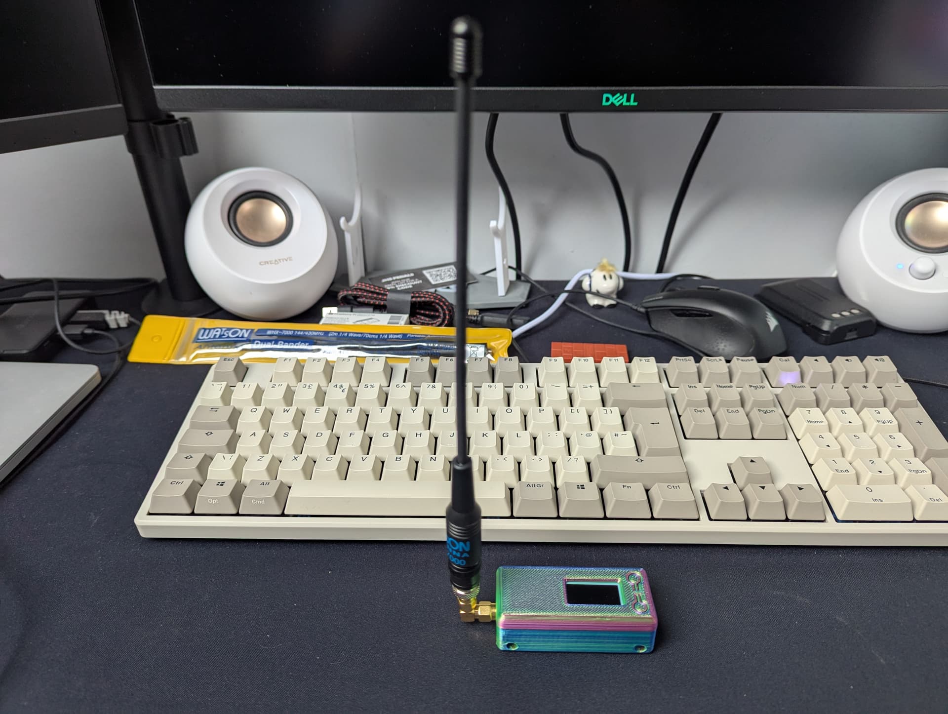

I ordered the board, set it up and now my tracker is ready to go. The PDF instructions were very well documented and made it easy to complete the steps and follow along. I watched Fraser’s video which was very informative and was a great addition in helping me set up my tracker.
So from me, thanks to both user’s for providing these format’s it is much appreciated.
I have attached some photo’s. I 3D printed the case from one of the examples that were in the PDF instructions and attached a right angle connector with an additional BNC connector for my antenna which is a Watson WHX-7000. Hopefully this will be enough to send and receive packets to the repeater :slightly_smiling_face: .
I doubt I am going to win the competition but at this point I am just glad that I am along for the ride :grin: .

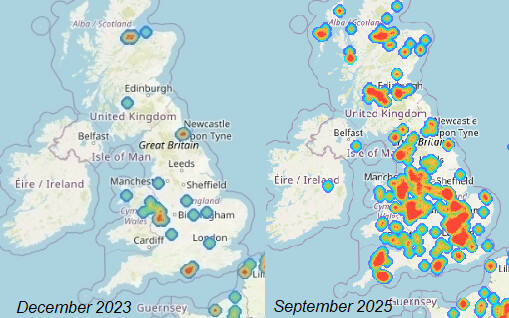

You won’t need to wait for another flight, Paul. With only a few changes in the config (particularly the Tx & Rx frequencies) you can use your new tracker on the terrestrial APRS network, which has seen an extraordinary growth in iGate coverage over the last two years:
When I started using my tracker from the local moors, it was only picked up by three iGates (in Shropshire and the Welsh borders), but now there are more than twenty in range and it’s even received when I turn it on in my back garden!
Thanks Ross - I had figured this, but I was hoping to get involved with the challenge first! I actually ordered two boards, so I can put them to good use. Looking at your heat map, it looks like I will be well served around here in Mold, North Wales.

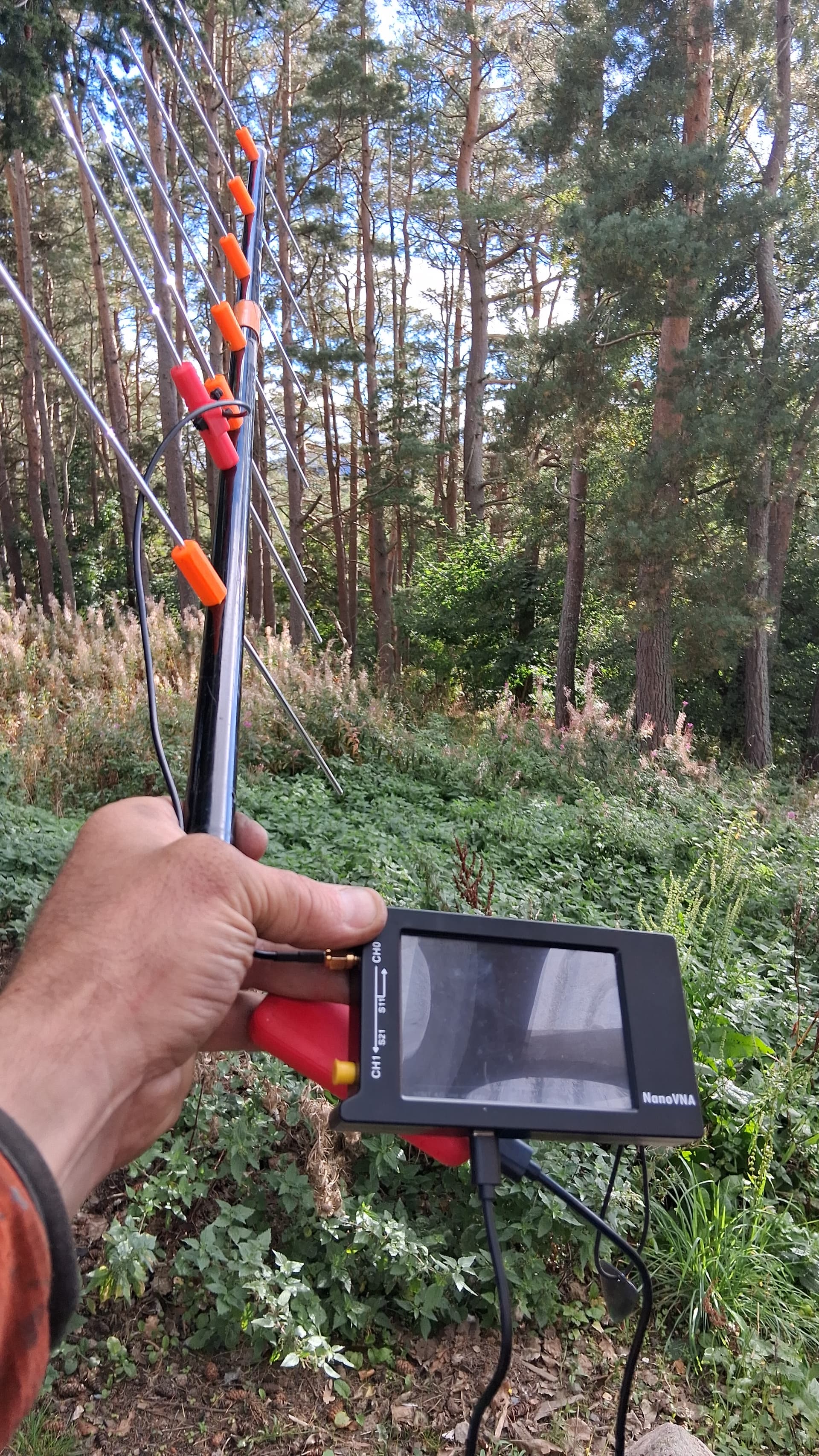

I’m as ready as I’ll ever be. 7 elements fits on a 1m pole. Flat SWR across the band.

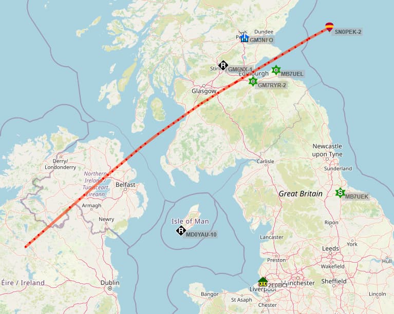

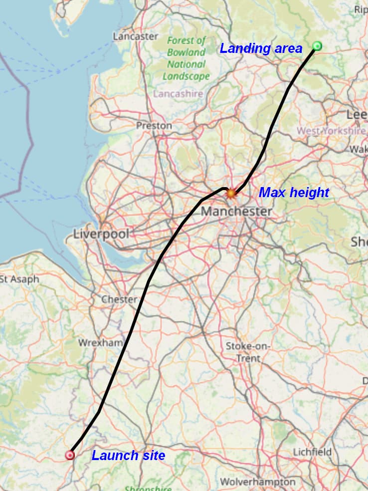

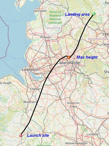

I’ve just received this prediction for the trajectory of Saturday’s flight (thanks Nick):
This is based on the assumed ascent rate, burst altitude and the latest model for the air-currents at different altitudes.
Incidentally, a Polish APRS balloon flew across the country earlier today and was picked up by a number of 2m iGates:
But that was a floating “pico-balloon”, at around 14km altitude.
Looks like the lucky places to be are probably Cornwall, Kent and north of the Border, if you can get your signal heard. :wink:
