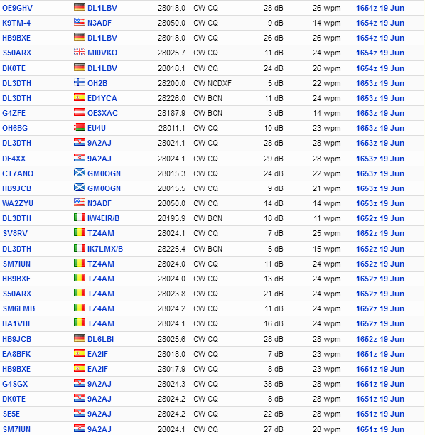

And here is the magnet effect at play again today:
I was first spotted on 28.018 at 16h48.
Then again at 16h51 (twice)
At 16h54, just 3 minutes after these 2 last spots, we’ve got a German station CQing on the very same frequency.
Guru

Hi Guru,
would it be possible that a lot of people don’t touch the VFO knob anymore, but jump from spot to spot in the band map?
Then, when they find an apparently deserted frequency, they start calling CQ. This would explain why other stations start calling on exactly “our” frequency that often. Not bad intention, but mindlessness.
What can we learn from this to avoid making the same mistake? Even if you don’t hear anything on a frequency, it can be worthwhile looking at the band map (if available) before calling CQ to see if anyone else has called CQ here recently. In case of an activation it might help to check the last spots on SOTAwatch before going on air.
73, Roman
Exactly, Roman, that’s my perception and conclusion as well. Many people just clic on spots and they jump from one frequency to other. Skip often don’t let us hear others, so before starting to call CQ, it is convenient to have a look to RBB spots to see what frequencies are currently in use by other stations CQing, as we all know or should know that not copying someone or copying him very weak on a frequency and thus starting ourselves to call CQ there, doesn’t mean that other potential DX would not copy both CQs, one on top of the other, thus understanding nothing or too little and then deciding not to answer to any.
I’d wish everyone would do this…
Guru
