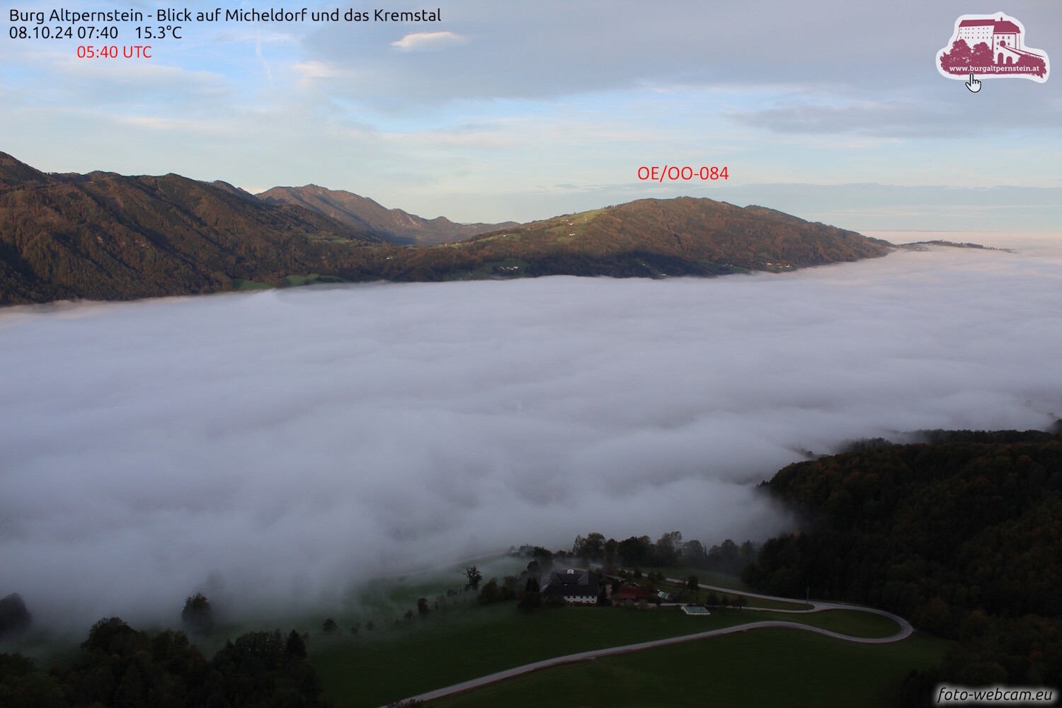

I just placed an alert for the 12th, will activate my local hill OE/OO-084 using the special call OE20SOTA. Here is a webcam view of the summit:
Sunrise is at 5:30 UTC, will be QRV soon after that at about 5:40 UTC.

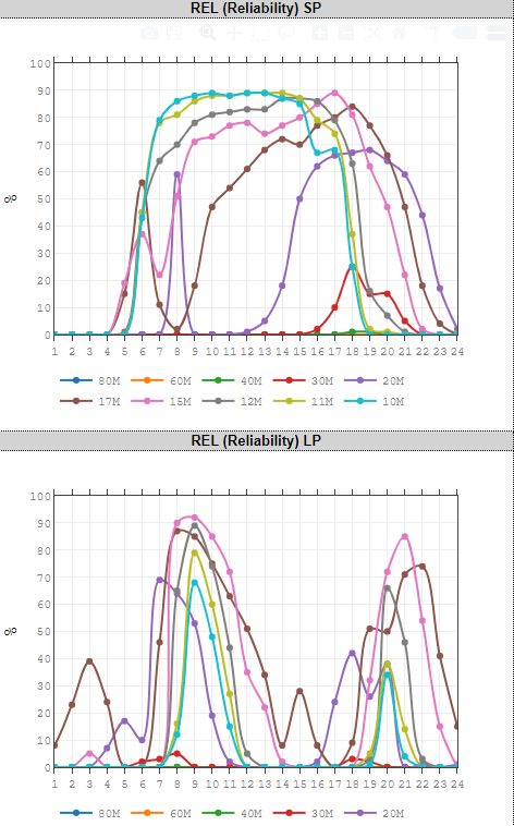

VOACAP is suggesting the 12m band on LP … but let’s hope for a favorable MUF to that we can actually call it a 10m Challenge :wink:
50 Watt SSB into Vertikal GP
SP is non-existing in the EU morning hours. LP looks a bit better
73 Joe

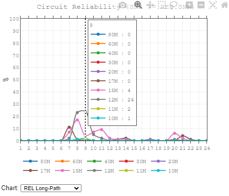

This is what it spits out for me for IO83 to VK1 on Saturday:
Edit: Whoops, that was for 1.5kW of CW. SSB looks more like your chart.

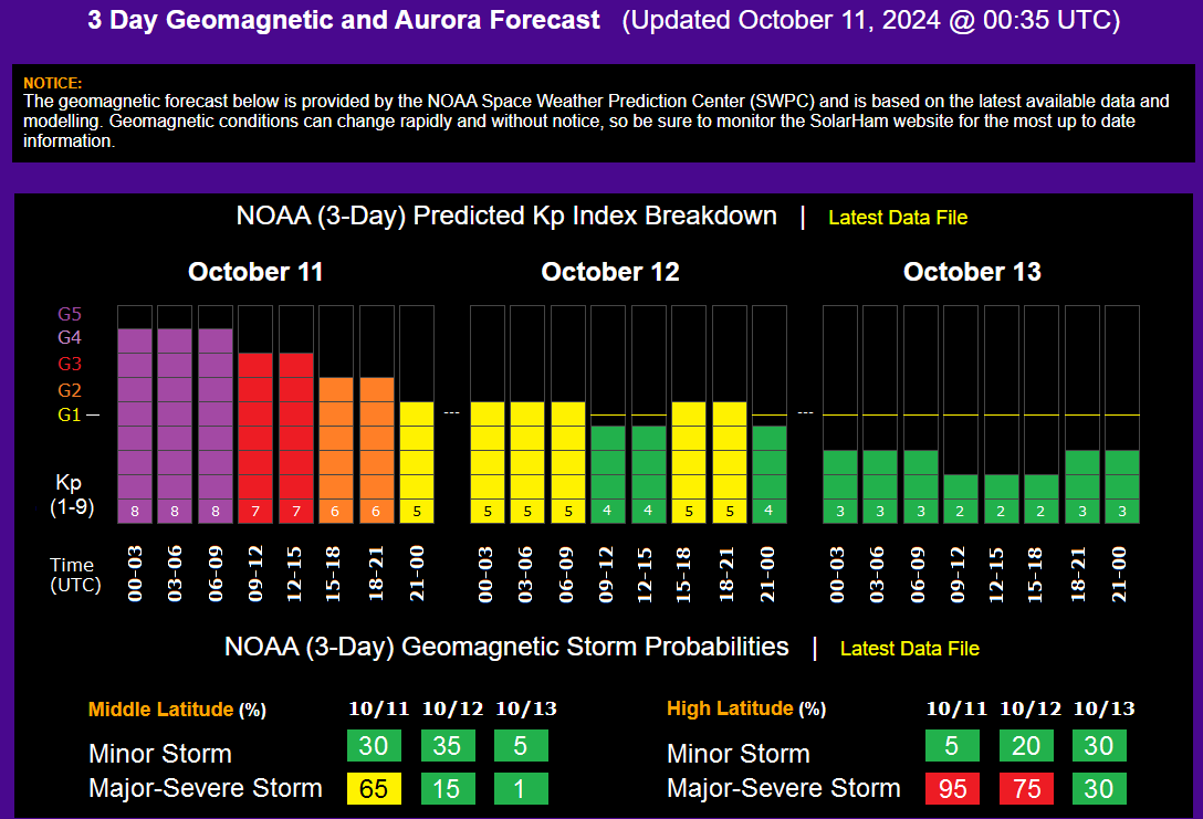

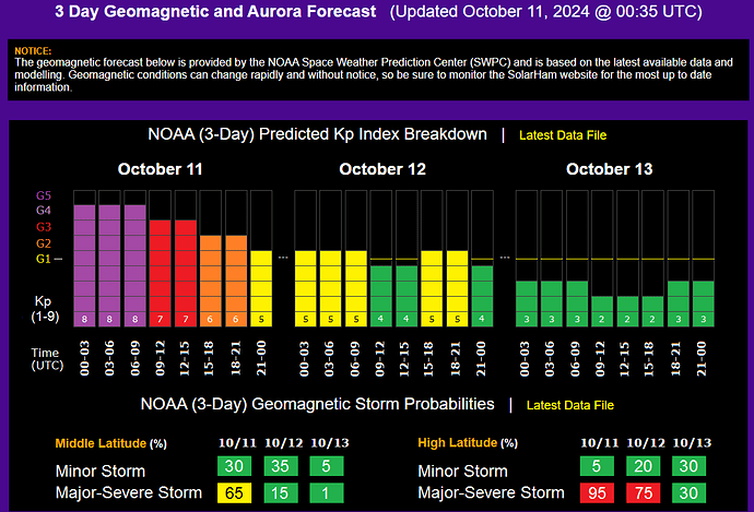

I guess it will be a bit of a gamble for tomorrow morning. Currently hitting CME pushing the the K values up to 8+ but coming down already will be either great of a full ZERO tomorrow on 10m
Will have a look later in the evening and change my plans to a summit with good VHF take-off instread - hi.
The GFZ Hpo30 K index is now at 4 for 1500-1530. So I think that NOAA 3 day prediction may be a bit pessimistic. So 2, maybe 3 for K tomorrow and conditions may be less broken than now.
