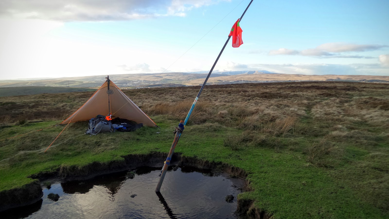

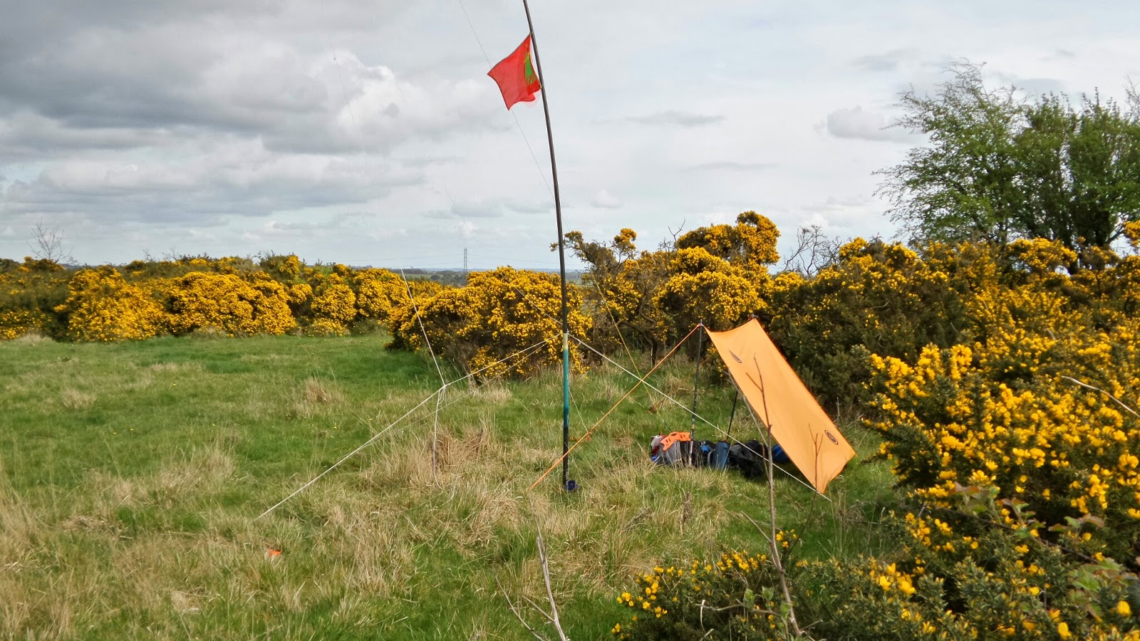

That shelter (half Tee-Pee) looks interesting, where did you find it?
73, Colin G8TMV
73, Colin G8TMV
Colin it’s the little UST Tarp.
It’s been discussed here before.
I am finally putting together a short video about it.
Hopefully it will be available in a couple of days (if I can find some time to edit it)
Here are the previous answers:
