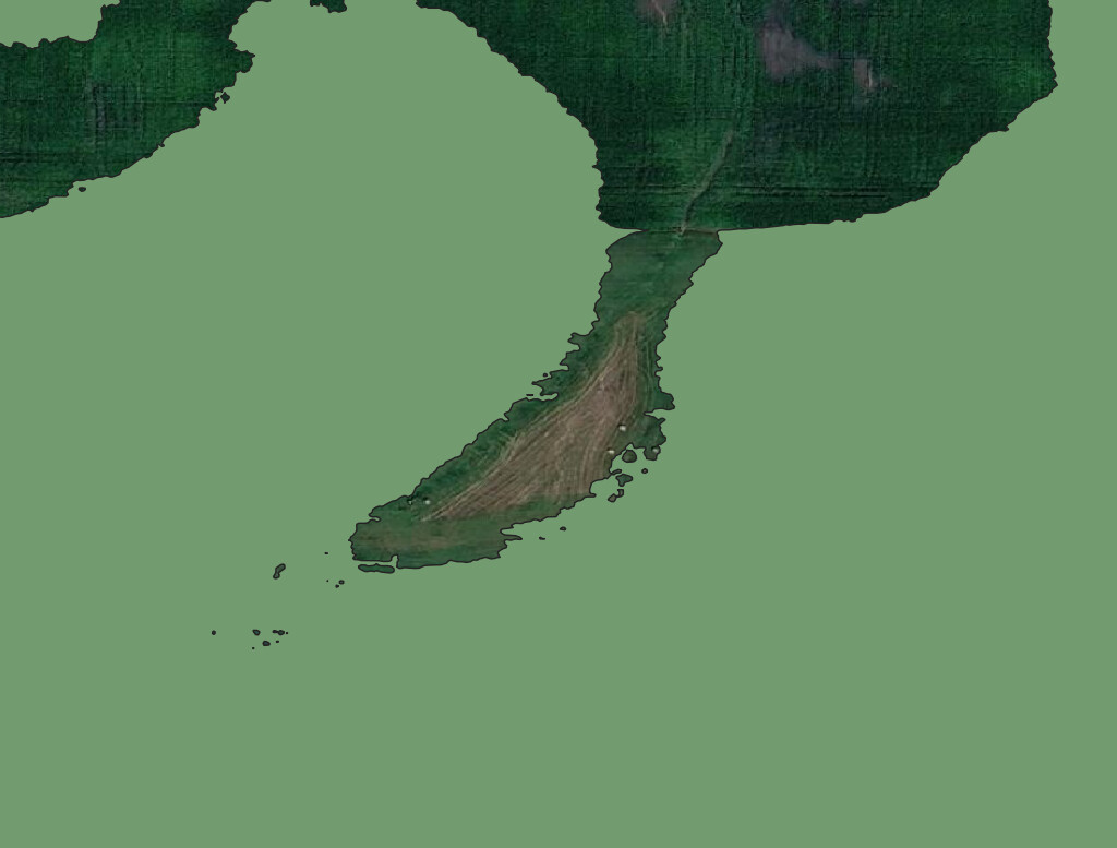

Most common are flattish summits, where noise causes the terrain to “freckle” right around the -25m elevation. These are highly dependent on the underlying LIDAR project’s filter tuning. I don’t consider these meaningful or useful to the activator. Example: W4A/CP-013.

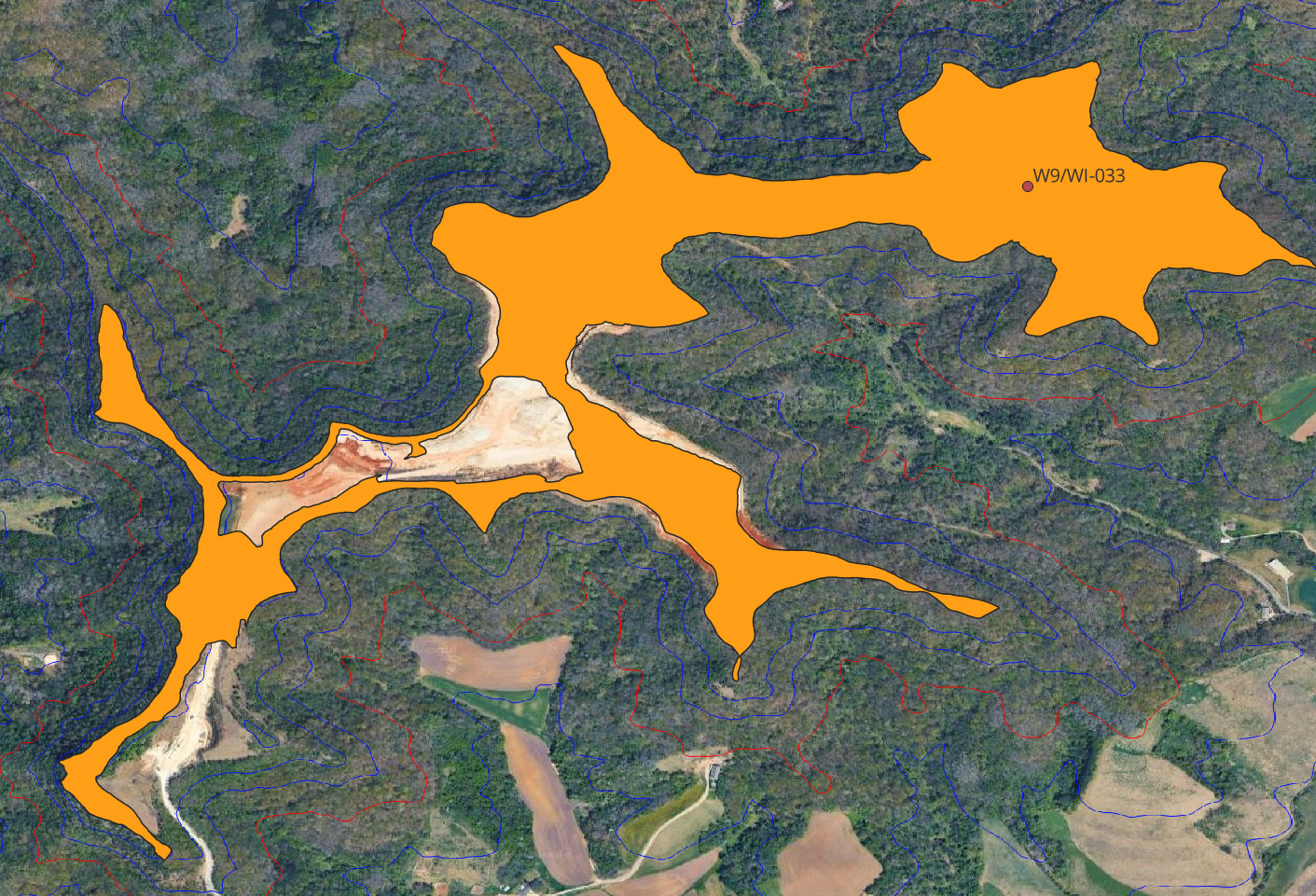

It also happens when terrain is removed by mining. In two cases, I’ve seen entire summits be removed this way! W9/WI-033, below, is sort of beautiful in that they’ve left the summit itself and just enough elevation on the rim to allow some alternate operating locations.

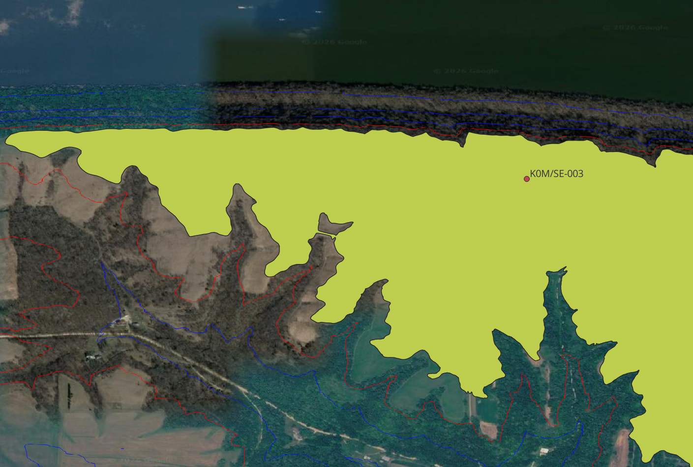

Occasionally, a culvert is to blame. I don’t feel strongly about these, but maybe others do? Example: K0M/SE-003.
