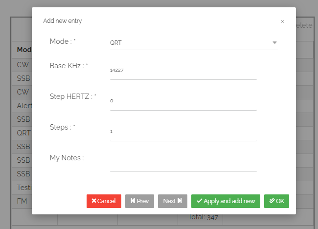

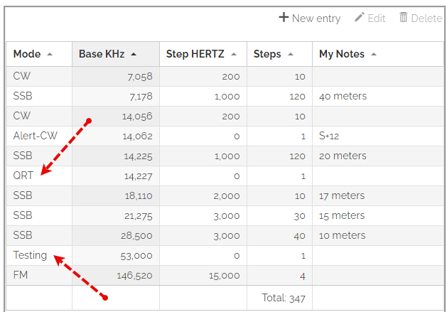

Hi Brian,
I use sotamat a lot and I particularly like FT8 option. I usually send a predefined email to my XYL when I’m done activation so she can estimate when I will be home. Would you please also add a “QRT” command so the chases will know no more TX from me?
Wei AG6AQ
It already exists. That was added when SOTA Watch started supporting the “QRT” and “TEST” modes.
Here is my Frequencies&Modes configuration where you can see I’ve added a 1-step QRT mode and a 1-step TESTING mode:
All you need to do is add a new 1-step 1-frequency (it should be a legitimate frequency even though it will not be used) entry like this:
And don’t forget to sync your new configuration into the SOTAMAT mobile app after changing your configuration on the server. The server and client need to stay in sync or you will get random results! You download your changed configuration on the “Setup” tab.
When you are in the field (without cell service) just select that QRT mode and the QRT placeholder frequency and transmit the computed message. You’ll get spotted on SOTA Watch with a QRT.
The TEST mode works the same way.
73 de AB6D - Brian
