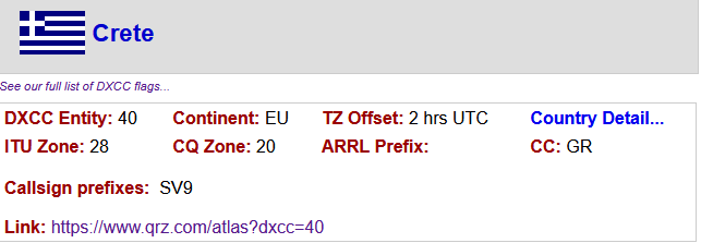

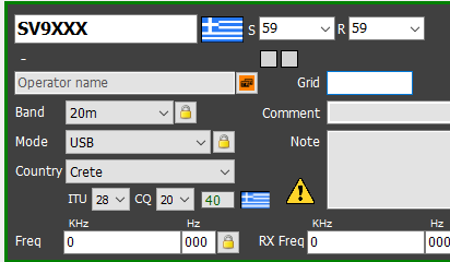

Log4OM2 detects a QSO with a SV9 station correctly as Crete with DXCC 40
Log4OM (the old version) is heavily outdated but I would be surprised that DXCC are not identified correctly
So not sure what is happening?
