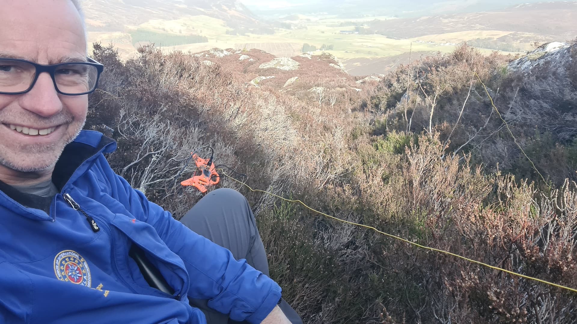

It was windy up there today but there was a handy wall to shelter behind.
On a very windy March day last year I gave up on any mast at all and draped my EFHW on the heather. I still got 11 contacts with my KX2.
Now of course I know it was horribly compromised… but it doesn’t mean it won’t work.
