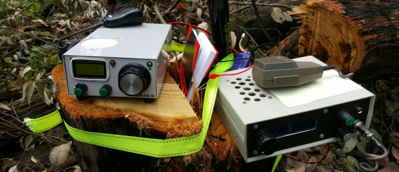

Two more homebrew rigs, left is a scratch-built ‘TCF’ 40m SSB superhet rig, 5 watts. Right is an MST-400 (kit) by OzQrp, similar, both on VK3/VC-027 Mt Little Joe, 1.5 hours north east of Melbourne.
