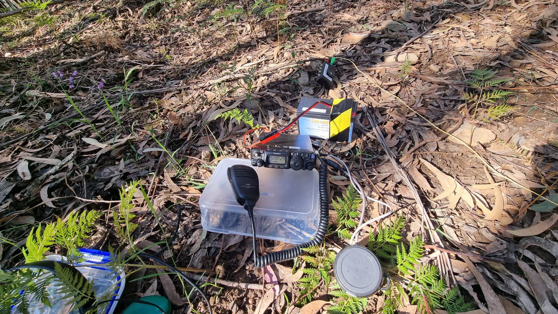

Looking back over this topic after many summits of FT8 with FT8CN and FT817 during the 10m challenge I can report that my FT817 is still happy and working fine.
For FT8 on summits using FT817 I have been using a modified Bluetooth speaker for the audio interface and using VOX for PTT. The modifications made to the Bluetooth speaker included adding 3k / 3k audio transformers for audio isolation, trimpots for setting audio levels, tracing the TX and RX audio paths in the speaker and breaking these paths to insert/remove audio as required.
Adding short leads, with a ferrite choke on the TX lead, enabled connection to the headphone socket and microphone socket of the FT817.
In operation I set the RF power for maximum and adjusted the audio level in FT8CN for 1 bar of ALC. Results during the 10m challenge were good, although FT8CN didn’t auto sequence well and each ā€˜over’ needed to be manually initiated, causing each QSO to be twice as long as normal :frowning:
The photo below shows my FT8 set up with FT817 and Bluetooth speaker. The microphone in the photo is not connected during FT8, but stays with the radio as it is cable tied to the side.

What is the speaker that you have been using?
I’ve been trying to make something similar using the board from a $2 Bluetooth headset but I couldn’t get it to connect reliably.
My speaker was from a local VK/ZL electronics supplier https://www.jaycar.com.au/mini-portable-bluetooth-speaker/p/XC5227
This speaker is now out of stock and I have been working with a later model https://www.jaycar.com.au/mini-3w-speaker-with-bluetooth-technology/p/XC5234 with the intention of including a VOX in the speaker, rather than relying on the VOX in the radio. I have found when using the Bluetooth speaker on my FT450D the level required to reliably activate the internal VOX is so high that the ALC is about 1/2 meter which, I am told, is unwise for clean FT8 transmissions. That said, I haven’t seen any criticism of holding the microphone to a phone speaker for FT8. :confused:
