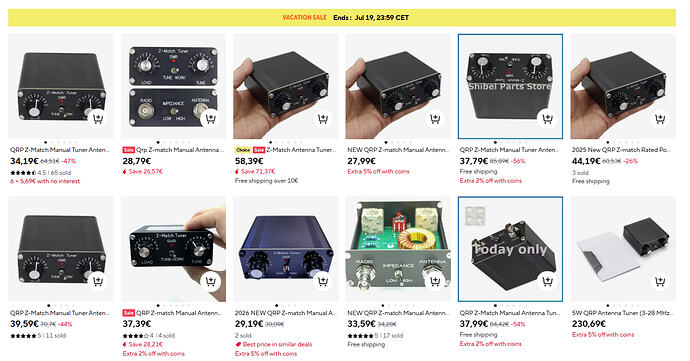

Ah! I have seen this on Alistair of the Express variety, previously. Is it this?
https://www.aliexpress.com/item/1005008351468614.html
The MAT-705+ is about the size of a family size bar of Fruit & Nut and not too bad a tuner (for the 705). If this thing is smaller that would be great for packing in a bag.
EDIT: Just found it on Amazon, same tuner. €3.xx more but will arrive tomorrow, and if it’s a load of old pony I can send it back free.

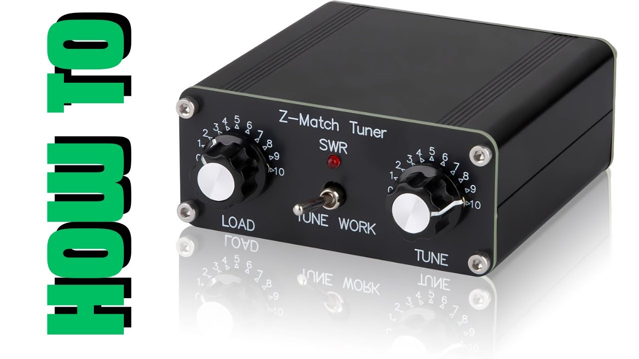

Couple of good videos on YouTube about the Alistair tuner:

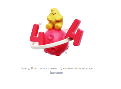

Good that you found one on Amazon, as the link you posted gives me the error:
There seem to be different opinions about what it should cost on AliExporess - €230?? I paid about €28 if I remember correctly.
The one you have on Amazon is the same device - I find €40 expensive compared to the cheapest Ali prices (even when they will now have €3 added to them). Unless the Irish seller is sourcing rejects (which I doubt), the quality is good, and for up to 10w PEP it does a fine job. It’s not automatic, but that is normally not an issue - by the way, the built-in SWR LED works well, - you use it to match the antenna. Operation instructions/ circuit diagram are on the web; all I got was the unit itself. (That may have changed in the interim, from what your video shows).
73 Ed.
Update: that high-priced seller, seems to be on Amazon as well.
Seems to be a geofenced URL. Odd!
The tuner is the same as the one you added a screenshot of anyway so all good. Price on Ali was €40 for a fully assembled one. The €28 to €35 price is for a kit version.
I went for the built version. €43 from Amazon, free returns, arrives tomorrow. If it’s a load of pony it can be returned with no hassle. Going the Ali route will take a couple weeks, plus the additional ‘fees’ from An Post when it arrives in Ireland.

By the way, I presume your feed line will be coax from your 9:1 UNUN, not that you want to connect the EFRW wire straight to the unit - if you do, I’d recommend using one of those BNC to terminal connector adapters rather than making the modifications shown in the video (he had to do that as he needed a floating earth).

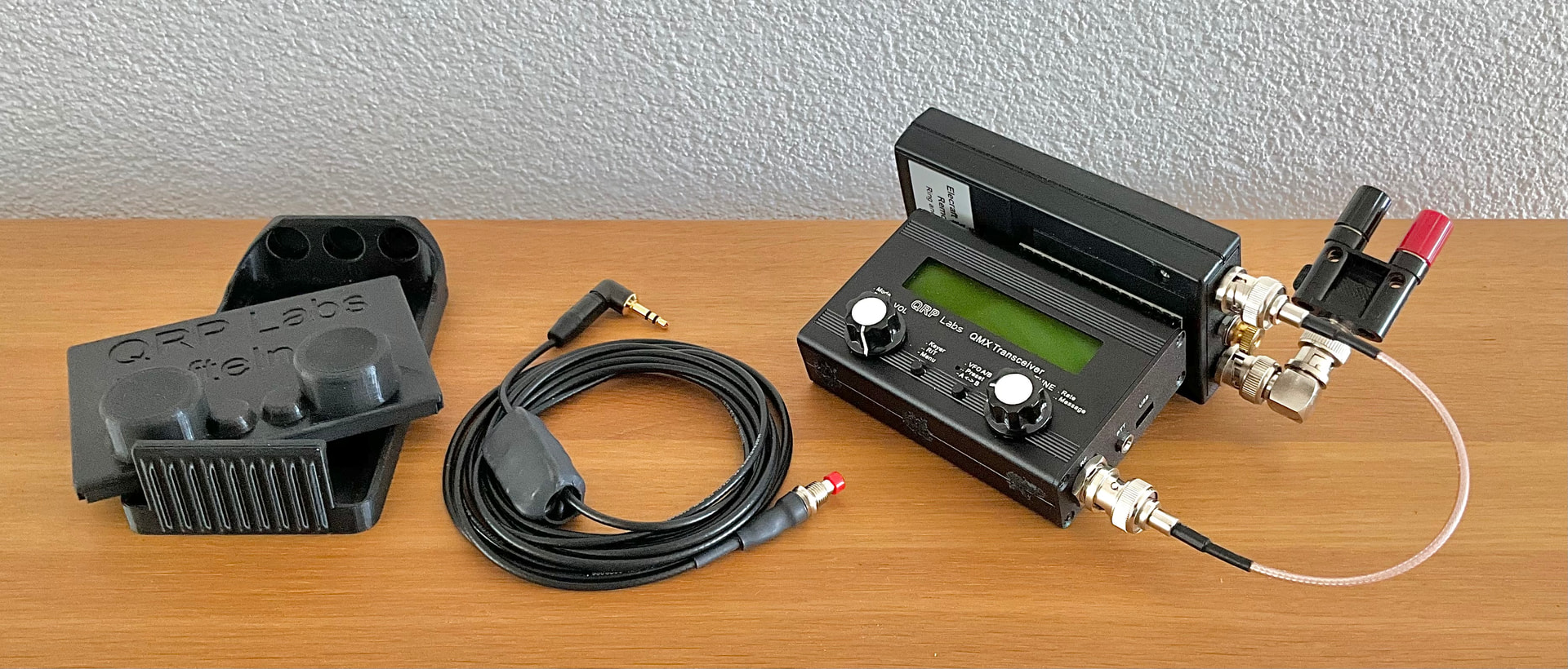

As featured here by Alfonso @EA4R

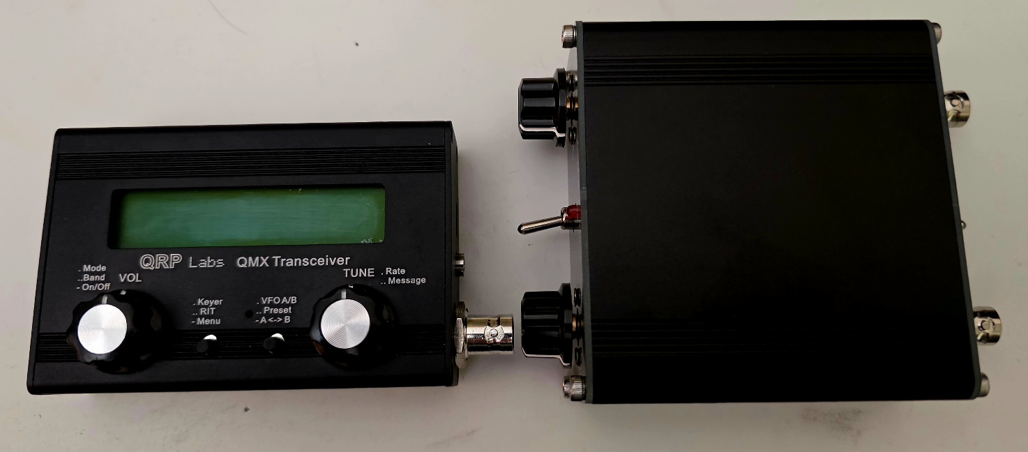

Alistair has arrived on time. He is actually a fairly well-matched size for the QMX.
He sits really nicely under the QMX as well. Also, due to the case having grooves in it, the QMX won’t budge sideways if you lay it sideways across the top of the tuner.
I like.

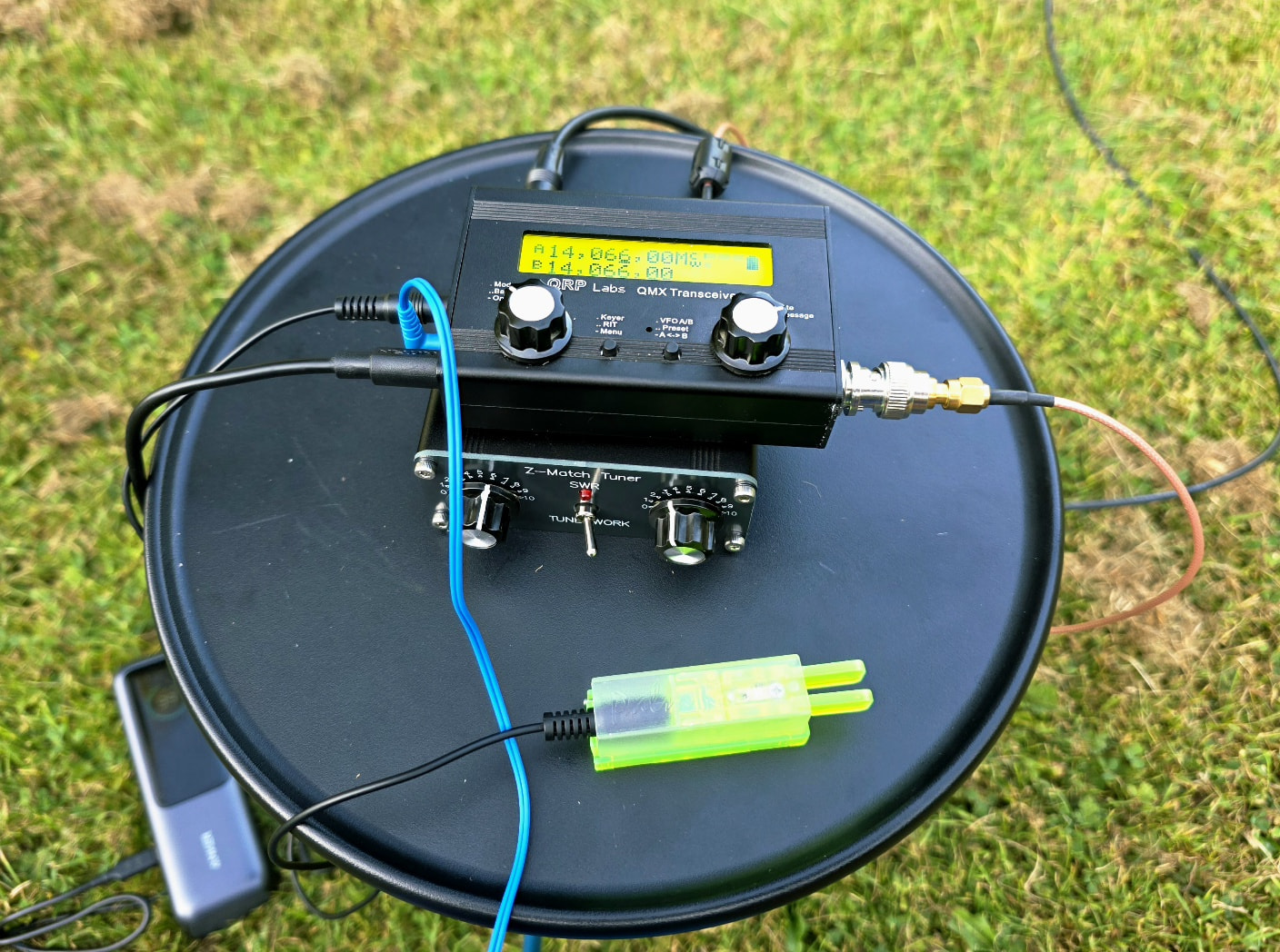

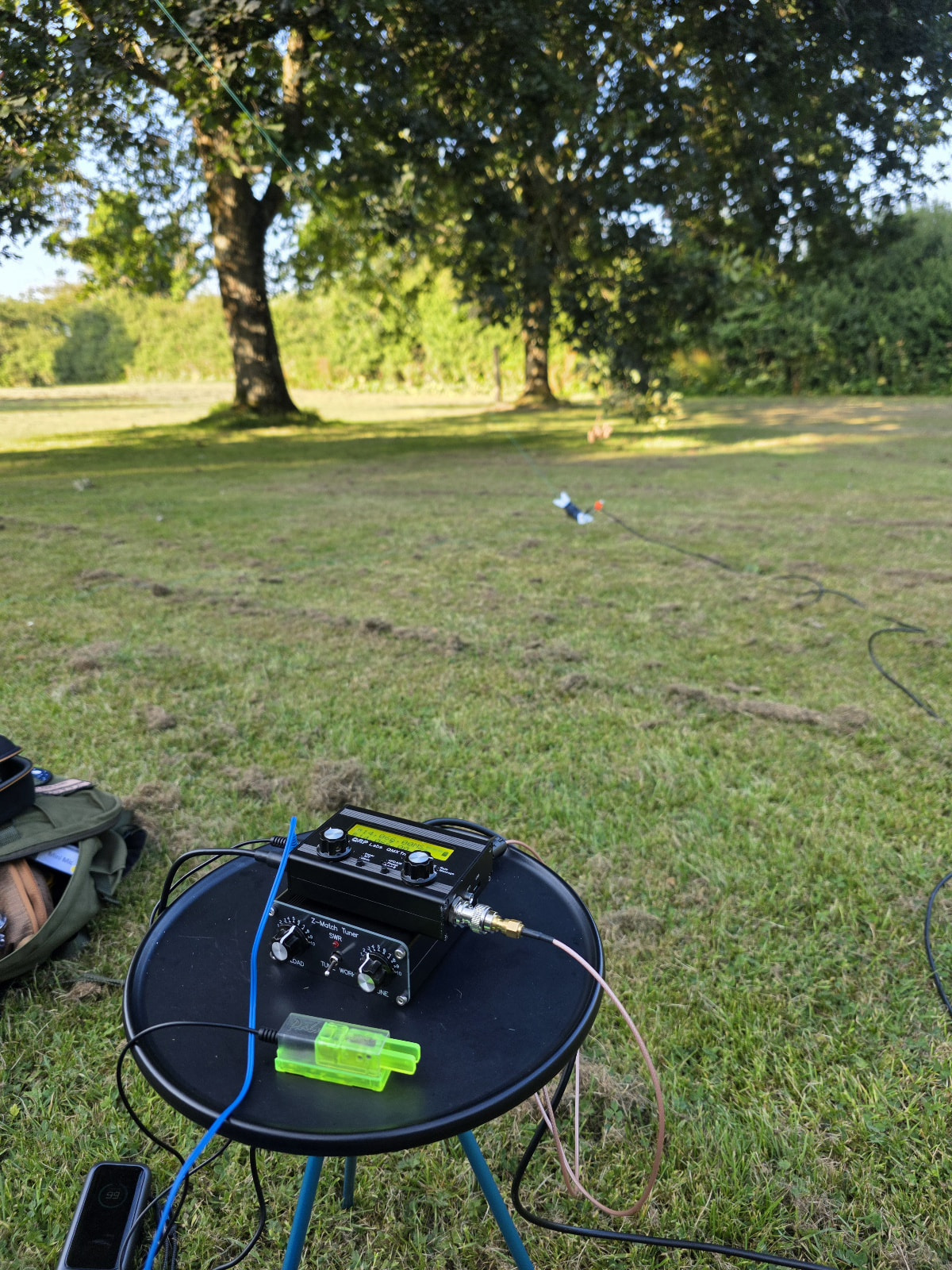

So i took Alistair out for a spin tonight. No time for an activation even though I called CQ POTA.
Literally had time to throw a wossname up in the doodah, then I popped over for a quick fiddle with the QMX and Alistair. He works. Great. Then i went home.
He performed amicably. Tuned an EFRW to 20m in about minus 9 seconds. Called CQ POTA about 97 times and got some reasonable results for 5 Watts and pants band conditions.
My QMX settings were all over the place and I hadn’t time to set them all up. This was a case of call CQ and if someone replies, great.
Alistair doesn’t like to extinguish his bulb fully, but he does try his best. I like him. He’s a cheeky, affordable chap that tunes antennas like the promiscuous young scamp he is!
I will take him out for a proper activation soon. Good job Alistair. :smiling_face:

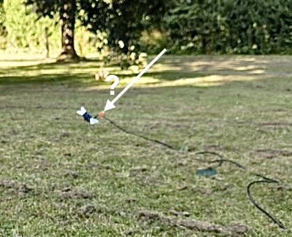

Unfortunately, this photo is too blurry to see if there are any radials lying around, or if this function is taken over by the outer surface of the coaxial cable’s shielding braid, and whether there’s a current balun looped inside the coaxial cable somewhere to limit the length of this (also radiating) radial … sorry for this somewhat dramatic wording; it was written with a lot of effort especially for you. So, I hope you enjoy it. :smiling_face_with_sunglasses:
Haha! Appreciated! :blush:
So the EFRW is by Radio Stuff and does have a counterpoise. I had that laid out and also put a choke in line and without, just to see what difference it may make.
The antenna slipped a bit and hit the ground which wasn’t ideal but you may see from RBN today I had very little time to do extensive testing. It was just a case of get the antenna in the tree, fire up the QMX, tune and go.
