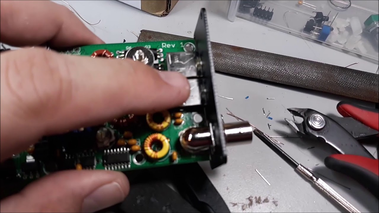

Just finished the mainboard today. Very low tolerances! (As I like it, customization of standard components included) When you solder with your kids, RTFM first!
To reposition the plug sockets is an ugly job. Make only one or two solder joints and check if the sockets fit the compartment.
gl 73 maritn
Nice tip for aligning the jacks here:
   73 Matt
