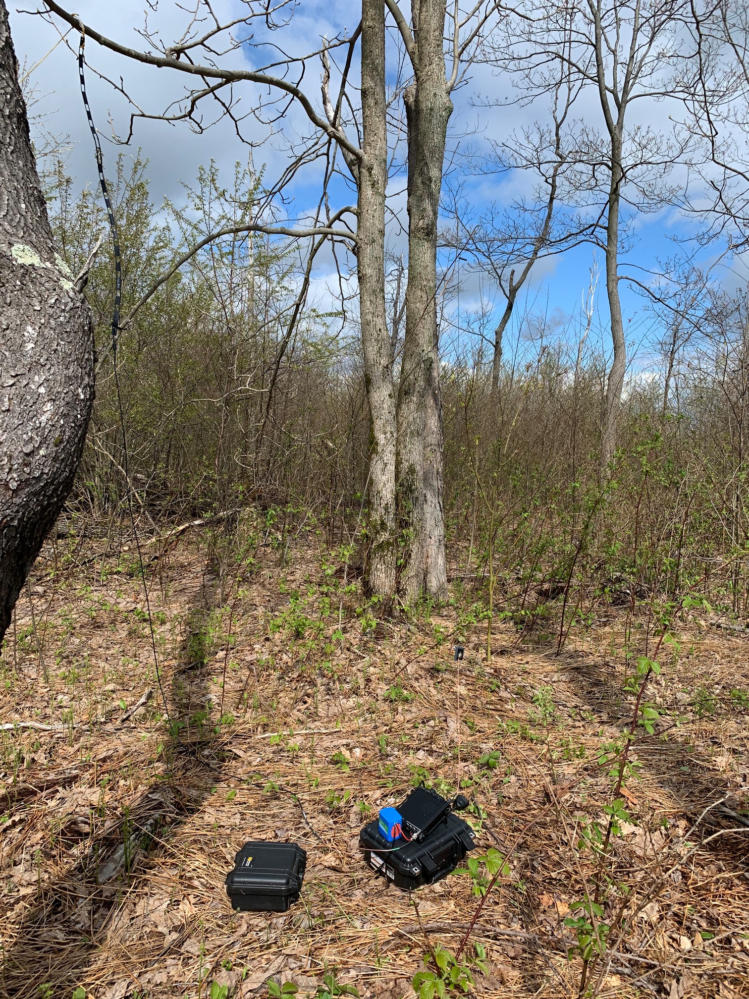

Today I activated two spots in Central Pennsylvania one successfully and the other not so much (points wise). I used my usual FT818, handheld Yagi and Rollup Jpole. The first summit is in a desolate area and I knew it would be a tough VHF summit. I activated it’s neighbor peak previously and it took me a couple hours!
Schaefer Head PA
From the 1st peak today, I called for over an hour with no reply on 2m/6m/70cm I was starting to tear everything down and…A flurry of activity! I heard another SOTA activator and his chasers 5/9 signals from most of them. I quickly reassembled my Yagi and pointed it his way (95 miles later determined) Calling back several times to his CQs he was unable to detect me. I did pick up a stray QSO from this activity.
