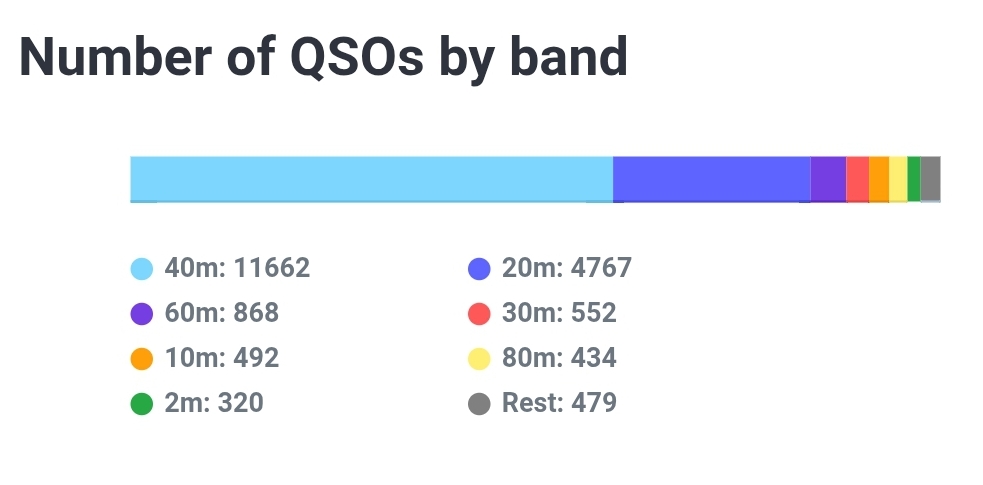

Jan, I can certainly confirm that—and my statistics back it up—even though I have greatly neglected the 80-meter band in recent years.
The “Rest” of the activity was on 630m, 6m und 23cm.
