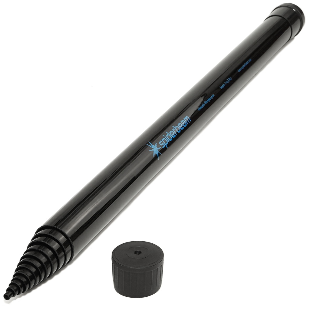

You should also check the Fiberglas poles from spiderbeam:
