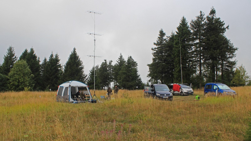

I also use these pegs to secure the OP’s tent of our non-SOTA VHF contest station. No drilling needed anymore although the ground isn’t easy, nothing but rubble below the ca. two inches of sand on the surface.
