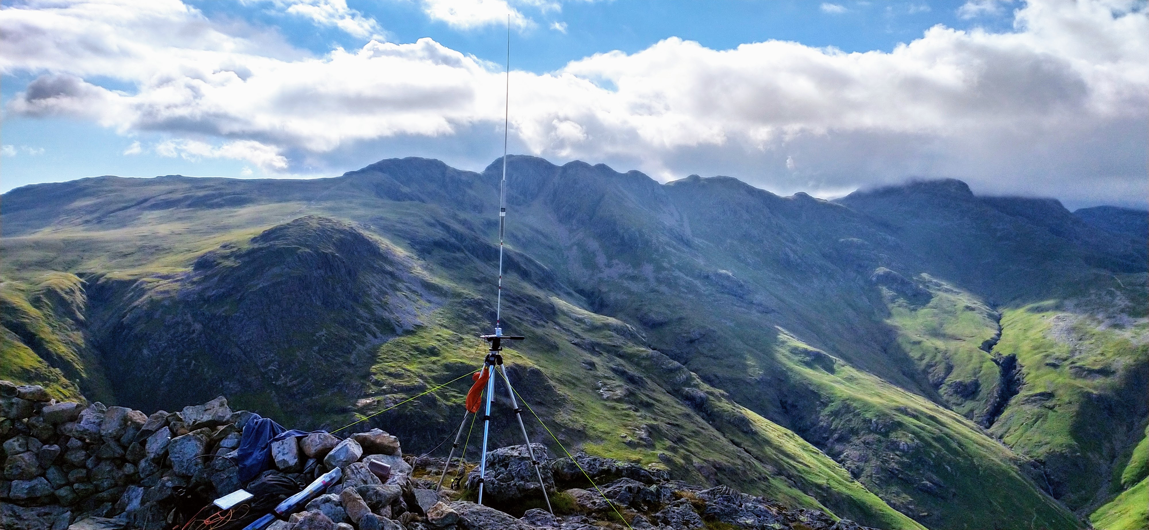

The arrow antenna worked well for the 2M activation FM vertical, and included C4FM contacts with Geoff @GM4WHA and Andy @G8CPZ.
Arrow Alaskan Antenna, 2m elements only vertical

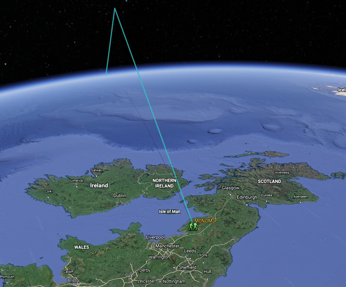

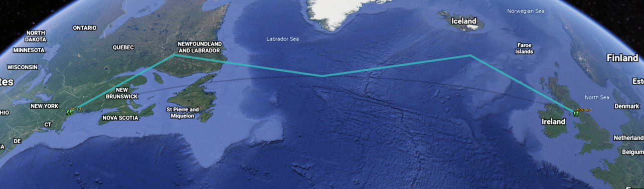

I noticed AC1Z/P was on 17m and tuned the Super Antenna MP1 manually with the SWR indication on the FT-817 as I’d forgotten the chart. I could just hear him calling CQ, then lost him during his activation. As 17m was clearly working I spotted myself, and amazingly after calling CQ a few times and getting nothing @AC1Z Bob moved to my frequency and with headphones in I was able to work him, copying signal report and summit reference W1/NL-022 correctly. It’s been a while since I’ve had a transatlantic S2S, so this was a special contact for me.
M0NOM/P G/LD-024 Summit to Summit AC1Z/P W1/NL-022 17 metres CW

Radio kit included a Manfrotto Tripod for the Arrow Alaskan 4 element 2m (and 10 element 70cm) antenna with a guying kit, FT1XD handheld with RH7700 telescopic whip, Super Antenna MP1 with 20/30/40m counterpoise and no loading coils and FT-817 with 3 cell LifePo4 battery. For RAYNET I also take a LifeSystems thermal blanket and Bothy Bag, I also had a waterproof tarpaulin which I didn’t use.
