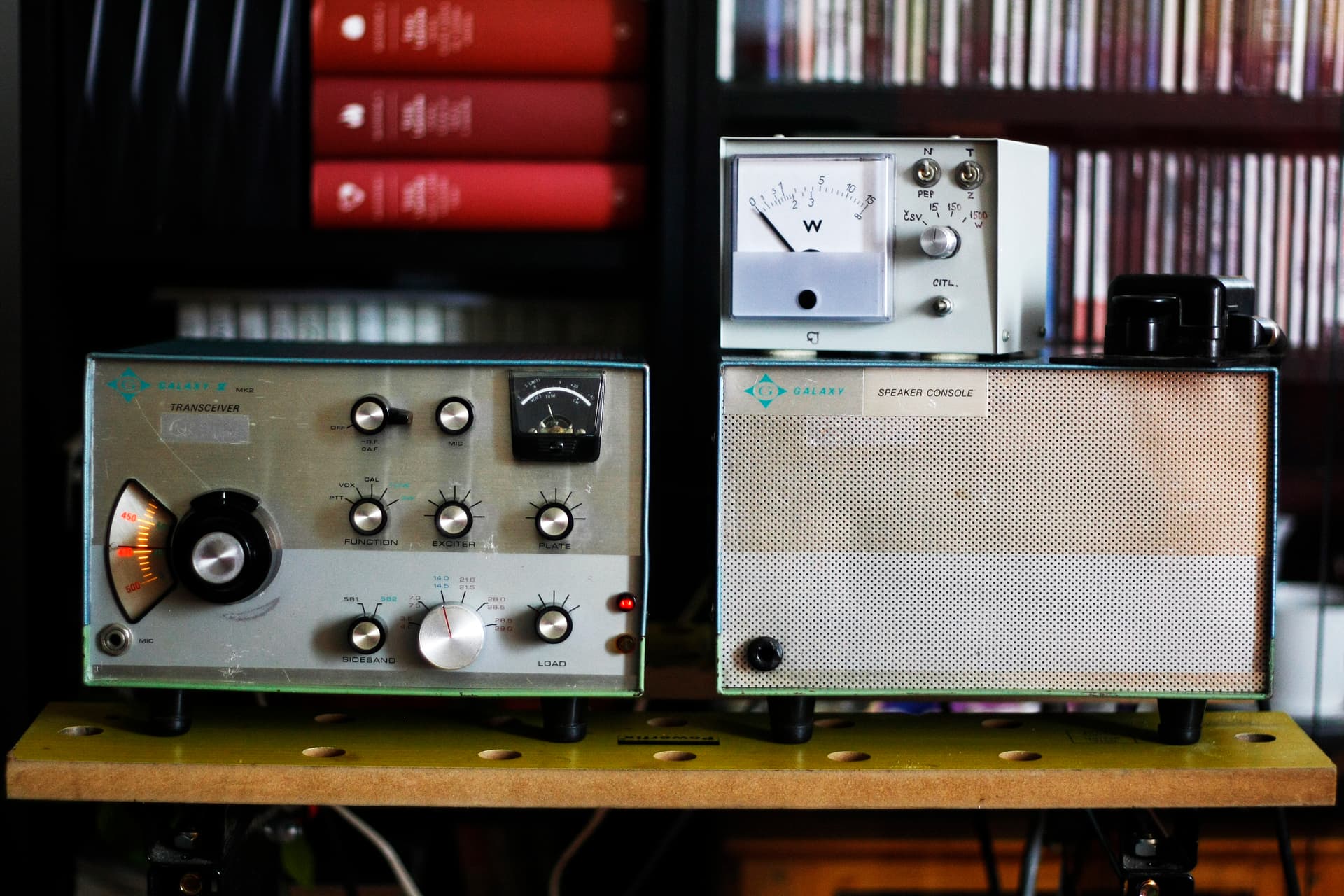

Old fashioned chasing
It’s sometimes said as a joke, but good wines definitely improve with age and, strangely enough, it seems to me that the same is true of both wine and old sophisticatedly designed tube rigs. The older I get the more I like to revitalize and to operate them - it definitely has a different flavor! And I recalled this feeling again during my QSO with Bruno, HB9CBR/P, on HB/SO-010.

Ah, yes. Peak the exciter, dip the plate. Replace an electrolytic. Repeat.

Looking good Karel. But how long does it take to change bands? I like to use my old stuff but it’s a chore changing bands 10 or more times a day!
And Mine is a separate transmitter/receiver.
John, K6YK
Taking band changes to the extreme, I have a trio of rare Hallicrafters SR-75 transceivers, which are S-38B with one added tube, good for ten watts. Chrystals needed. Only one of the three still has a back. Here’s why - to change bands, you have to unscrew and remove the back, short the B+ to discharge the big capacitor, snake a hand through hot tubes to reach and extract the specially designed plug-in tank coil, do the same to install another one, and re-fasten the back, which is supposed to have a safety connector for the AC line. The two backless ones have the safety defeated. None is polarized, so you have a 50% chance of a hot chassis, including the set screws in the front panel knobs.
Elliott, K6EL
yes, the good old days :grinning:

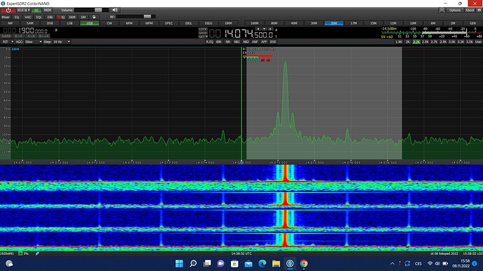

It was a very nice challenge for me to lick Galaxy’s transmitted signal into shape in terms of today’s standards. The signal is stable, chirp-free with smooth transitions and clean spectrum up to -60 dBc. Not bad for an old tube rig (1968). Weak (-80 dBc, that is, a hundred million times weaker than the carrier!) spurious signals at ±800 Hz offset are caused by the AF CW monitor. Unwanted signals (a very acceptable value of - 60 dBc) at ±100 Hz offset are dictated by the residual ripple of HT power supply. RF harmonics suppression also meets FCC requirements.
73 Karel
