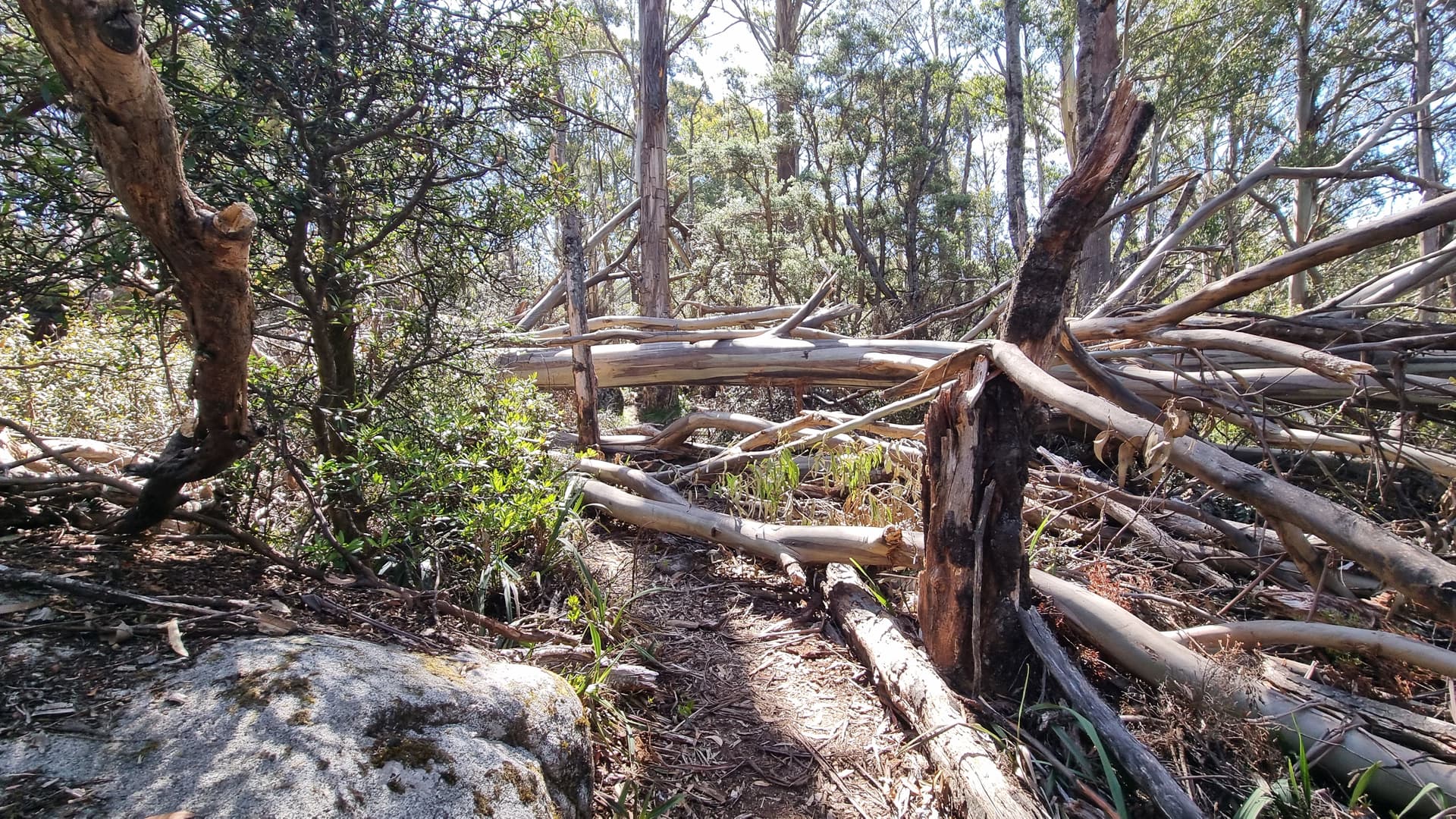

I left the car at about 7:50 AM and arrived at the summit at 10:25 AM. The track up is a narrow path through a mixture of trees including Mountain Ash, Silver Wattle, and Snowgums. A bit of limbo gymnastics was required on a couple of occasions.

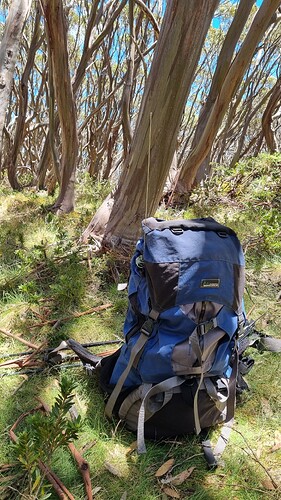

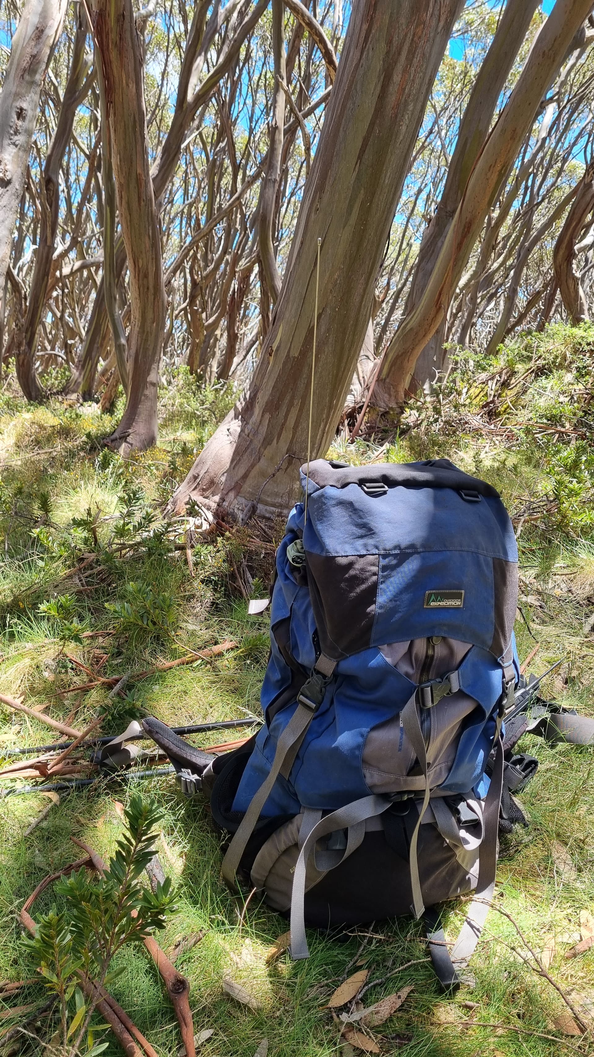

Upon arrival I set up my inverted L antenna with my 6m pole leaning in a tree near the trig point and connected up my FT817ND.

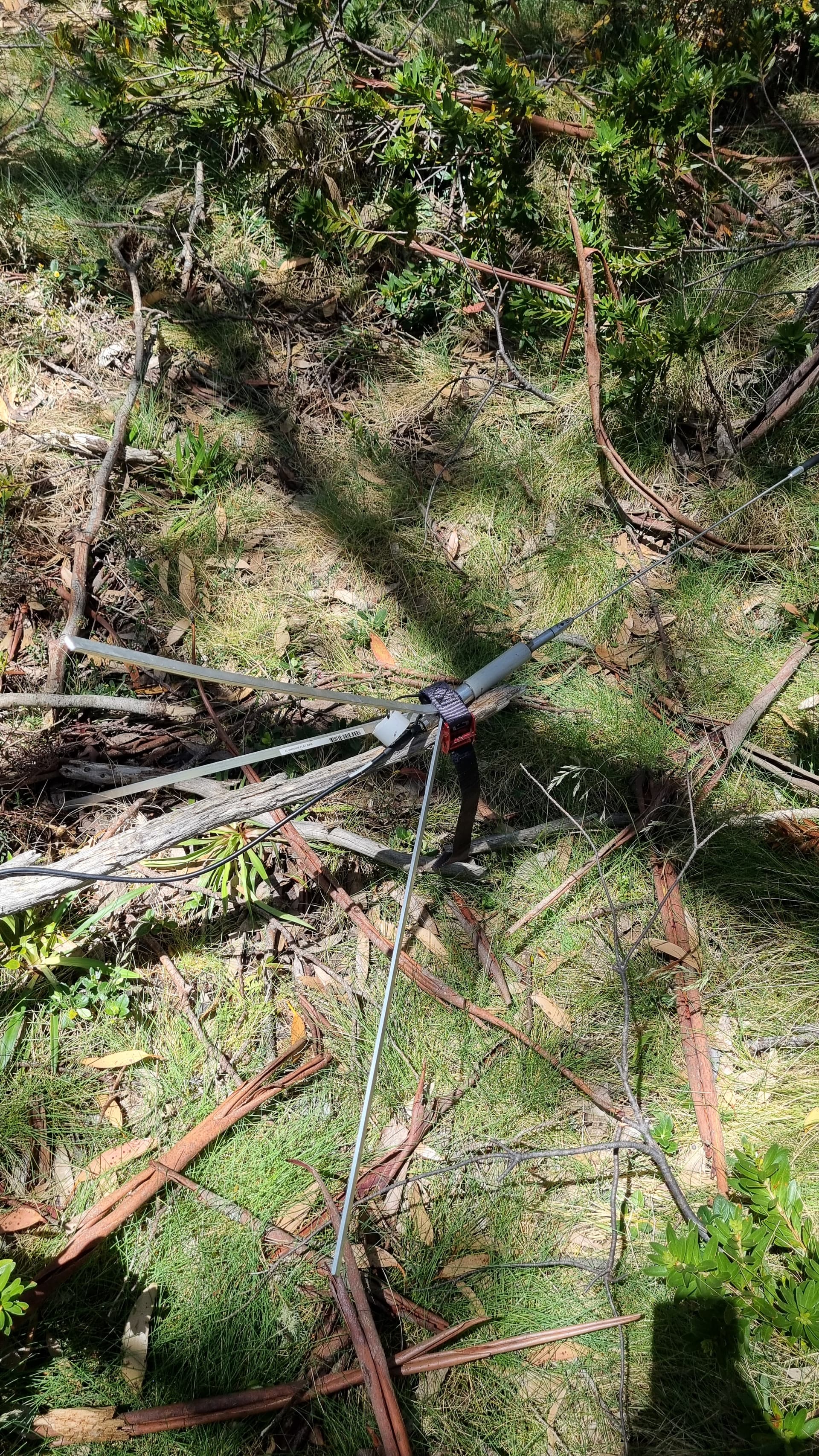

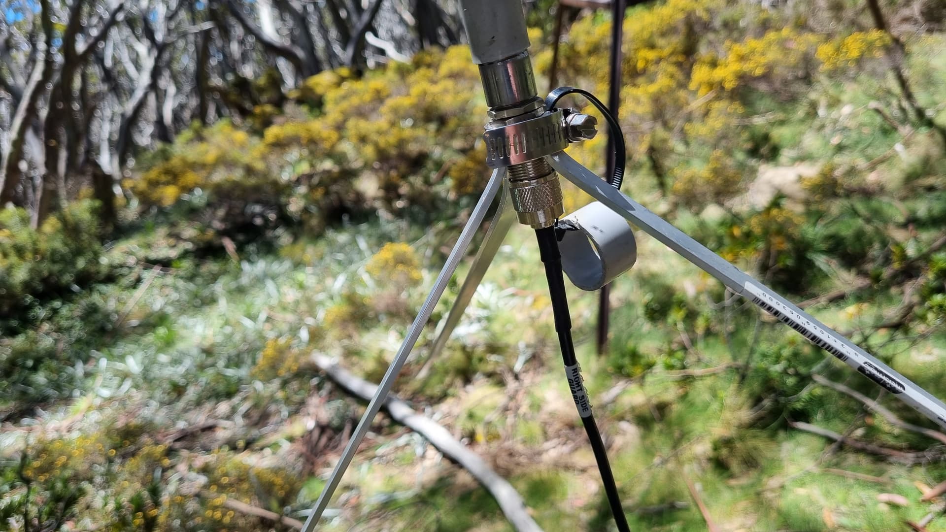

After qualifying the summit for 2026, I packed away the Inverted L and set up a 2m/7cm droopy ground plane antenna. The antenna was made with a Diamond dual band antenna, that normally resides on my car, three lengths of 10 x 3 mm strip aluminum, an SO-239 joiner and a stainless-steel hose clamp. All this was strapped to a fallen branch, that was then strapped to the trig point.
