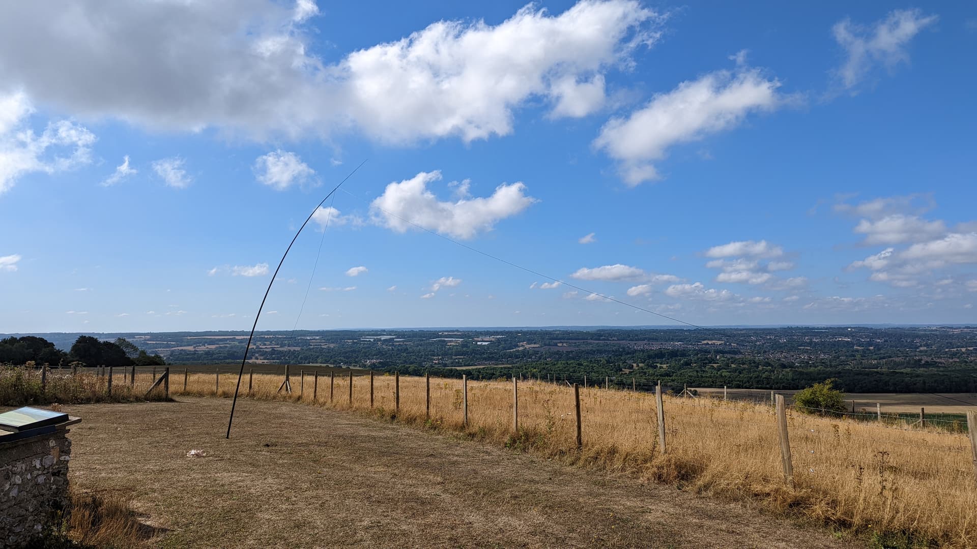

Next thing I had to do was set everything up. I had the Yaesu FT-891 and FC-50 ATU (more about that later) and my Yaesu FT3DE handheld beaconing on APRS which was reliably heard by my own digipeater MB7UQI. The antenna I set up was a simple wire going up a pole and sloping down with a 9:1 unun. Not sure how long the wire was, but it seemed to work fine for 60m, 40m, 20m and 15m. As I hinted at, there was more to mention with the tuner. Somehow the middle pin of the tuner cable had bent and wouldn’t work. I had to do the entire SOTA activation with no ATU, which was fine as luckily the SWR was reasonable. When set up, it looked something like this:
It’s a bit hard to see in the photo, but there’s the wire sloping from the pole and a 10m counterpoise wire on the grass.
